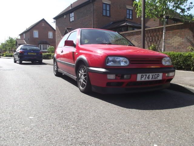

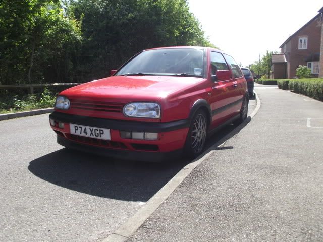

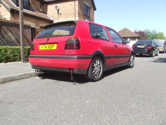

just a few pics of how it stands at the moment
Ignore the missing tow cover lol
The paint looks faided but its not lol
Only things i have done scince sorting the mot are
-Flat blades
-Painted boot badge black
-Re-fitted all the interior and the standerd drivers seat
-Drilled the air box
now i just want to tidy up, repair the bumper scuff and just sort the rust spots etc

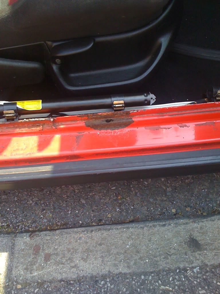

This is how the sill started, it has been welded up by the previous owner and was a sh!t job and had faild

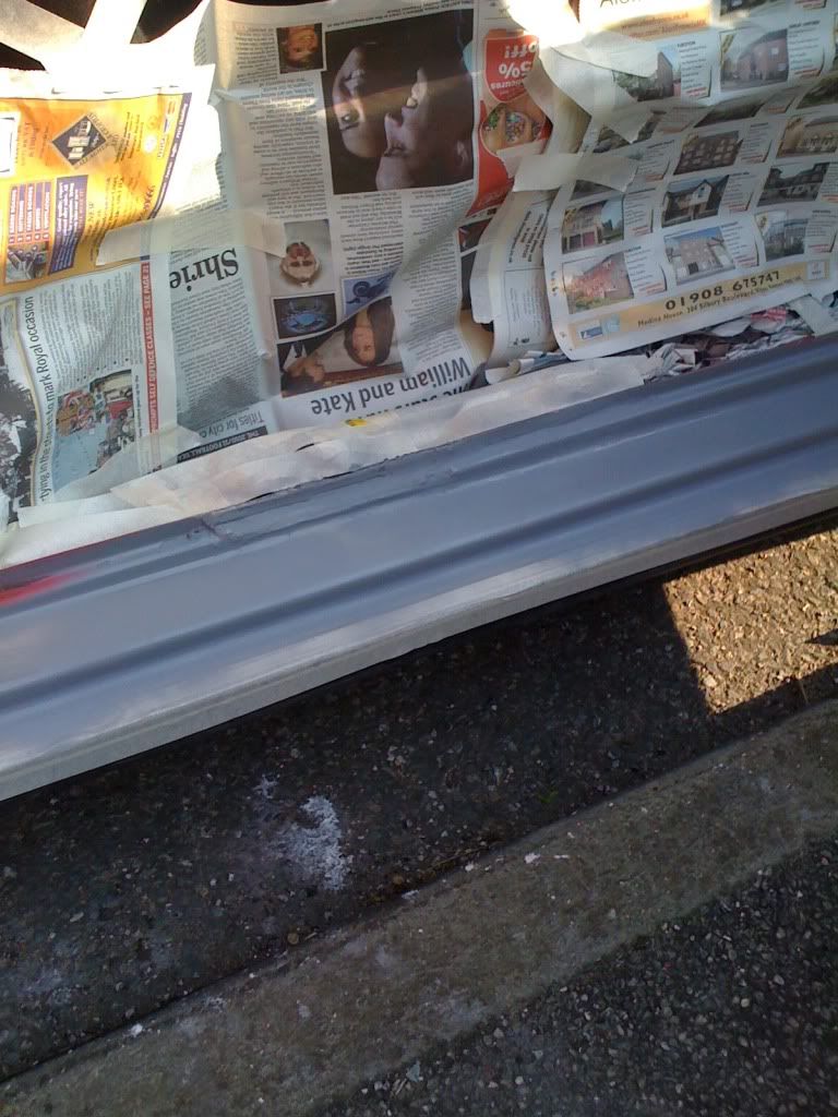

After some filler and sanding it came out like this

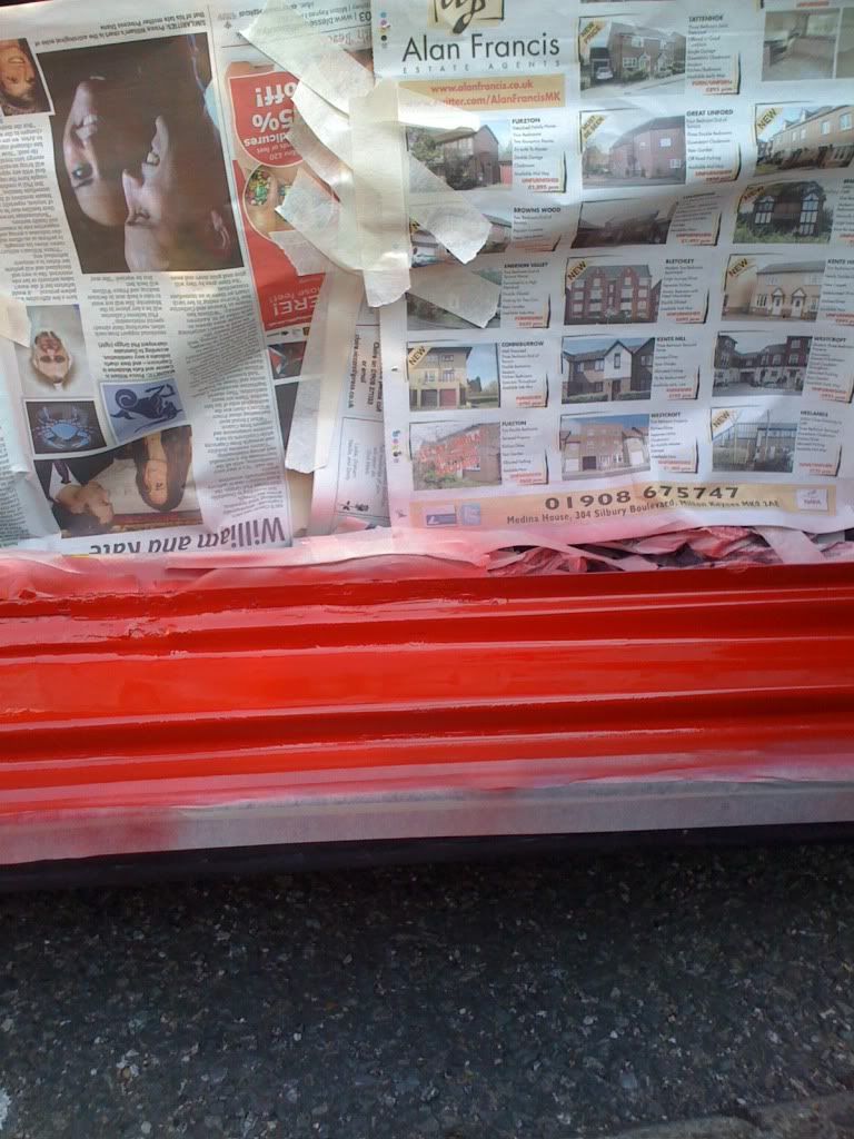

And after a lick of paint :-)

Looks an ok job but i'd guess the rust will be back pretty quickly. I'm assuming you got the grinder out & took it back to bare metal before any filling? The only sure fire way to get rid of rust is to chop it out & weld in new metal in it's place, but as a temp fix yours looks fine :smiley:
Also try using thinner coats of paint next time :wink:
