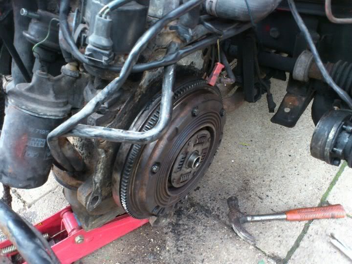

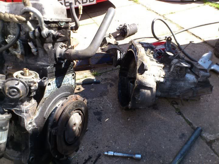

so to cut a long story short i was home to grimsby from louth 3 maybe 4 weeks after fixing the last problem and my clutch went slipping like mad with no adjustment left on the cable to a limped my car home the 18 miles that were ahead of me. luckily for me though a good freind martin had a spare clutch i could have so he donated it to me with a spare gearbox he had wich would then put my engine back on the box it should have in it so we set to work getting it sorted....
so here goes with some pictures ... starting with the donated clutch and gearbox removed from martins old engine...

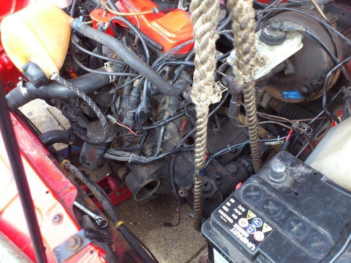

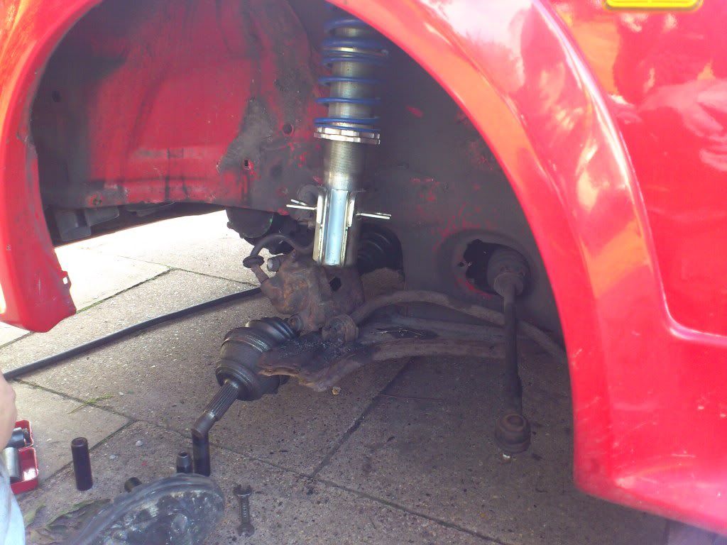

then the driveshafts disconected and suspention half removed for later bumpstop adjustments
and gearbox supported ready for final removal
and the gearbox is out and new clutch assembly fitted :)

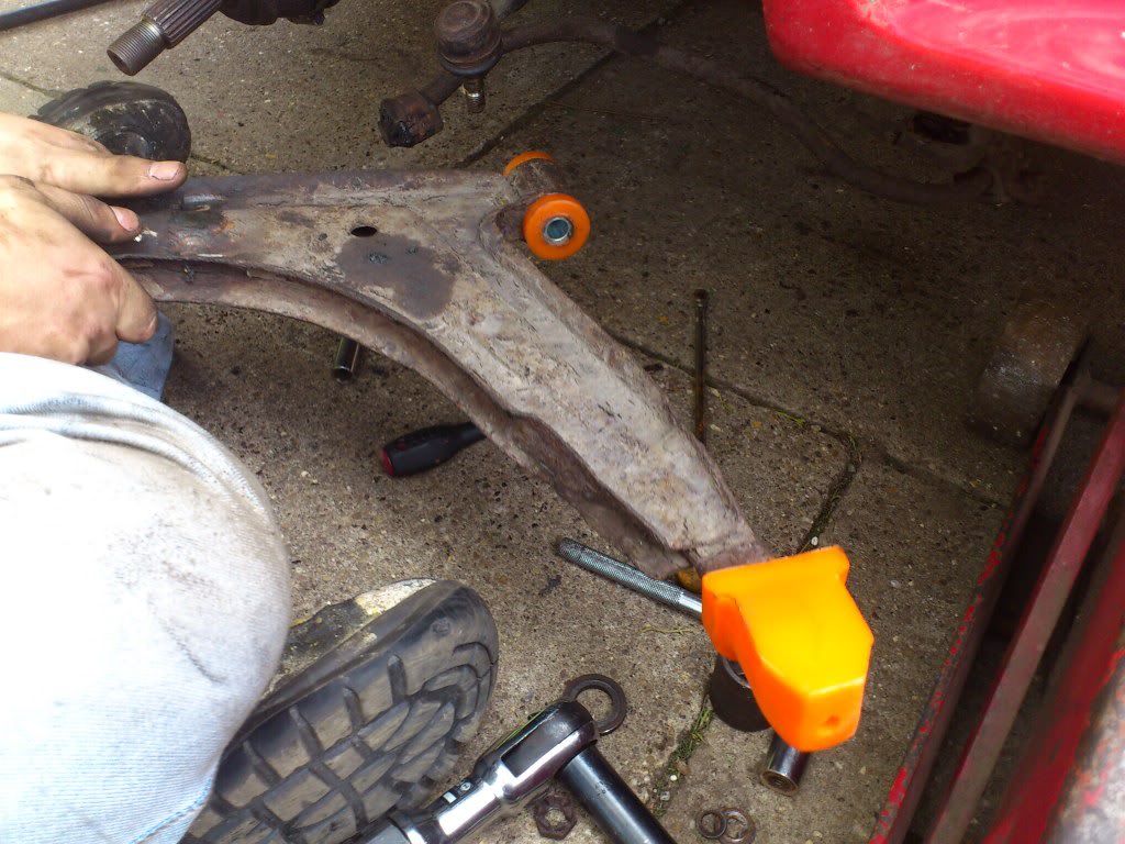

then after getting the new box in and set up we then had to tackle my completely shot bushes and i dint see any point in replacing with sh!tty standard bushes so i baught myself a full set of pollybushes and set to fitting them..

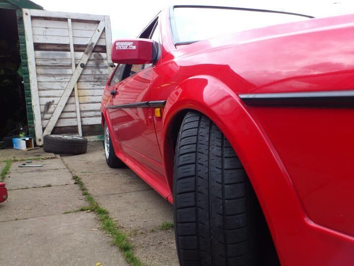

then a picture of the massive arch gap i have after lowering another 20mm and putting my wheels back on ...
and another lowered pic cuz i like it :)
