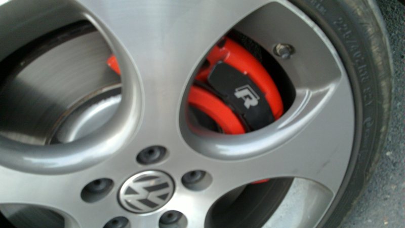

Next job was to install the r32 brakes, makes a massive difference, would recommend these to anyone.

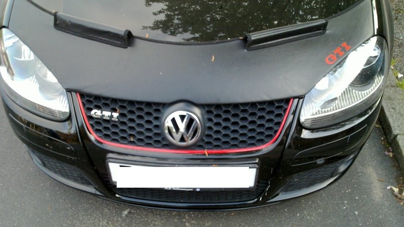

Then got a bonnet bra from America, but still not sure on it.

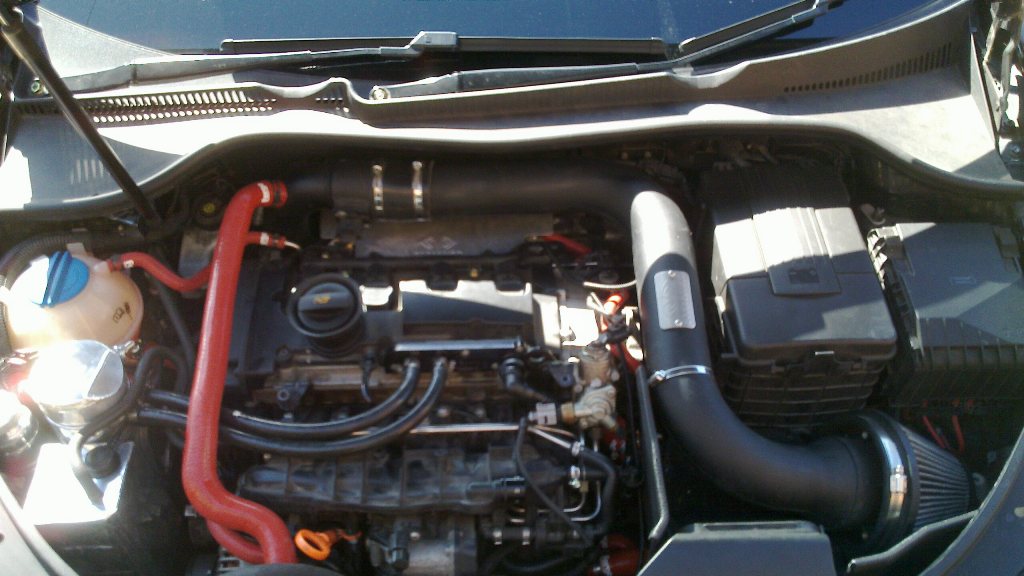

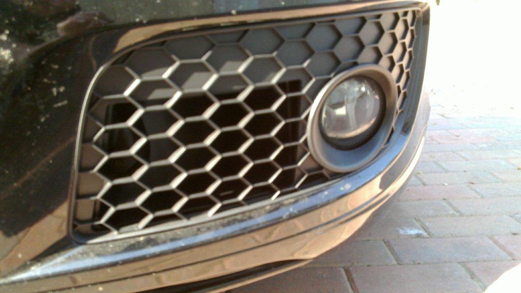

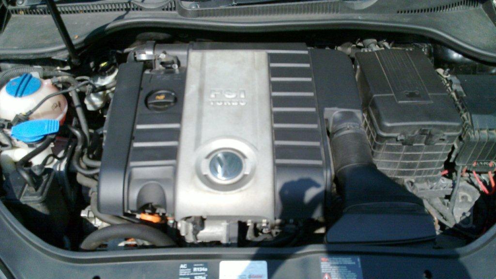

I set my self a small goal today,  install Evoms intake/ heat shield & Open air intakes

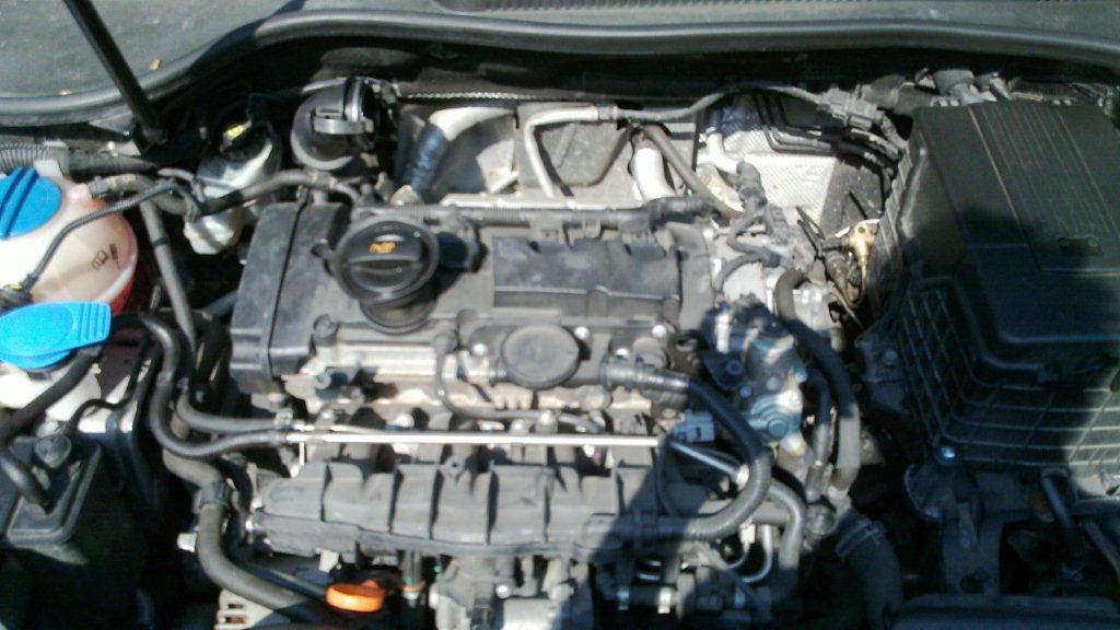

The day started with a normal looking engine.
I then went about stripping the engine ready for the intake install.

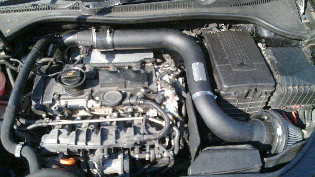

Intake installed with heat shield.
Took it for a test drive and the sound was metal, so was very happy :D.  Run vag-com, no faults so all ways good!
I then went about changing my vents for open air vents.
Should help with the heat soak!!

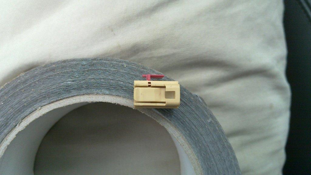

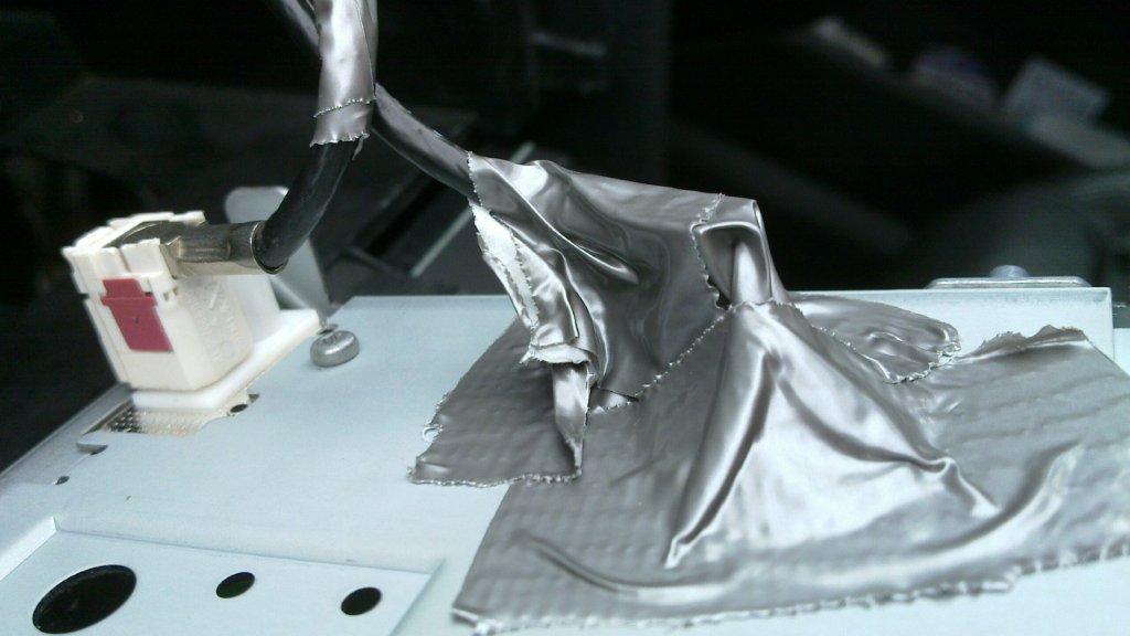

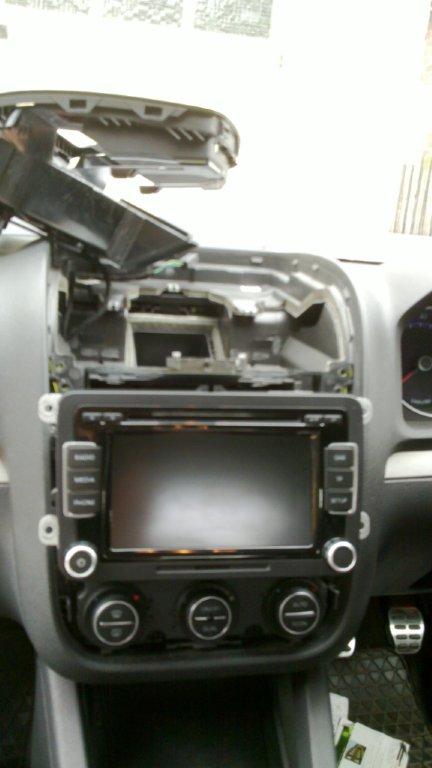

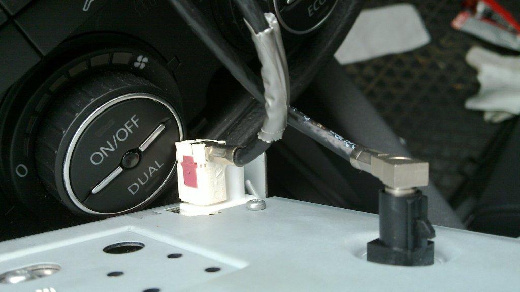

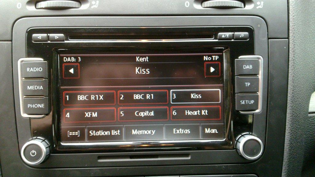

Fitted my RCD510 With DAB today!
Removed my old RCD310, and started to test the RCD510
Noticed I could not pick up any DAB radio stations and the connections where not the same on the back.
Had a look online and found I need a different aerial and connections.
I modified my old connections by removing the casing off them.
I then stuck some tape on the back of the connections to make sure they don’t come out.(Temp solution)
Tested and worked fine, but going to get the correct aerial so I can pick up more stations.

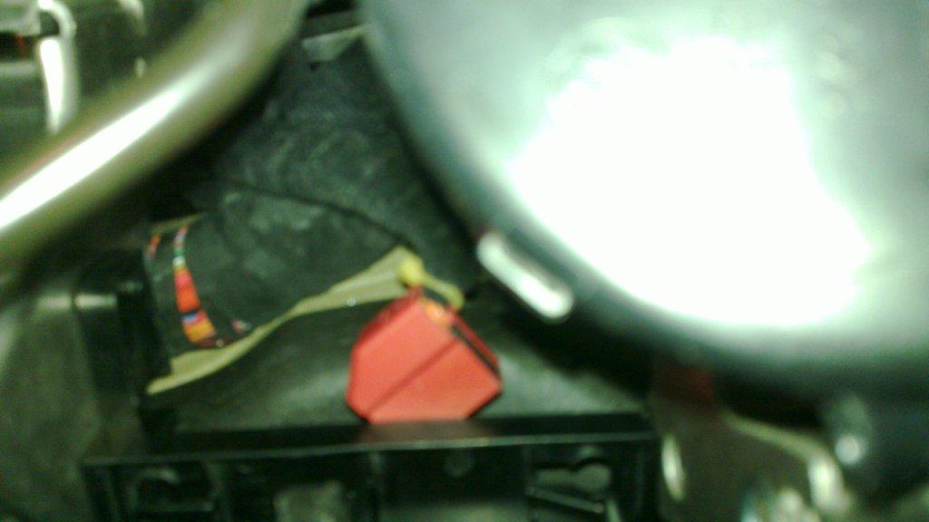

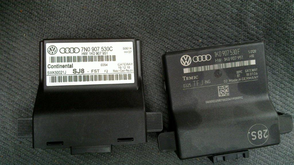

Well today was not fun!!  I had to change my CANBUS due to battery drain from my RCD510!
I had a look on the internet and found where it was located, directly above the clutch pedal!!
I started by backing up my CANBUS install list via Vagcom ( the nice easy bit!!)
Will add pictures here : P
After smashing my hand up I got the bloody thing out (PIC new V old)
Location
Then reprogrammed the new CANBUS, and started the car.  Dash lit up like a Christmas tree, saying faults with anything. :(
Did a full scan removed all the faults and corrected my errors.
Took for a spin, and cleared last faults, car is now happy! :D

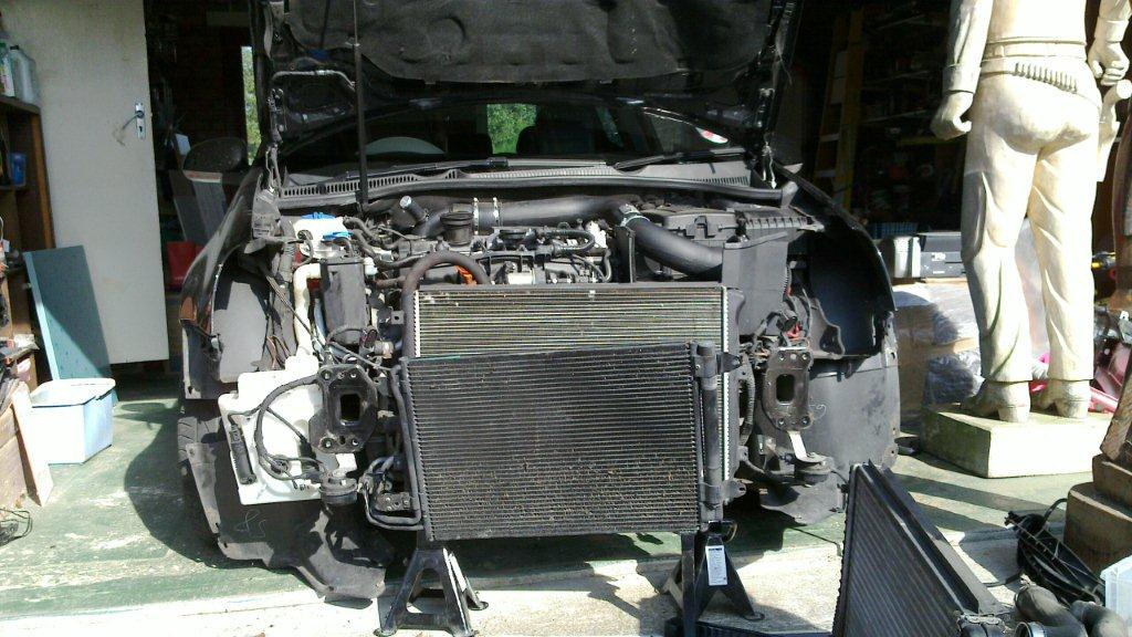

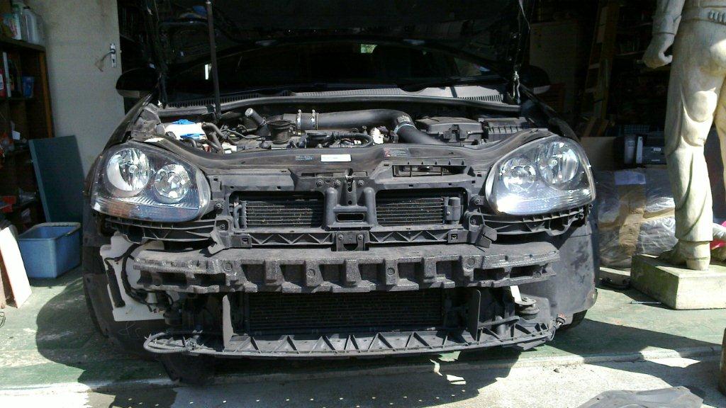

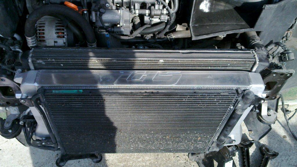

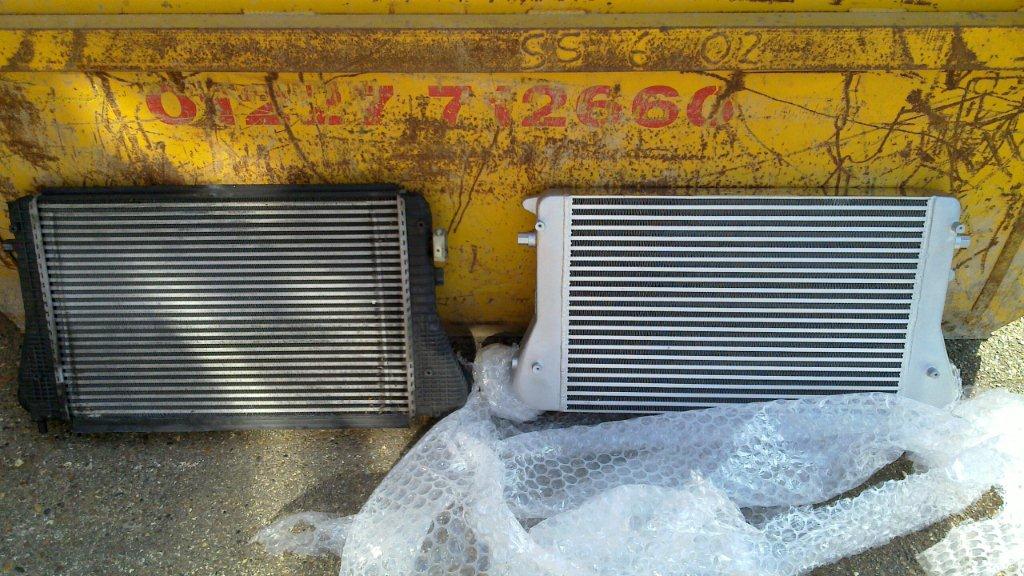

Well i had 4 hours spare in my life yesterday,  so I thought I would install my THS intercooler!
The day begun by me stripping a few bits off the car and also removing the bumper,

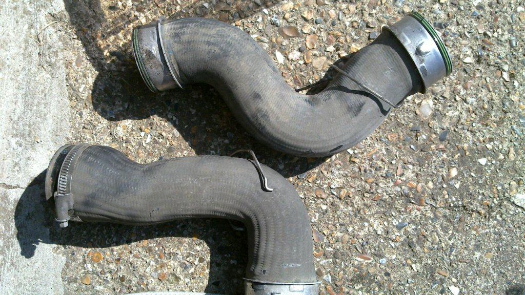

I then removed all the IC pipes and found myself a nice little boost leak in the process,  the stupid C clip and slipped off the connection and was sucking a small amount of crap off the road!!
( was so happy there where all going!)
Once all the pipes were removed, i had to remove the front panel!  This part was rather interesting. I had to balance all the rads with one hand while pulling away the front end!  Job done after a few magic tricks.

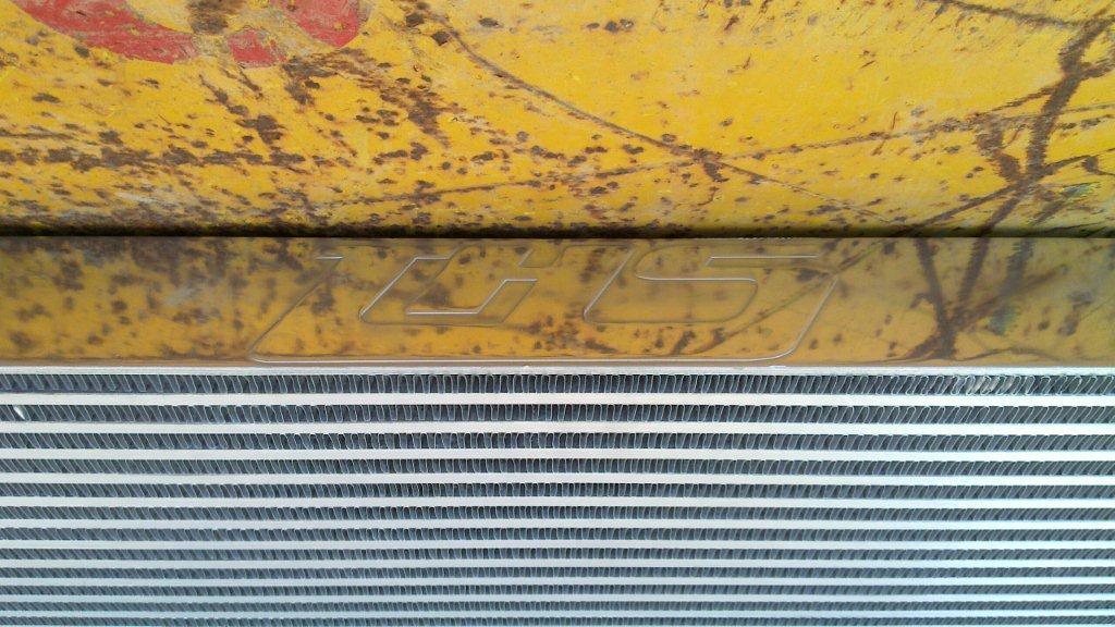

I supported the rads with some axel stands and went about removing the standard IC from the rad pack.
Then new V old!
Then i installed the new IC in place
Then put all the back together!!   Witch was the easy part :D
I took the car for a test drive and she now makes a few more air sounds and also I can trash the car all day long with no heat soak!!

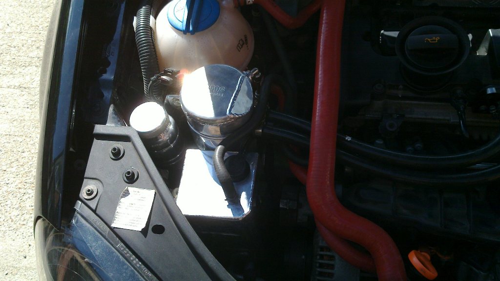

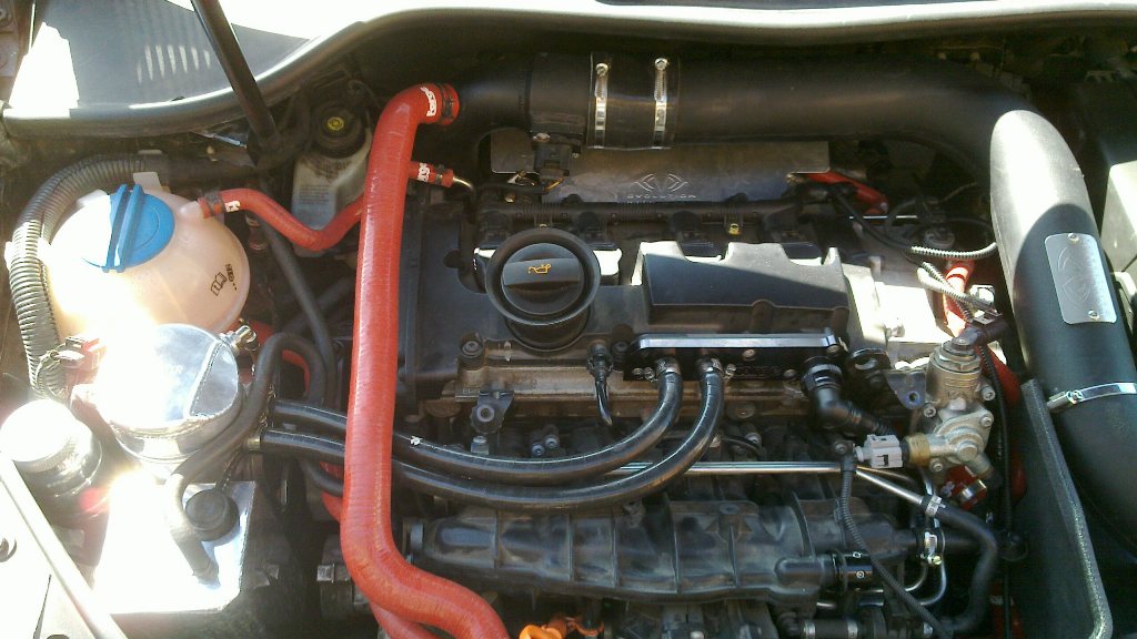

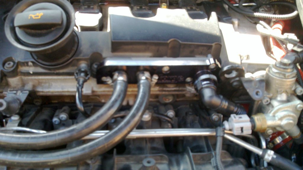

installed forge catch can, carbon filter cover and water filler pipe.

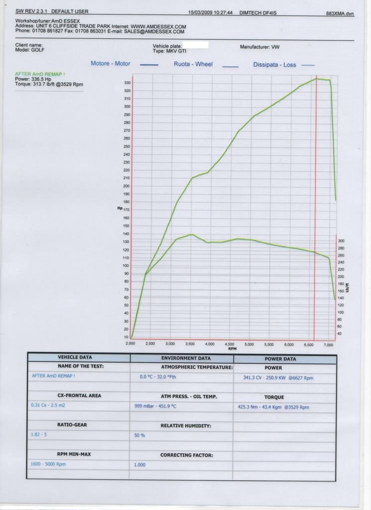

« Reply #9 on: 04 October 2011, 08:34 »
Well I have not updated this in awhile!!
I have not done allot with the car as I have had so many problems with my remap :angry: It has been back and forth to AMD that could not correct the problem .  The remap has been removed and I dropped the car off to r-tech! So fingers crossed she should be rock and roll!
I can then get back into modding the old girl again  :evil:
