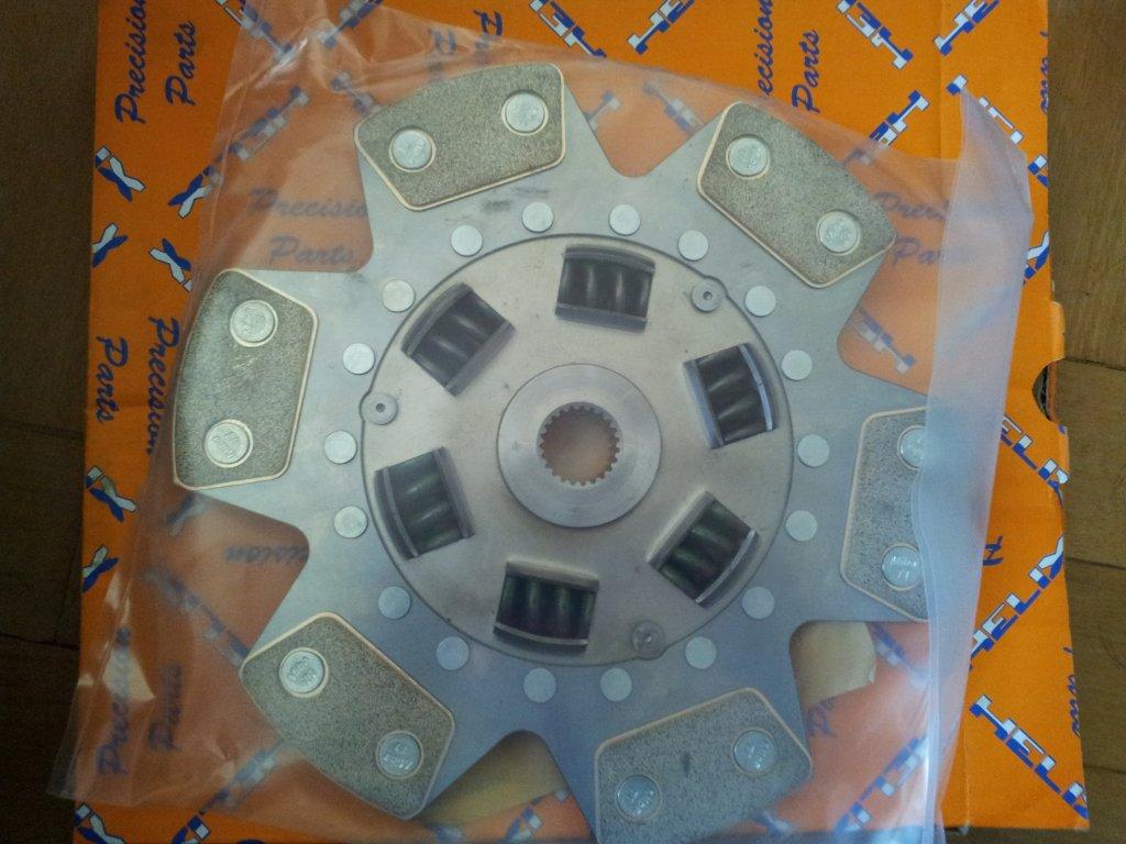

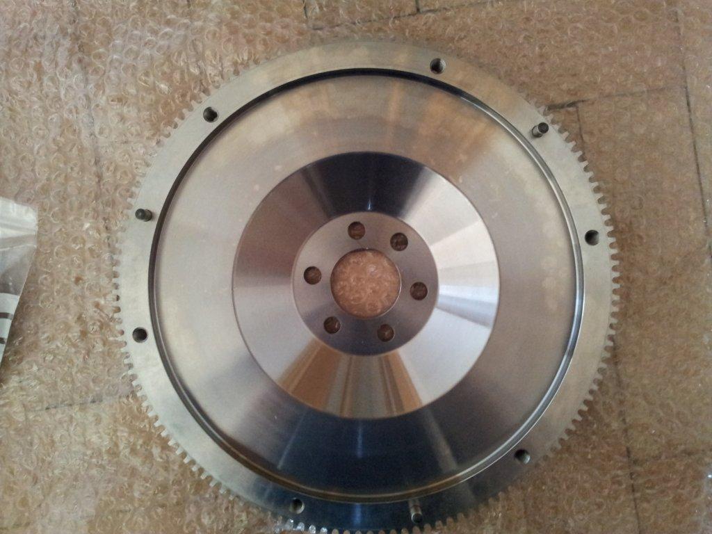

Well my new clutch and light fly wheel come today  ( Just need to wait for the LSD  :fighting:)

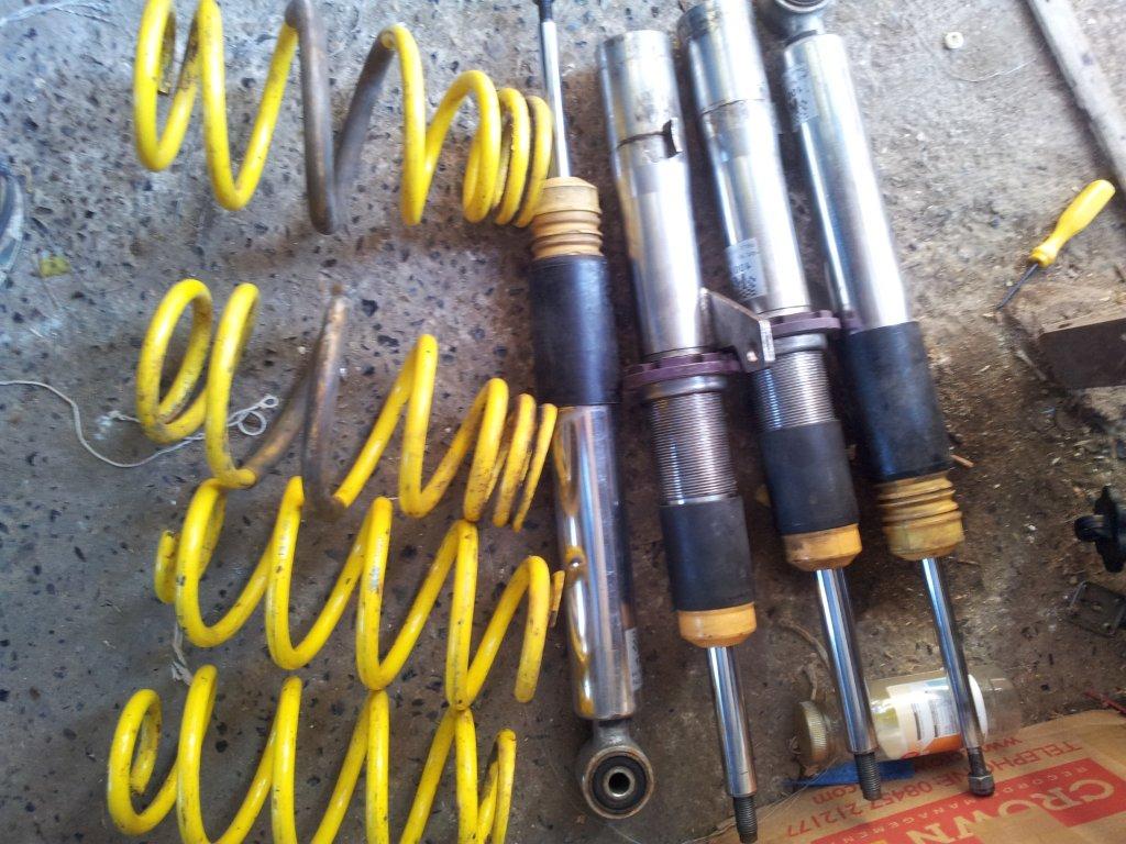

I also went and collected some cheap KW V3
Going to install  S3 rear brakes and Audi TT wishbones tomorrow as long as it don’t bloody rain!

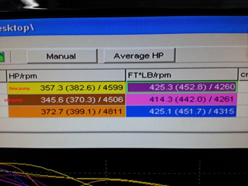

The next fun part was seeing what we could get out of the old girl!   The car was producing good power 380hp/400ftlb but the turbo was tailing off so much at the top end!  (like normal)  So went about adjusting the actuator on the turbo .  We found it nearly made 50hp on the stop end! but you lose it down low but that suites me.
The next problem was we were getting a dip at 5800rpm then it would pick back up at 6200. Logged the LPFP and it was dropping to 3.9bar :(   So I got the latest revision from TPS “1K0 919 051 DB” + new fuel filter it was then holding 4.2 bar  so it is better but will need an inline fuel pump!!
Also just a fyi  the car made an extra 12hp and 10bhp just buy installing a new fuel pump and filter!  (might be something to look into?)
