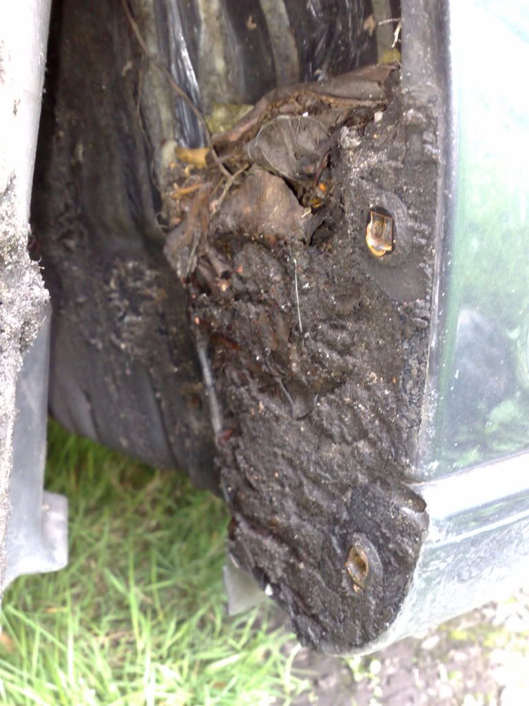

Just waxed my mk4 and realised there is a very slight patch of what appears to be surface rust on front wing. Its probably around 2cm long and comes above t he lip of the arch by about 1cm and is currently pretty faint (but apparent enough for me to spot)
Any idea what i should do with this? is it a fairly standard and cheap job to get a paint shop to touch it up or will they have to re=paint the whole arch?

Strip off the arch liner as it could be coming from behind where it clogs up with crud, gets wet and rusts.
To prep and paint a panel you are normally looking at £100+vat per panel, but these little mobile guys who specialise in scratches and dents might be a bit cheaper.

So realistically i am looking around £100? I might strip the wheel arch liner to have a clean and get some wax oil up there this weekend.

this is what you'll find

nice little rat nest in there mate :laugh:
