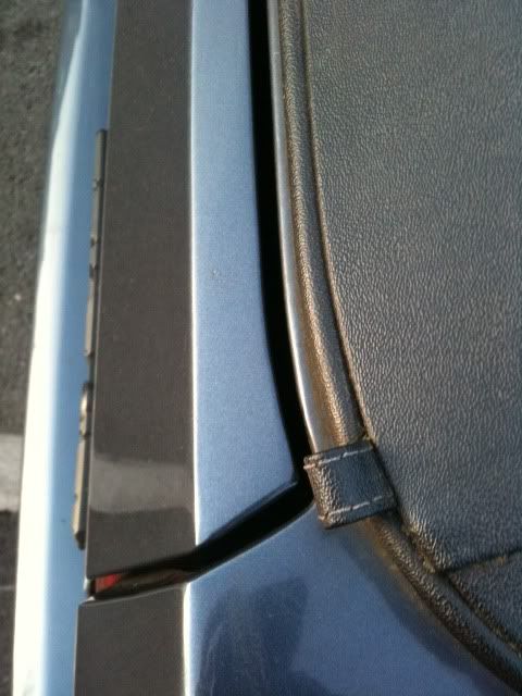

My boot is leaking  :cry: shouldnt there be a rubber around the boot lid, as the gap seems big.

Hi fella,
there should be a seal around the opening.
A typical issue is water ingress through the rear lights. The seals on these often go and is a common problem.
Check for any rips or tears in the hood area around the tonneau cover side trims.
Often there is a split here on older hoods.
Also check the tailgate lock seal is not split or missing.
Hope that helps a bit.

You should have a seal around the inside.  :smiley:

yeah you won't see it with the boot shut, you'll see it around the opening of the actual boot with the lid open if it's there.
