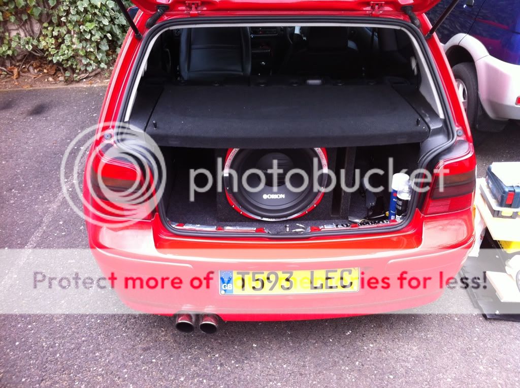

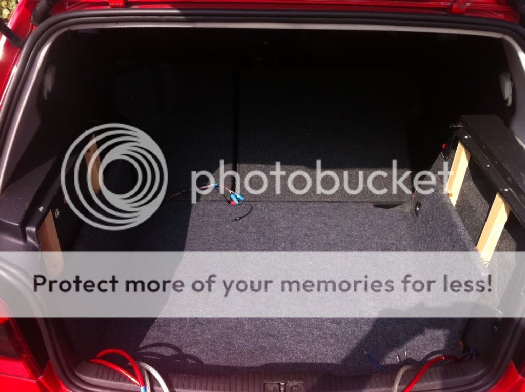

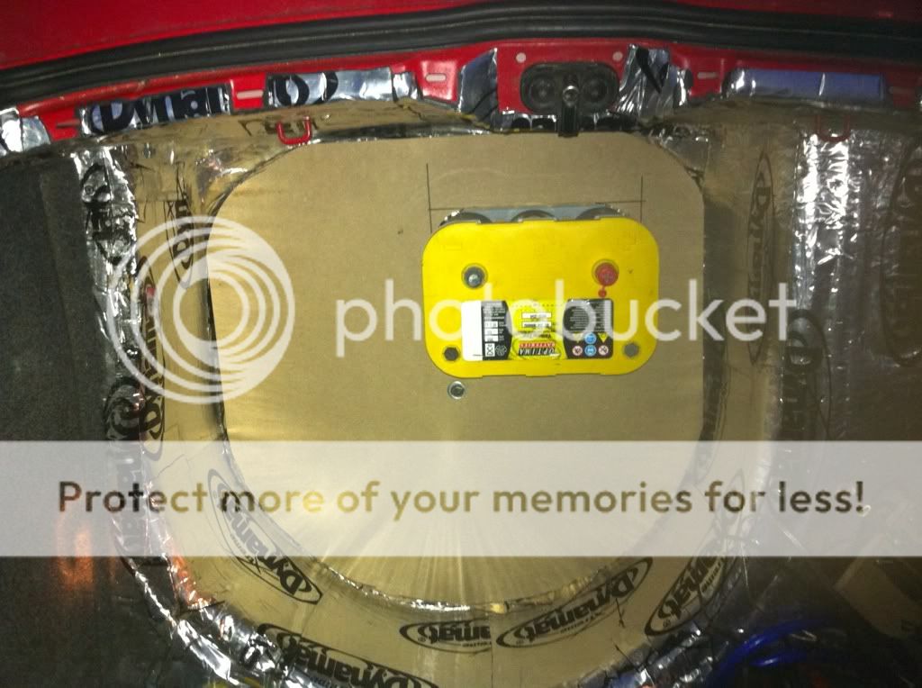

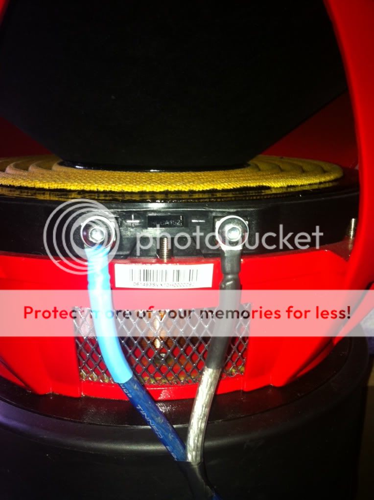

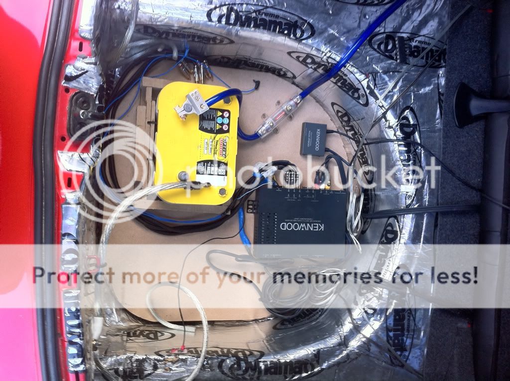

Hi all I just finished installing my sounds:
Kenwood kac627dvd head unit
Kenwood iPod interface
Hertz 6.5" components in front
Hertz 6.5" components in the rear
Orion hcca 15.2 sub
Orion hcca d5000 amp(sub)
Kenwood kac ps4d amp(components)
Optima yellow top battery(in spear wheel well)
Stinger 200amp split charge relay
Autoleads 0gauge wiring
Autoleads 4gauge wires to the amps
2 autoleads fuse holders 250amp anl fuses
4 way fused distribution block
Thanx for looking
Dynamat sound proofing through out

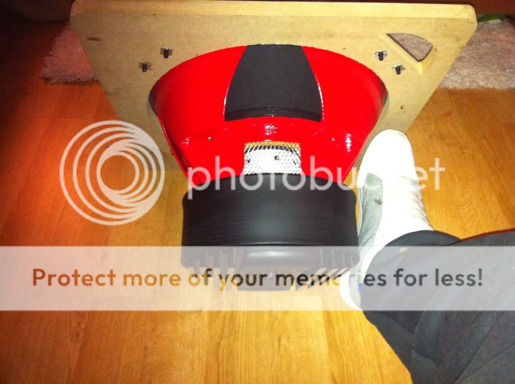

masiv it is that one sub weighs 35.9kg which just under 7 stone lol and i dont realy no how loud it is yet runnin it all in and i listen to all sorts of music

I know a few people with that sub and amp combo doing 147db. That's loud man.

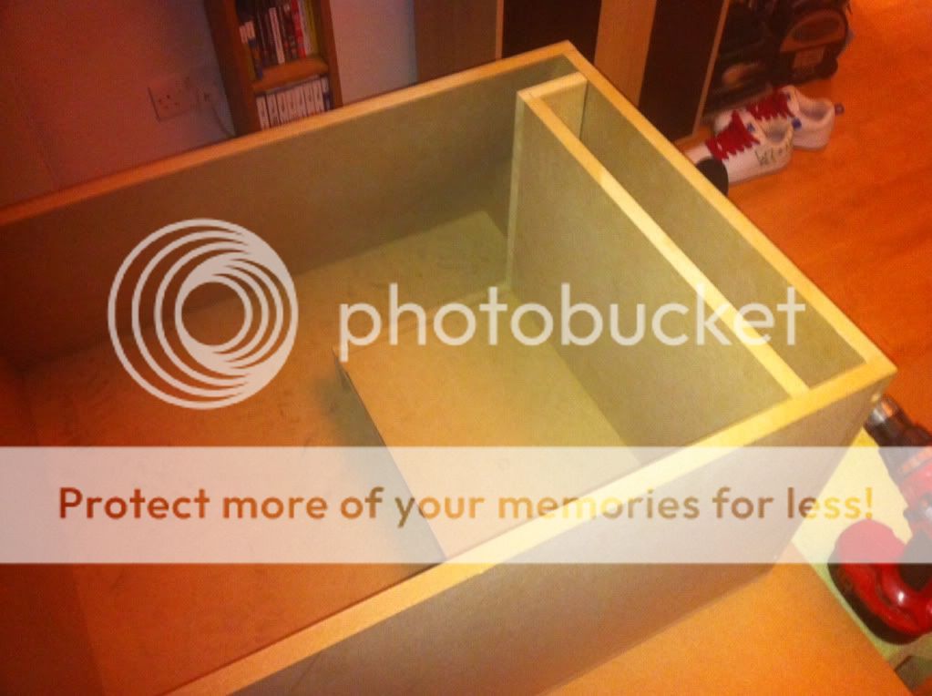

I've changed alot since I put this on lol I've got a different headunit amps moved flat against the sides bigger box(4 cubic feet) just waiting for my new optima battery to get here coz the old one was fooked lol so should he good bi chi wot do u mean u Wouldn't of had the rears??

4cu ft is that after displacements? What's she tuned to?

Yer mate around 4 cubic feet after displacement and it's tuned to 29hz with the sub facing the roof
