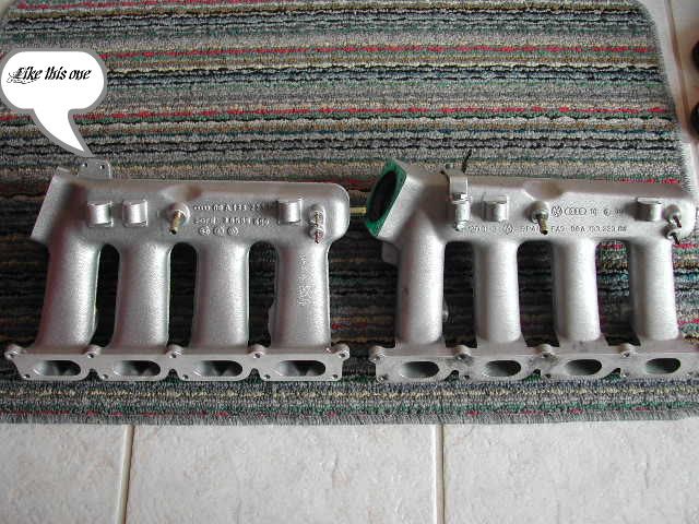

If its got a bracket on the front for the throttle cable then its an AGU.

The AGU inlet manifold is larger port than the AUM. Also has a bracket for throttle cable and on one of the ports the bolt hole for the bracket that the engine cover screws into is in a different position.

Phil, that picture is great!  Thanks for that!  :smiley:
