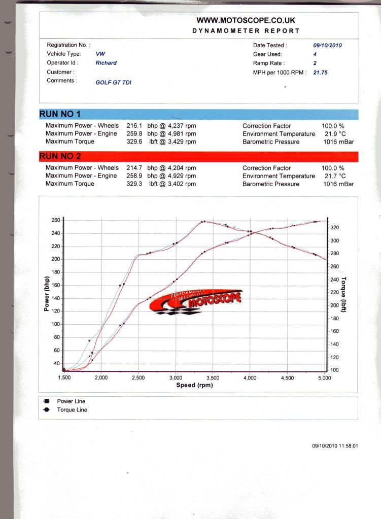

That don't seem worth it for 12 bhp no ??
You're only looking at the peak gains
Look at the average area of the curve and look how much power is available across the rev range  :wink:
Also I don't think Greg's has bigger injectors  :undecided:  There was until recently a myth that you slap on a hybrid turbo and you'll see an easy 225bhp +.  It wasn't until a RR last year that a lot of hybrid diesel owners finally found out the truth  :lipsrsealed:
It just isn't possible on the standard injectors - not without pushing them to beyond their limits which also gives you a very smoky map.  Then of course you shorten their life span considerably
As Neil said; hybrid, cheap and reliable never fit in the same sentence

As Rhyso said Greg doesn't have bigger injectors, Bobby, Fenwick or Ray (aRd) have done loads of research and they would be an ideal starting point for the questions, wouldn't want you wasting money on a hybrid if there is a better way :afro:
Ray, Bobby and Stu are running a different turbo all together on a custom manifold with bigger injectors - Ray got arround the 250 mark on a RR day last year and that wasn't mapped correctly either.
