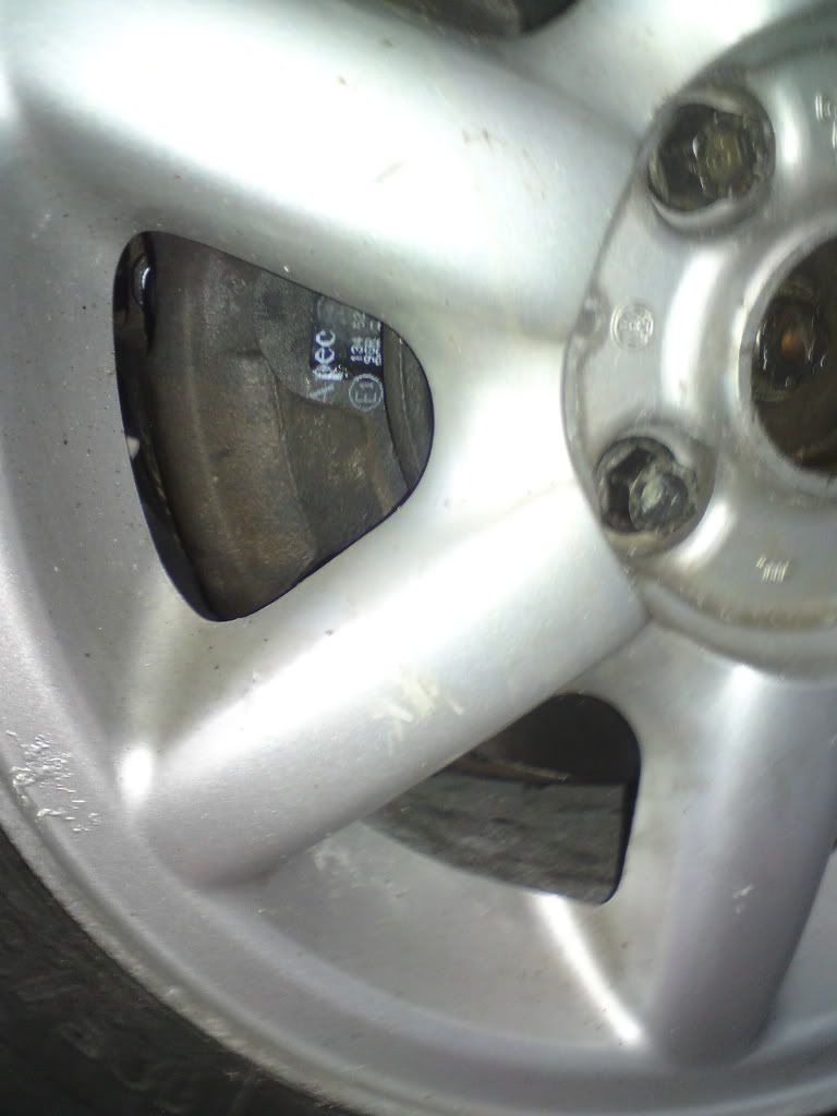

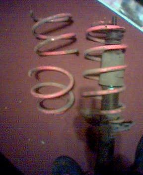

got back and did the usual jack it up and inspect everything which was when I discovered the cause of the rubbing and lack of good handling, A snapped spring in 2 places really un amused. photo.
So went a hunting on Ebay and found a pair of front spax coilover dampers cheeep so bought those and got springs and a spanner from spax. Fitted those now handles like the go kart I was expecting.

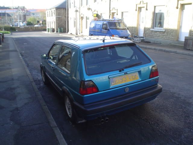

BTW took of the lovely clear lenses and fitted a nice new pair of hella oe smoked lenses looks loads better just for that also added debadged front grill new smoked fogs smoked side repeaters. got an original set of vw multispokes which are getting refurbed and black chromed anybody know where this can be done? yorkshire area. going to Elescar VW show on sunday so probably be posting Monday with more Bought bits!

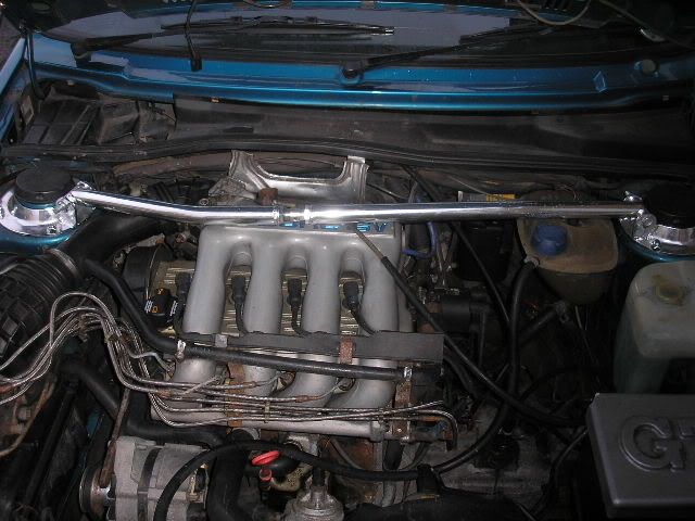

Also bought a FK strutbrace and fitted it along with g60 top mounts a few weeks ago.

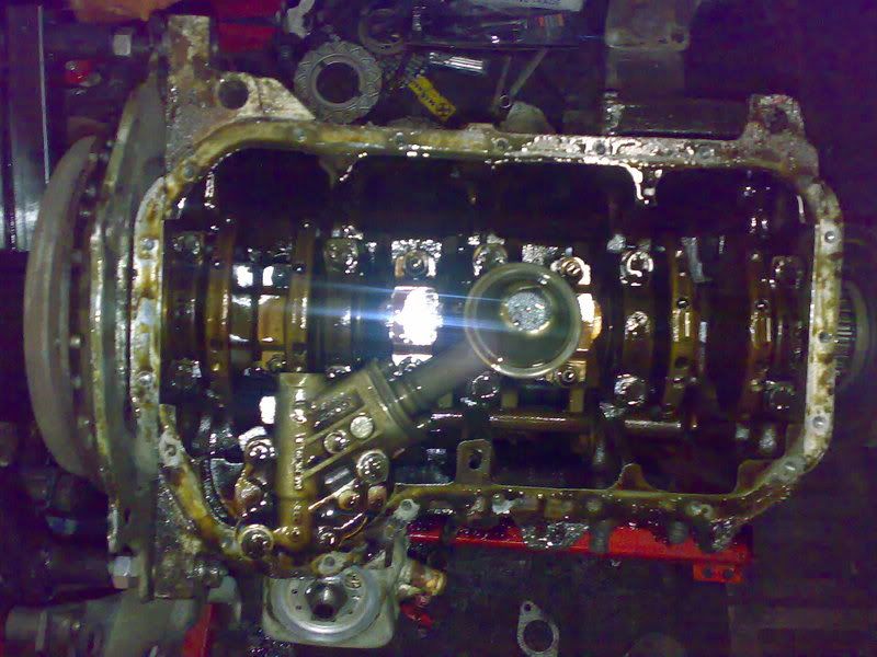

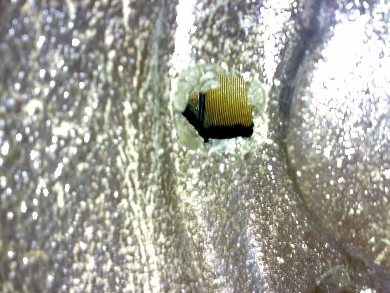

the gearbox let go and made a big hole and a lot of noise
So I did the following!

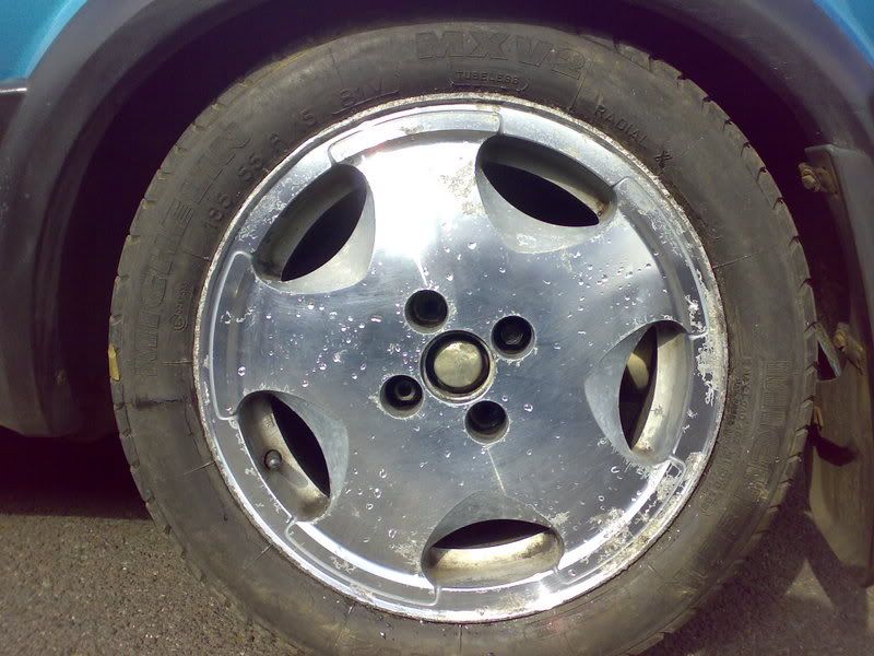

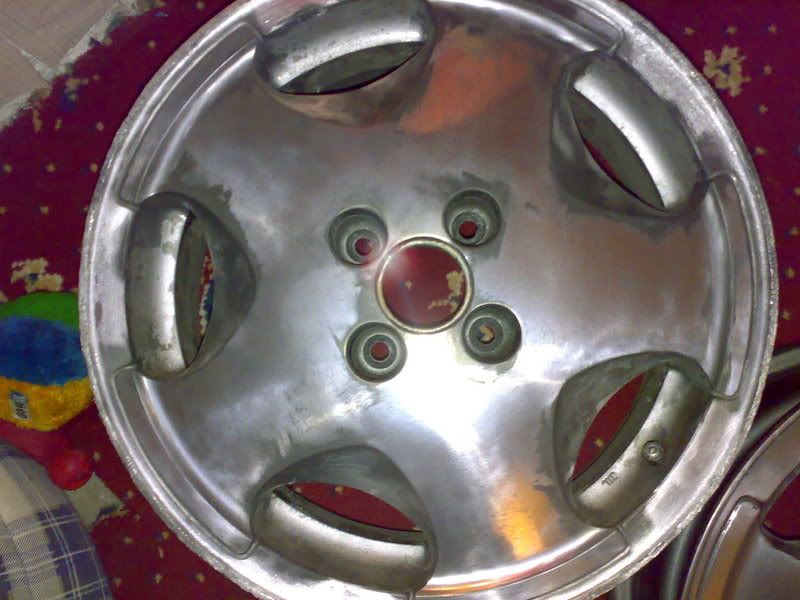

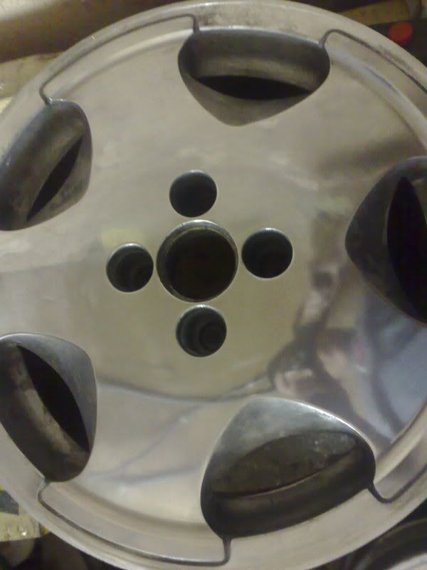

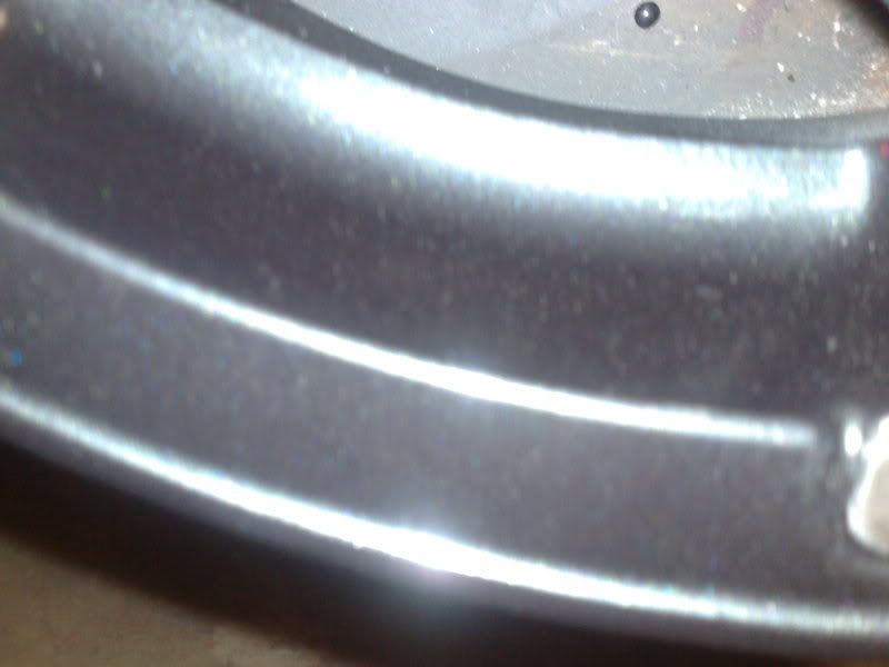

Got these wheels from Ebay and started stripping them back as they were corroding and looked awful.
I started polishing them up which started to make them look like this
and me like this

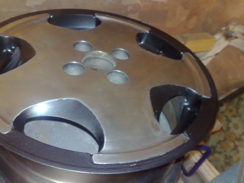

Then after a fair old while got them looking like this
Then realised I had 3 more still to do  :lol:
Then got busy with a spraygun and got them like this.
Now need to get some tyres on them and about 16 different locking wheelnuts and I'm good to go :)

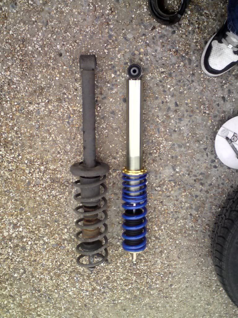

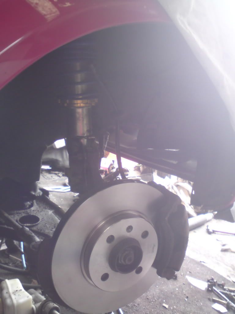

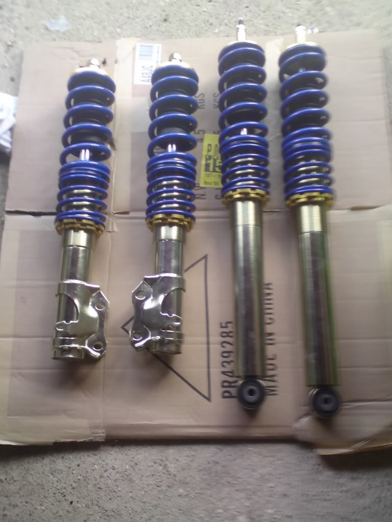

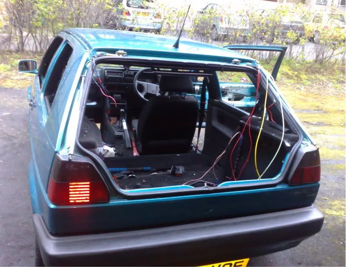

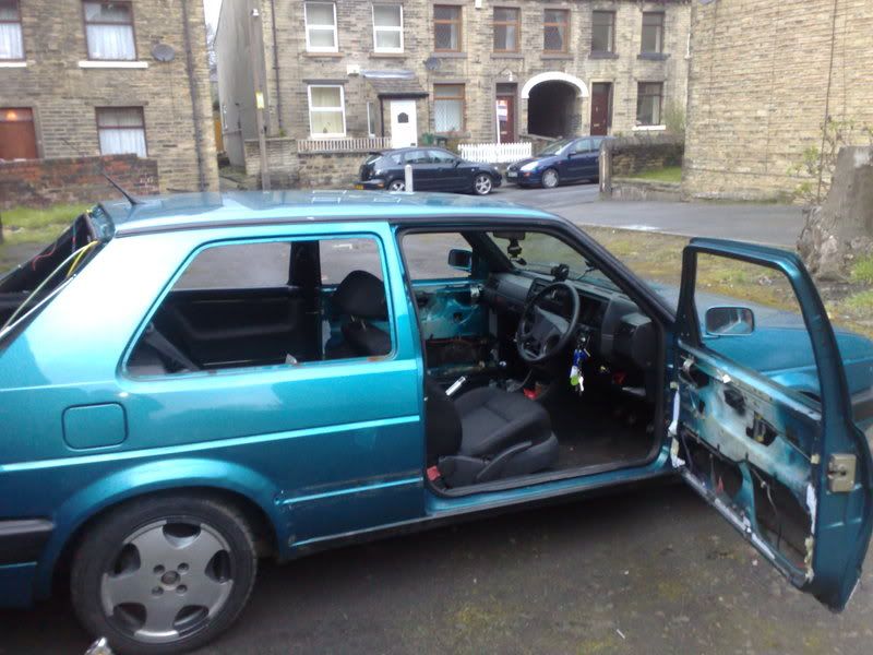

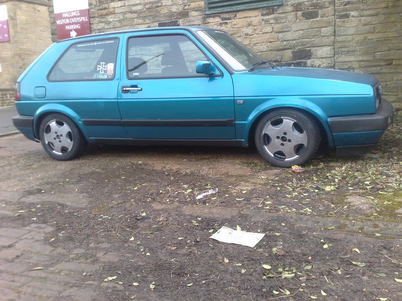

Well Fitted my Hot Tuning coilovers and slammed the car to the deck!
Then tonight I have taken her to be resprayed :) took all the trim and windows out and boot off and set off!
More to follow as work goes on with her :)

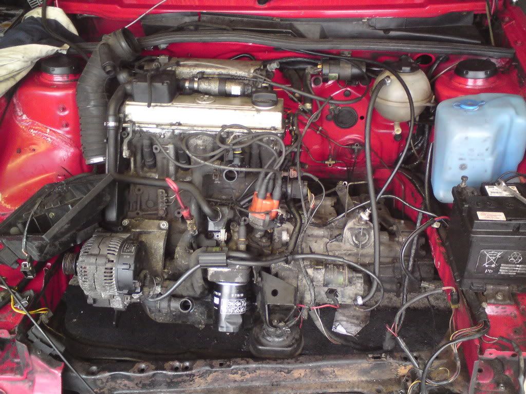

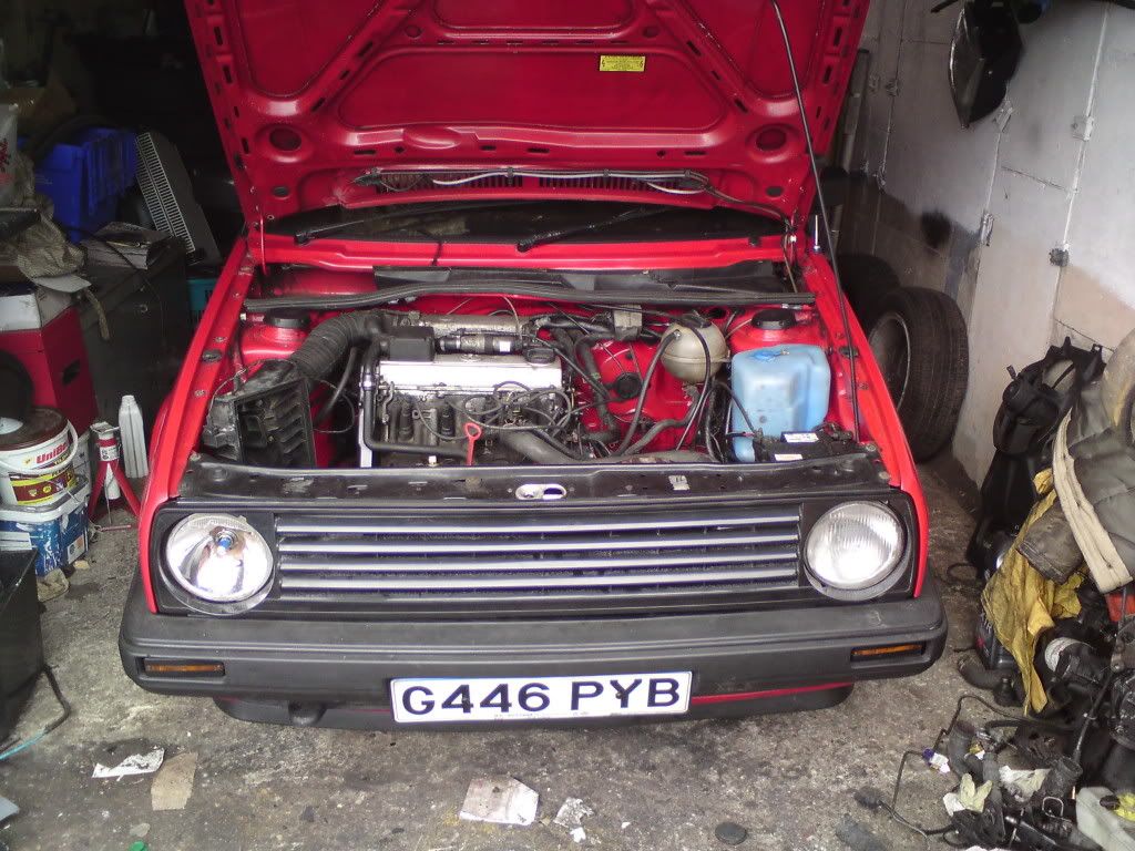

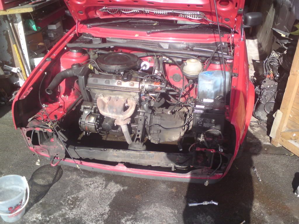

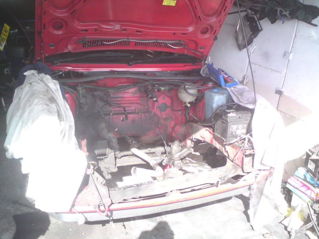

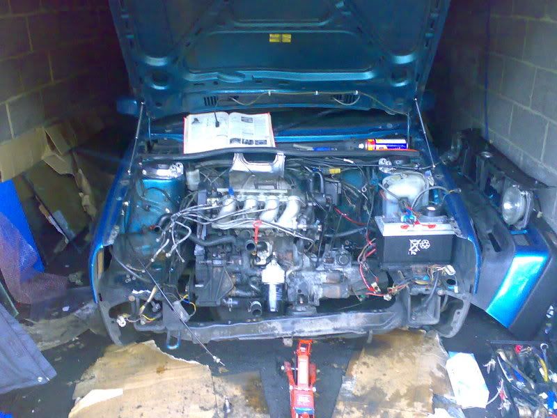

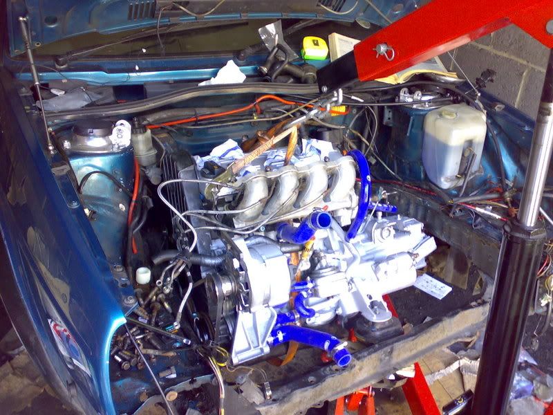

The Project begins a 1.8T into my mk2 Golf 16v
Audi Engine in an Audi

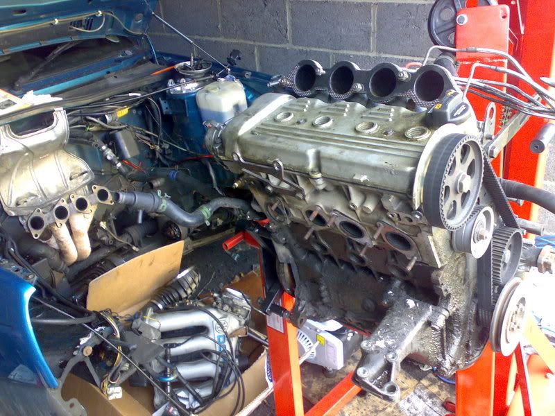

The project starts here the photo above is the Audi after a mild spanner wielding session to strip it down and get it out and on an engine stand, this is day 1 part 1.
The engine up close and personal
The lump, a 1.8 20v turbocharged Audi auto engine, code is AEB. It's an early big port version Mounted longitudally so the wrong way for the golf which is transverse and an auto box just for extra giggles.
Now the bumper and front end are off we can see what we have
notice the second rad fan is mounted to the engine and a viscous hub, it also has power steering which I don't have so the pump will need removing and the belt layout re routing to suit amongst other things.
The turbo!
This is the turbo it's a kkk k03 turbo the engine produces a factory 150bhp although it is capable of more power by remapping which will push it up to around 200bhp.

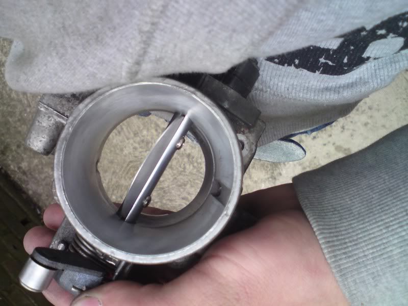

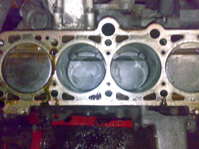

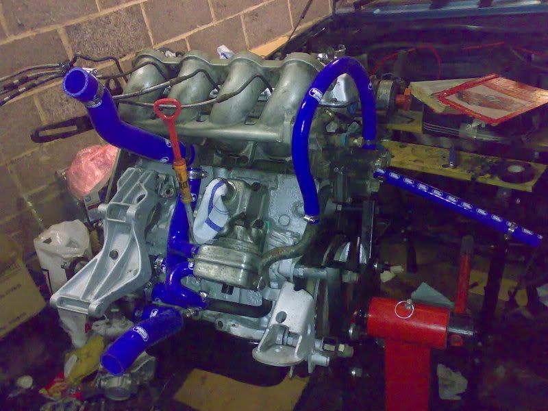

The Engine is out now and on a stand, I've stripped it, cleaned, re gasketed and replaced any broken or worn parts, I have got an AUG code inlet manifold fitted as the AEB one doesn't fit.
AGU Inlet manifold
As you can see, I decided to go against the current trend of polishing and chroming everything. I've gone matt black if it was on the engine and not black it is now matt black! black silicone hose and a dash of carbon fibre here and there. 1.8T mk2 Black edition! smile.gif
