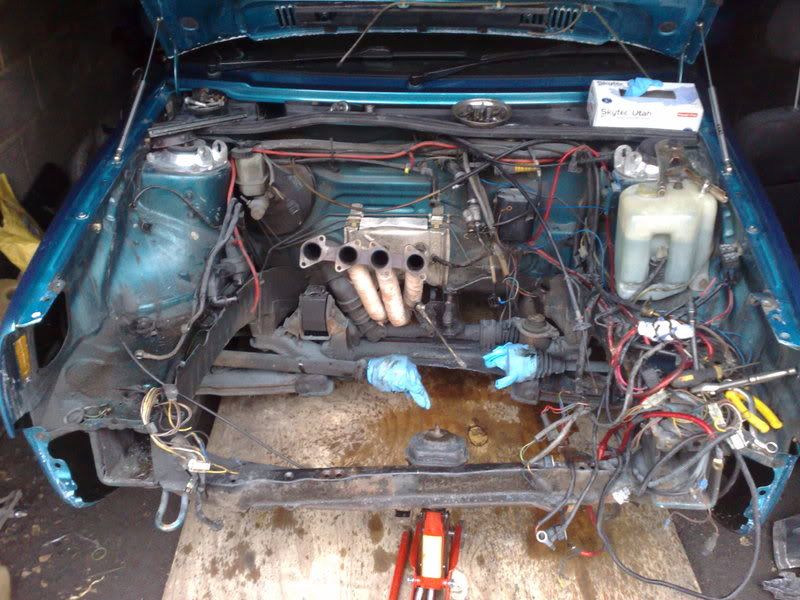

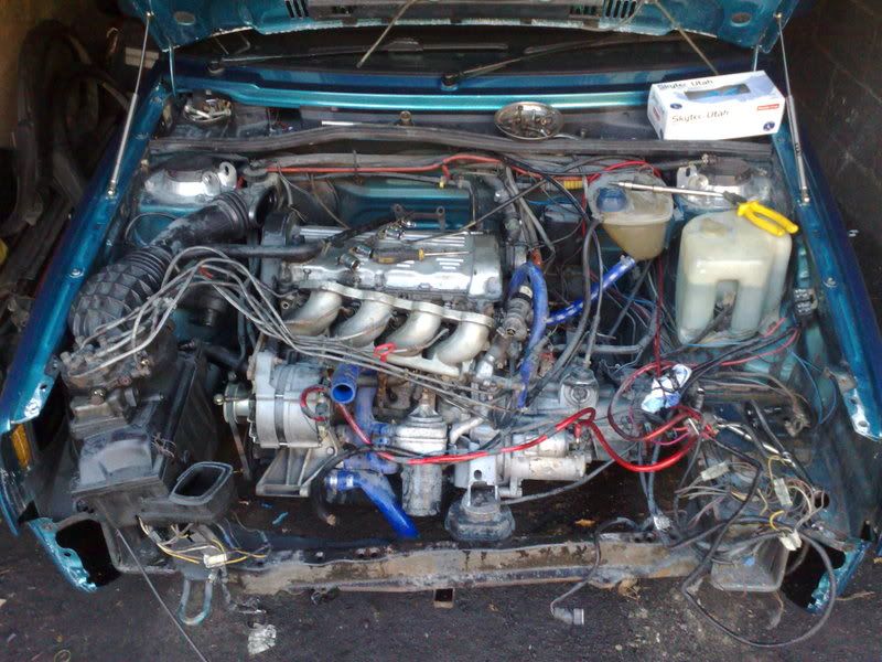

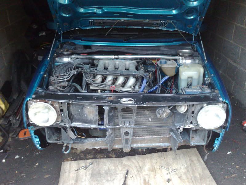

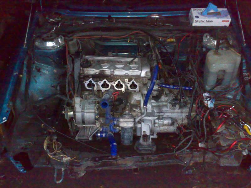

Well here we go again! The engine is out and it's back on axle stands once more. Some pics of progress so far and hopefully get the engine sat in this week to start figuring out the plumbing and exhaust stuff.
It starts like this
Your coming out
Bumper off
Front panel off.
Right now I can see what I'm up to.
take off the manifold
Unfasten the exhaust and coolant, unplug the gearbox and out we come, one engineless golf took me about 3 hours altogether.

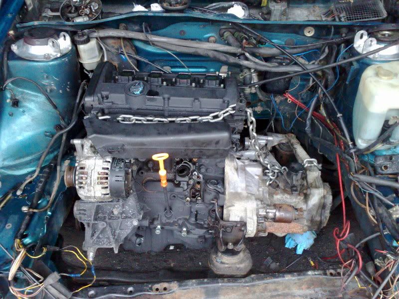

This is where it begins fully  8)
The engine is in, well it was it's back out now  ;D :D
Slight issue with the sump. I have a solution though I hope :)
Just changed the gear linkage from rod change to cable change and started to swap the pedal box over to the hydraulic version from a Passat GT to match the gearbox which has altered ratios.
So far so good couple of things are a pain to figure out but nobody said this was going to be plug and play and I do like a good challenge :lol:

Bit of an update guys,
The engine is now in the bay, a mk4 golf turbo and manifold have been put on along with the mk4 coolant and oil lines to the turbo, 16v sump from a KR has been fitted and seems ok had to fit an oil return to it and hoping the driveshaft clears it  :o

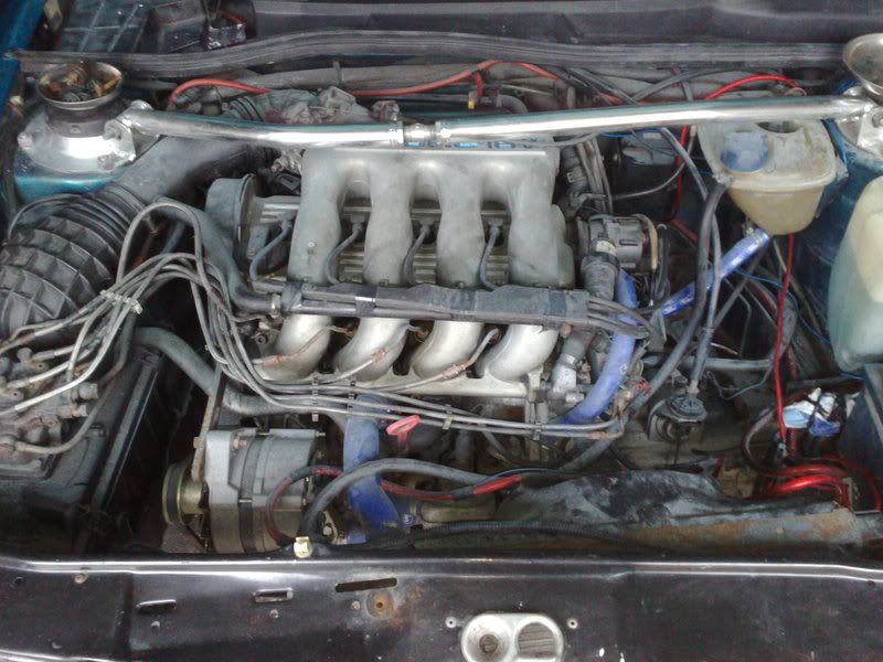

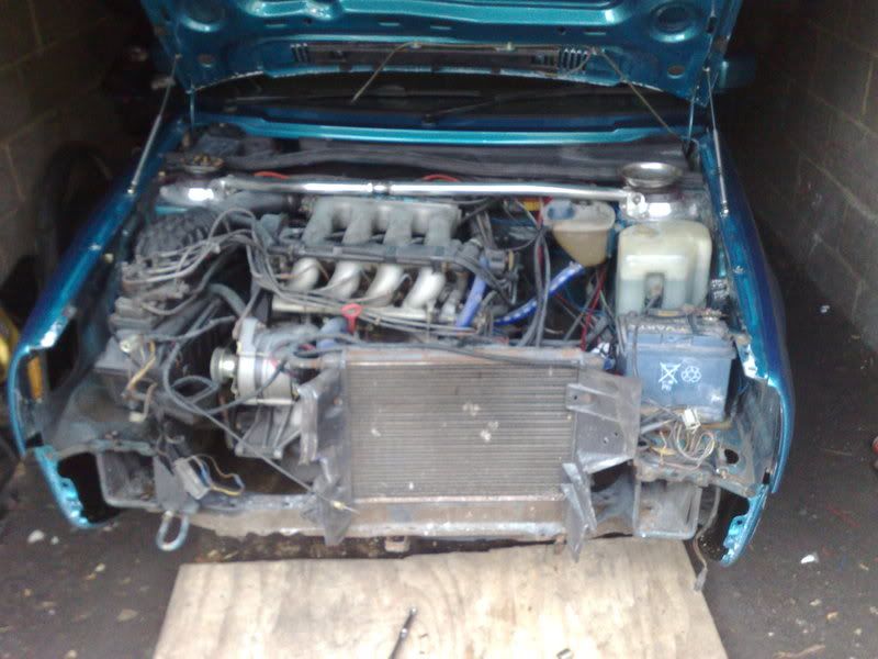

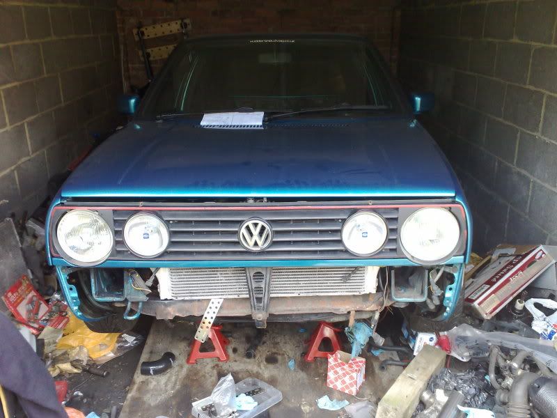

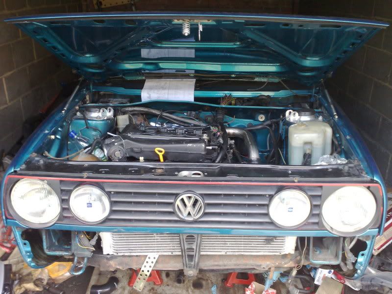

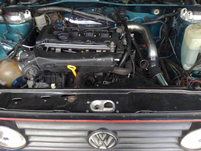

Spent most of today in my garage and got a fair bit done.  Bit of an update and some pics :)
I have got the intercooler and rad mounted up and plumbed in,
Intake pipe to turbo and outlet pipe are in place,
Coolant pipes are done bar a few jubilee clips,
Wiring loom is plugged in and nicely grommeted into the raintray ready for splicing into the ECU when it arrives.
Gearbox and rocker cover/inlet manifold are now black again,
New wheels are on the way to fit over my new shiny S2 brakes,

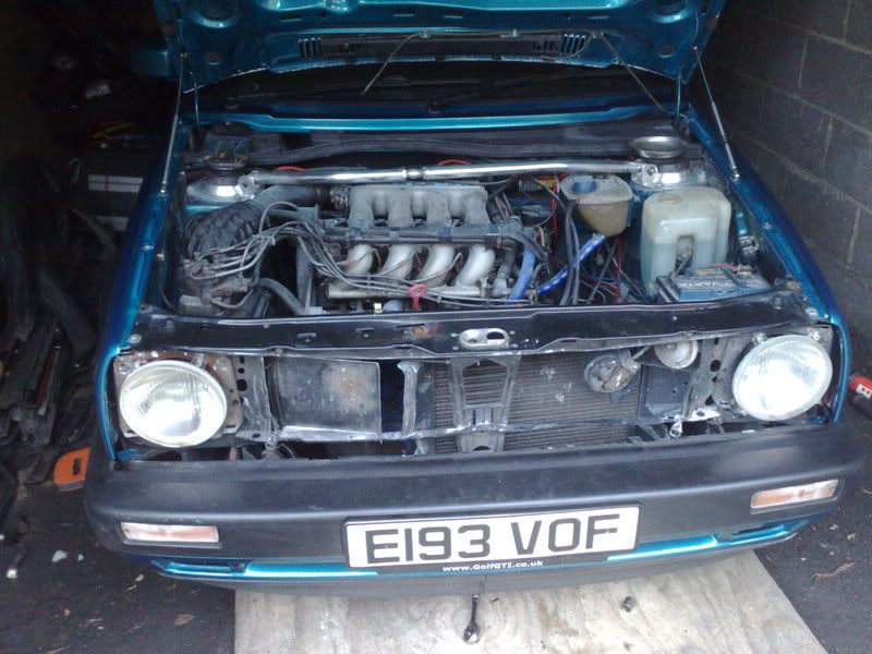

Put the front back on, looks like a golf again :)

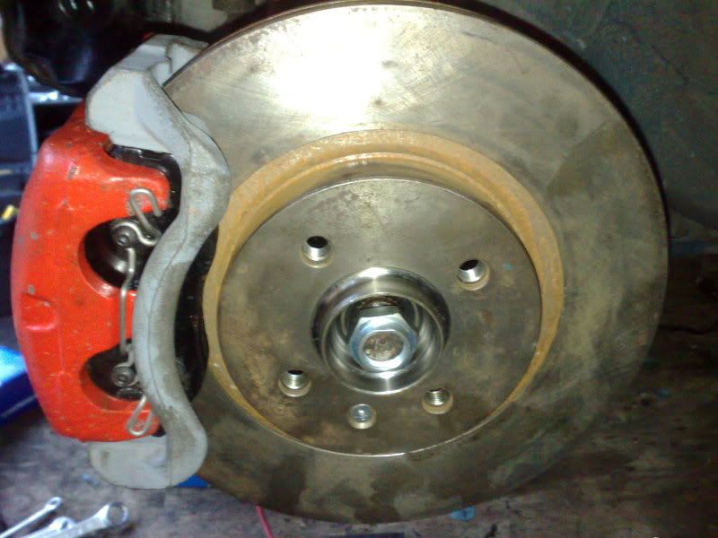

The brakes are fitted on one side now the other side needs a driveshaft or inner cv :(

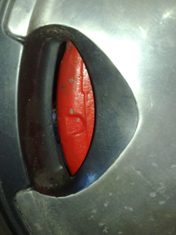

Audi S2 280mm twin pots  :smug:
They just fit under my Estorils :)
