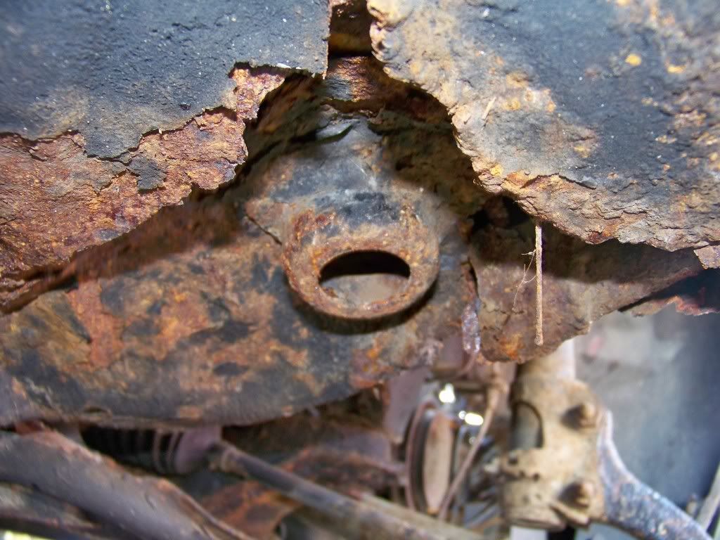

Offline emery1990
  • Posts: 1,196
Re: Jacking points advice please
« Reply #9 on: 11 March 2011, 18:56 »
Picture says it all really.
