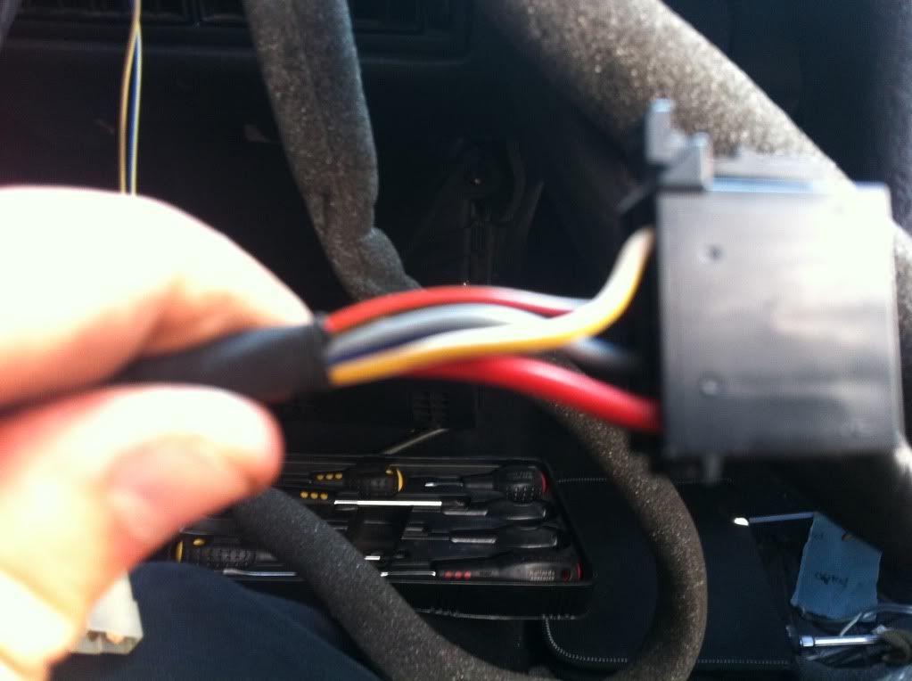

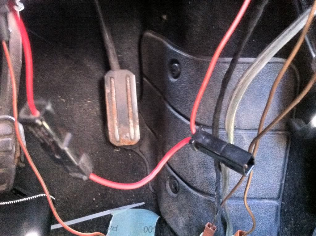

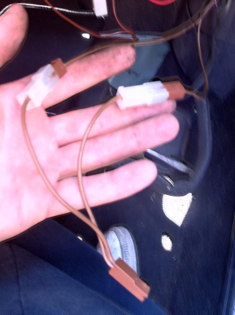

I hope you've got things running prior to winding up that engine loom!!
Earths - pretty much anything brown like that needs to go on the earths connector - a baskety thing up by the fuseboard.
Main power feed - goes in the back of the fuseboard - find something that will take it.
Stereo plug
Stereo again - power not speakers.

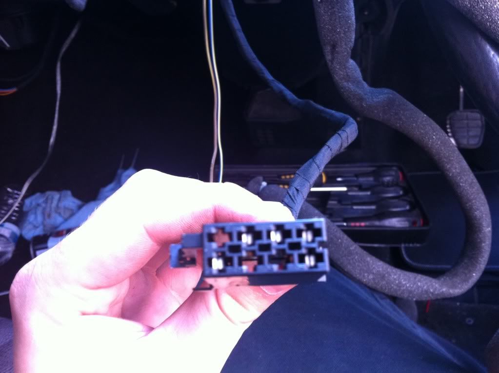

Thanks mate any ideas on the yellow 1 wire plug from the fusebox theres a couple of these i think not going into nothing ??
The power for the speaker is good atleast i know where that is now.. the speakers have been re-wired with proper speaker wire and not very well so will re-do this after ive got the engine in an running..
And na ive wrapped it before the engine is running lol.. i have faith though as RubJonny made the loom if worse comes to worse can unwrap and rewrap at later date  :smiley:

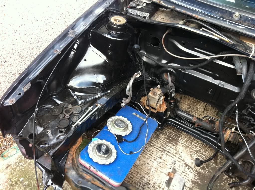

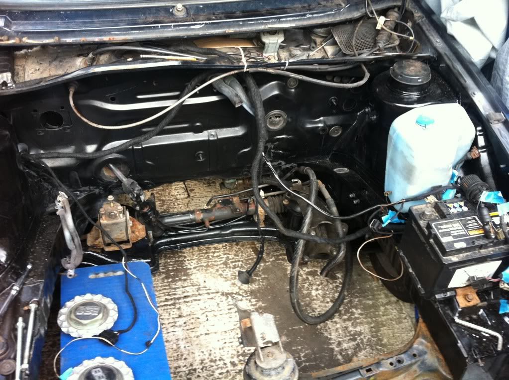

just tried to fit gearbox to block and again no luck its just wont fit  :undecided:
Also i cleaned up the injector rail as it was filthy.. good old autosmart G101  :cool: and i have various other bits and bobs a little clean
They may never have been fitted in to anything.  Go find another Golf of similar vintage and compare is your best bet  :wink:

My 10 pence worth.  I think the yellow is the Dim Dip (headlights) control wire.  Had similar on mine and is not required.
So why is it there mate ?
Offline SoundillusioN
  • Posts: 10,004
Re: Dan's mk2 8v to ABF 'restoration' project *Update page 24*
« Reply #248 on: 17 September 2011, 10:18 »
When I rewired the MK1 I was lost with a yellow wire with no home and everything worked!... In some countries dim dip is required, the equivelant of DRLs but they use your headlights at 30% during the day until you actually turn your headlights on.  I could be wrong when it comes to your car but this is what I found with mine.

Did you keep it ?
It does make sense and i suppose it's less hastle for VW to leave it there. I will see when I plug the battery in to whether stuff works lol
