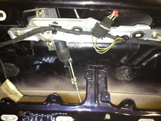

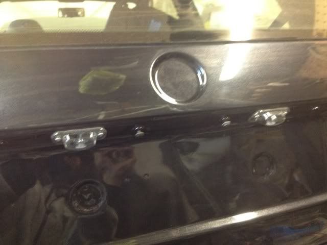

Also have been wanting to find out how to get a boot popper in there to open the delocked tailgate. Had no joy, so had a play with some metal and the welder.
As you can see. No lock hole and no wiper.
I thought about how i could secure the solenoid in the tailgate and decided to mount it on the wiper moter bracket. When you remove the motor, theres a recess the allows the solenoid to fit in there nicely. :smiley:
But had to secure it there, and wanted to be able to remove and replace it easy if something went wrong.
I bent up the metal securing strips that come with the motor to make some brackets.They were bent in a way that i can remove the motor without taking off the wiper bracket. Once happy, i tacked it in place. It didnt weld great due to the type of metal/coatings but was strong enough.
Not the best pics but you get the idea.
I fixed this into the tailgate and using the supplied hardware i connected it to the lock mechanism. Once that was done, I stated on the wiring.
This is how it fits.

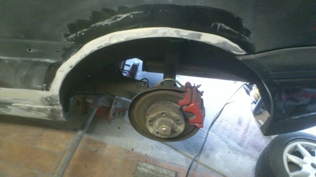

I finally found some time and £££ to get the car bodywork sorted. Found a place local that would do some work for me.

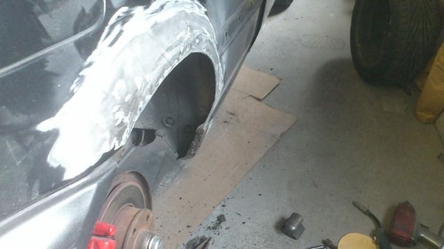

Before painting, it needed the rear arches straightening after the arch rolling exercise didn't go too well. [:$] Her are soe progress pics.
Drivers arch

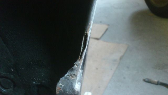

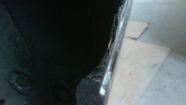

A bit of rot that split the metal near the sill, needed attention.

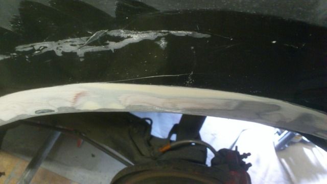

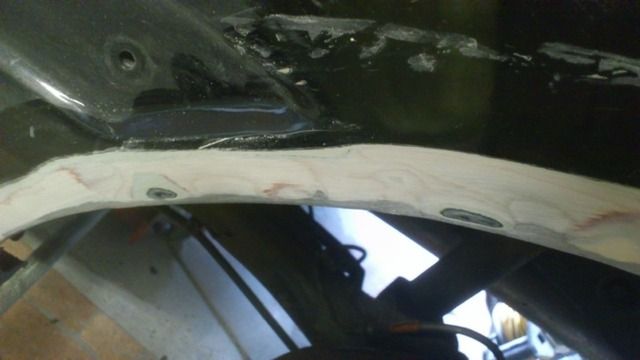

Ready for smoothing.

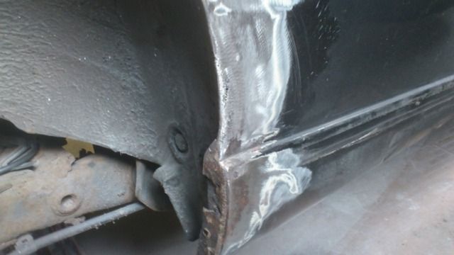

Passenget side needed sorting due to a previous arch repair.
