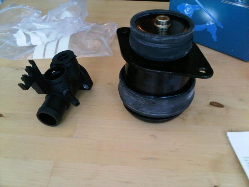

been trying to sort a leak today on the water flange on the head, disconnected everything and thought (hopefully) i could get away with just replacing a perished seal. got the system drained and the part off and found it looked like this....
as you can see there is some damage to the pipe inlet (the white area) and is leaking around the studs it seems. so i replaced the o ring and put some high temp gasket around it to try and seal the damaged face as i would have to order a new part. got the car upto temp and was pretty pleased to see no leak! took the car out abit later on and pulled up to check again and the leak was back! :sad:
so new part ordered from GSF along with a gearbox mount as the engine is shuddering when pulling away and after giving it a prop under the bonnet it DEFFO needs replacing.

new parts!!
mount which 'should' sort the engine thats currently trying to escape!
water flange to replace the old one thats had its day. although this one from GSF has to be blanked off on one of the switch holes im unsure about whether thats going to have any leak issues or not! we shall see!
