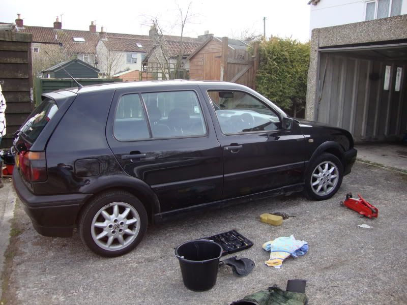

Bought this reasonably local for what i considered cheap, mk3 8v black 5 door GTI, has had a respray at some point which is of a good standard and sets the car off nicely, full service history, clean interior, cambelt done in 2009 but the car has only covered 2000 miles since then. Has been well looked after it seems. the guy i had it from just wanted rid as it was blocking his drive (no boats jokes)!
only pic i took of it today was this:

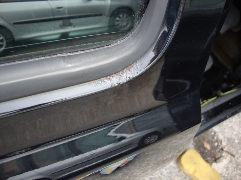

a few bubbly rust spots which again i will get a mate of mine to sort by cutting out and respraying! one on o/s rear door under window which isnt too bad and rear of arch on the same side!

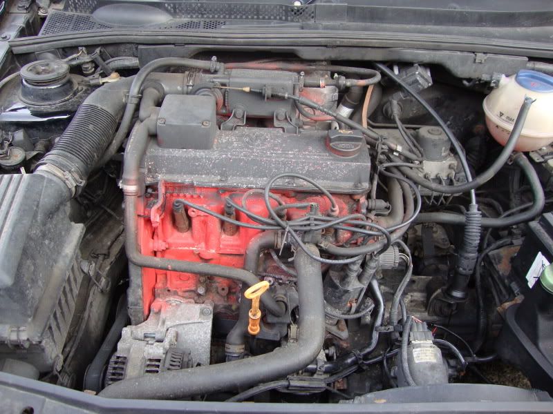

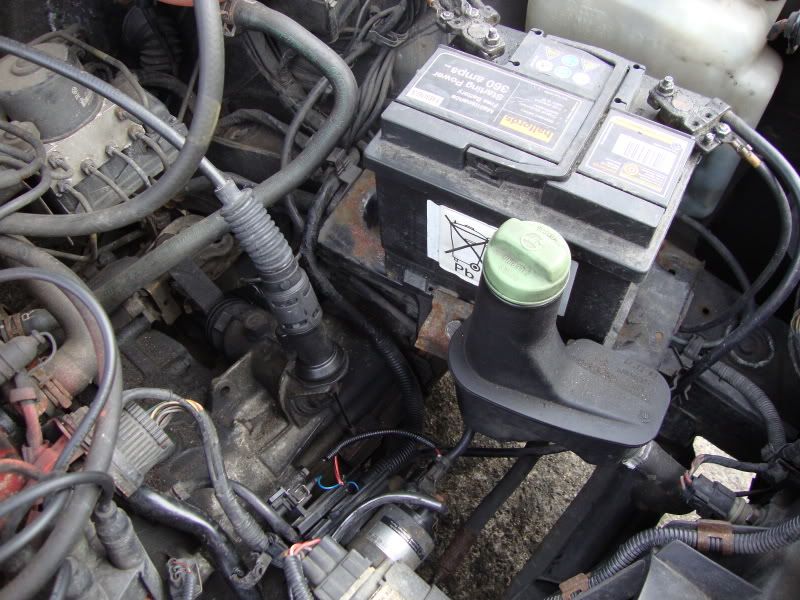

firstly i got in the engine bay as i noticed a few things werent secured properly. main ones were brackets for the power steering hoses so got them on properly job done! next the clutch is biting abit high so checked the cable and found it wasnt a straight feed to the retainer. after fixing that it still bit high so im going to swap it out for a manual adjusting one as the auto ones seem to be really pap on golfs! pic of the bay, as you can see some numpty thought it would be a great idea to buy a can of red spray paint and attack the block!  :shocked: :rolleyes: i will get round to cleaning this up later in the year!
battery tray area, not sure if they as prone to rot as mk2's but looks tidy enough! :smiley:

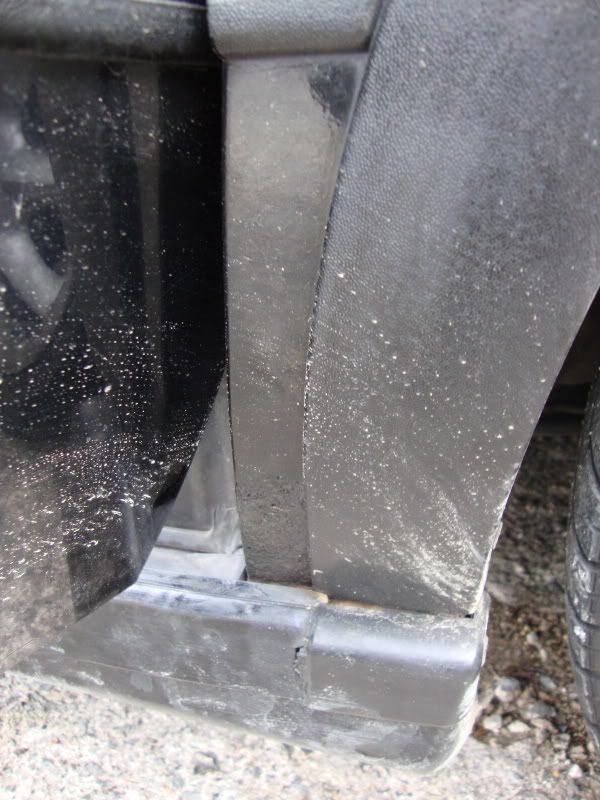

After this i got underneath to check the sills, o/s front is fooked and needs replacing as it has a small rat hole in it, sills it seems are reasonably priced and can be sourced from a company in Westbury which is on my way to work so i will get on and order one tomorrow and my friend can weld it for me! :afro:

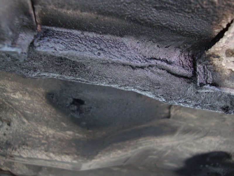

other side seems fine and just a clean down with a wire brush and some lovely waxoyl was all that was needed to tidy it up!

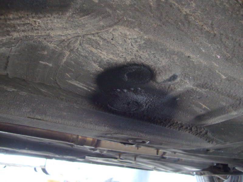

noticed that there was a perished drain plug in the floor pan so ripped it out and a nice bit of water came out! great! (get round to the follow up on this in abit)! unsure if im going to weld this up myself or try to replace some of the steel thats rotted away which isnt much to be fair! pics:

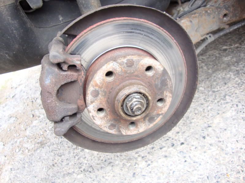

Next up was the rear end, both wheels had play in them when jacked up so i got them off and nipped up the bearings, whilst i was there i checked pads and discs which will need changing in a few months to be fair. also noted on the last mot was an advisory for corroded rear brake pipes which after looking at them seems abit keen as there arent any leaks and its just the paint which has come off, thats what you get for taking the car to a dealer to be mot'd! :rolleyes:

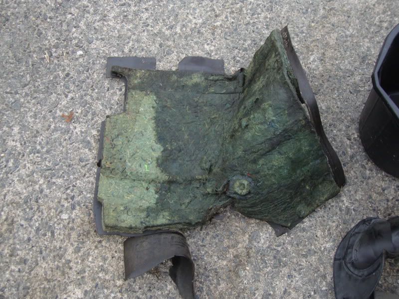

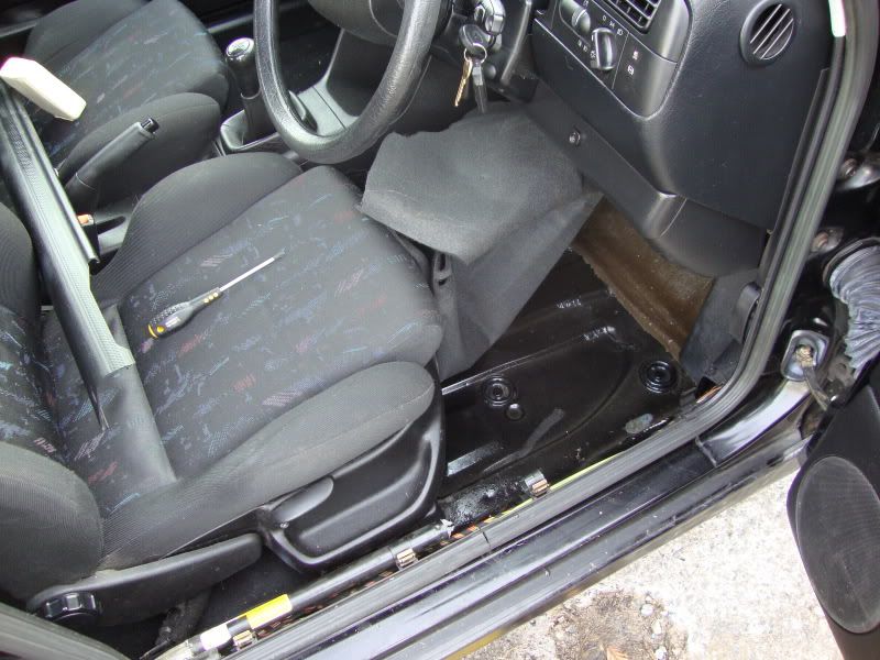

after all that i got back inside to investigate the water spilling out of the drain plug issue, driver footwell was sodden, passenger was damp but not too bad and this had obviously moved to the rear too! it seems like it has been there for a while with the stink that came out as i pulled the carpet up. the sound deadening material fell apart so i will be replacing that aswell.
Dried it out for a few hours and put the carpet back down. plan is to pull the whole lot out as i cant find where the leak is coming from all spots that are usually the offenders arent blocked and the heaters work fine and dont smell so i dont suspect the heater matrix!  :undecided:

Just found my leak(s) into passanger side. First was the drain grommet in the door stop was missing, causing water to enter via door loom. The second was the door seal where it joins at the bottom. There should be a metal connector type thing I think, but all that was left was a crumble of rust coloured bits! Worth a check anyway mate!

The drain holes in the floor pan are notorious for rusting, mine are going to need welding in the near future :undecided:

yes unsure if im going to weld up entirely but it hasnt done a very good job of letting water out anyway! :rolleyes:

Got mine welded up and havent had any issues! Looks like quite a good buy anyway mate. Welcome to the world of proper GTI motoring  :grin: :grin: :lipsrsealed:

It is wise to leave those grommets in, they are fitted for a reason.
On my old 16v I had at least 3 welded up and I belive there purely for drainage I cant really see why it would be a problem to weld the ones that are rotton oh nice mk3 by the way  :wink:
