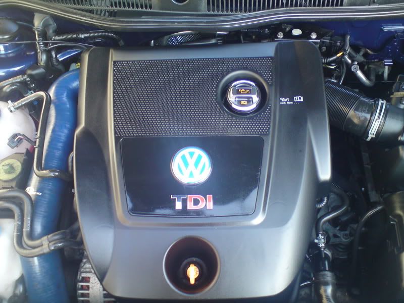

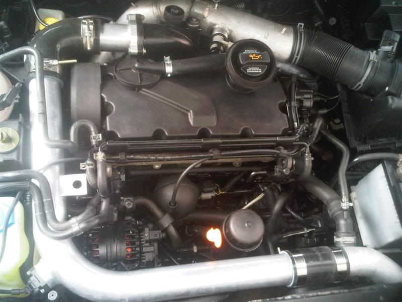

ASZ = 130
ARL = 150
130 engine bay (ignore the blue pipe; its black and plastic on standard cars)
150 engine bay
Again the metal pipes are plastic on standard cars but the route is the same
