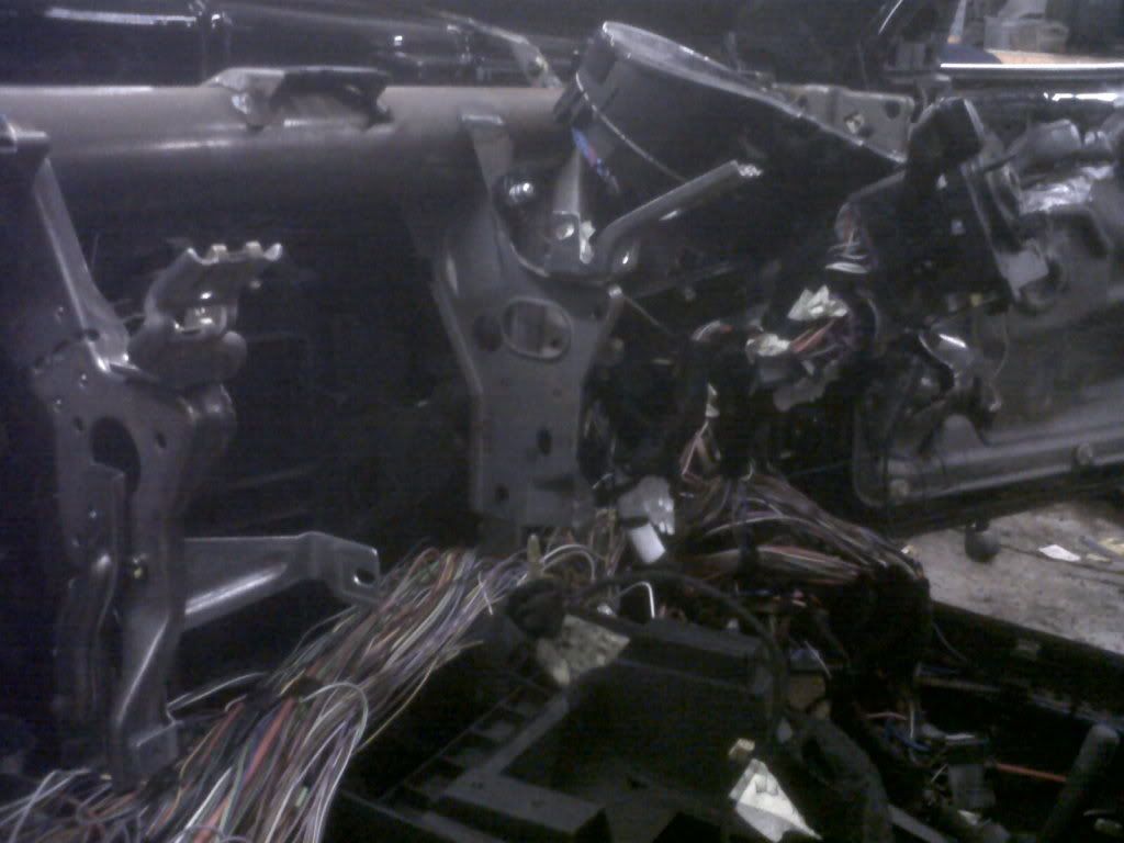

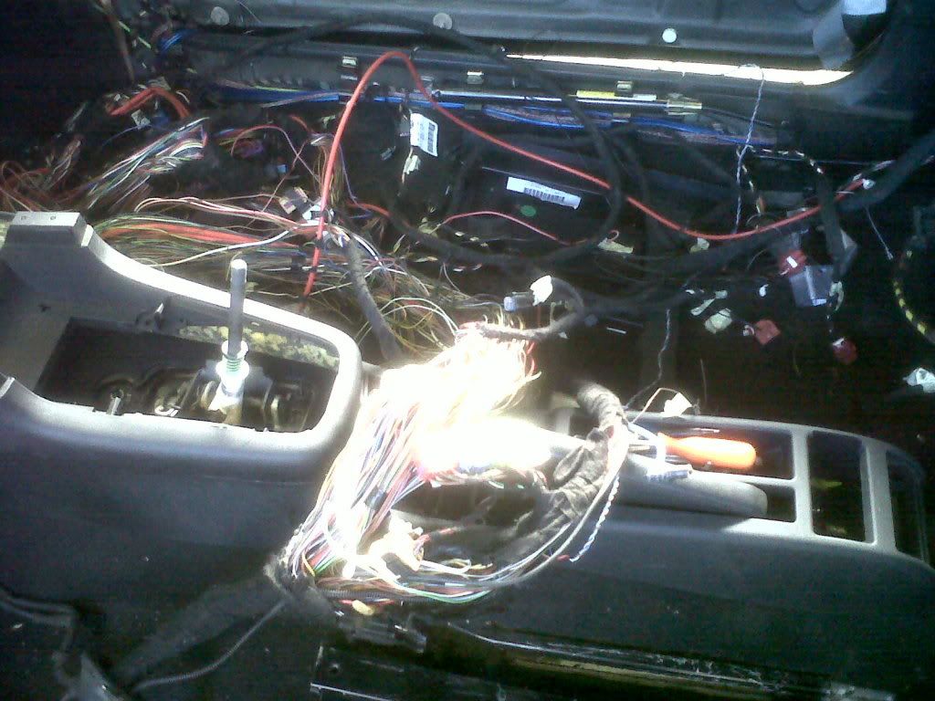

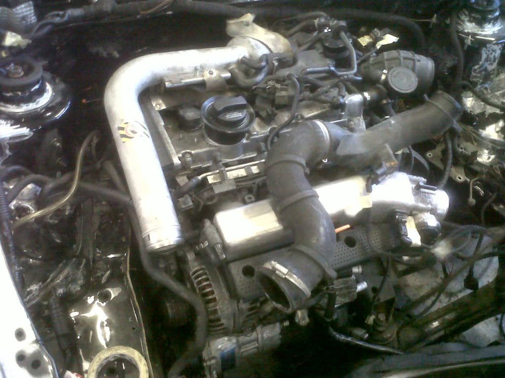

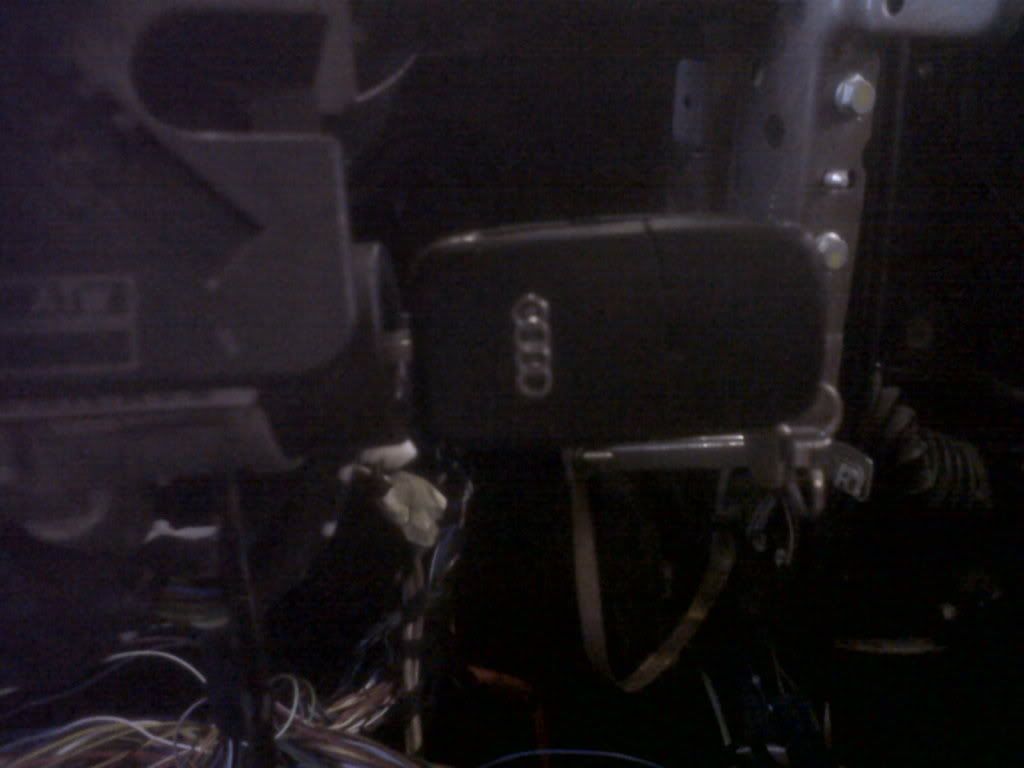

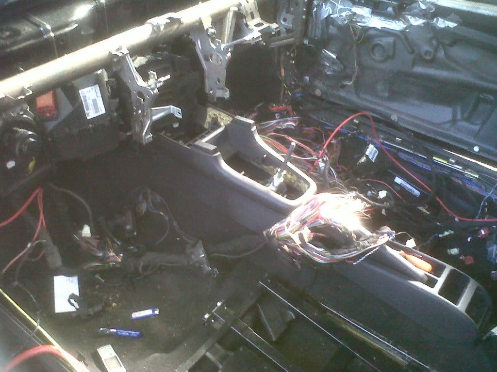

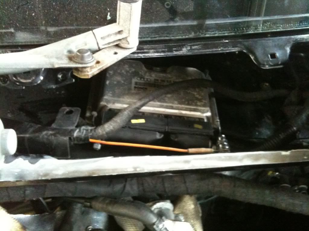

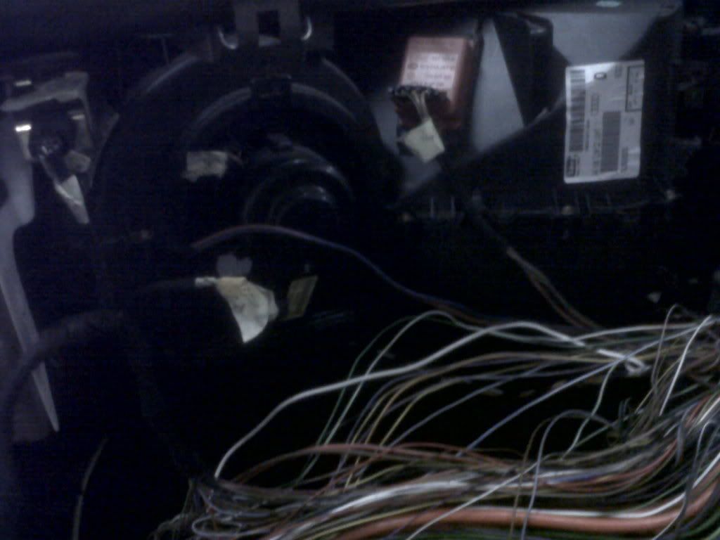

Ok the last night we stripped all the dash & front seats back out, ready for a for the hole S3 loom to go in.
S3 loom is now in the car & going the bulk head
Loom is connected up to everything behing the dash, it's all in the right place to see if we have missed anything & it will also help us when we go to wrap & tidy the loom up.

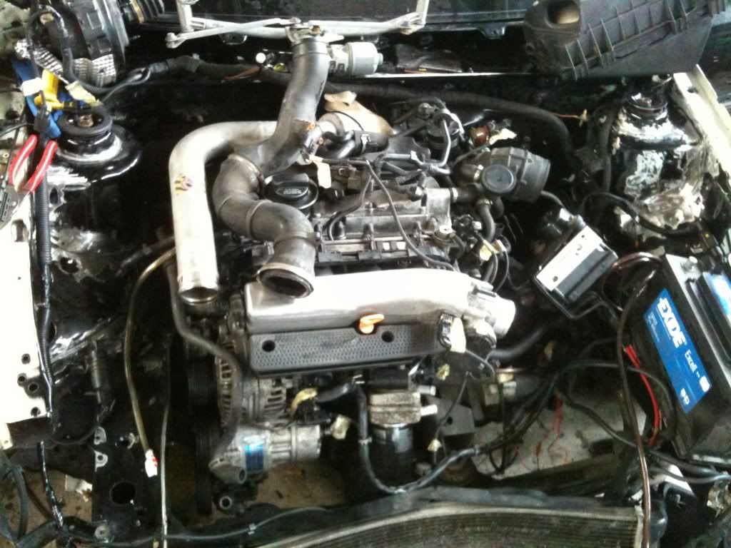

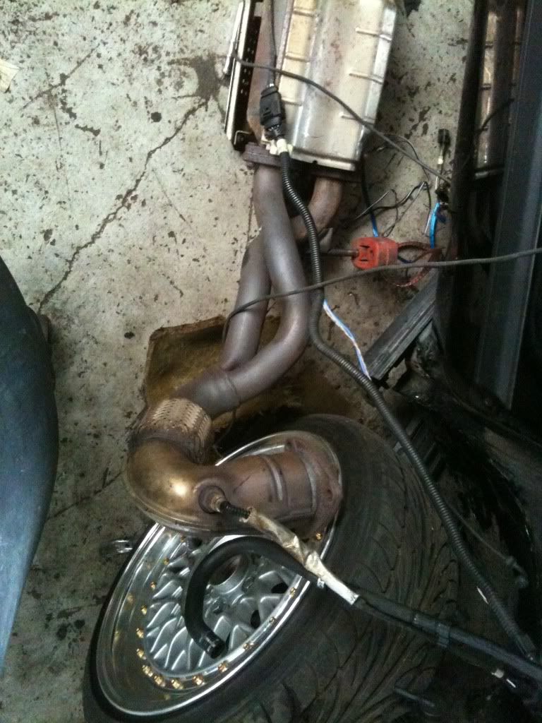

All the loom in the engine bay has been placed where it should go & all the components that will eventually need connecting are placed in the rough area where they will or need to go.

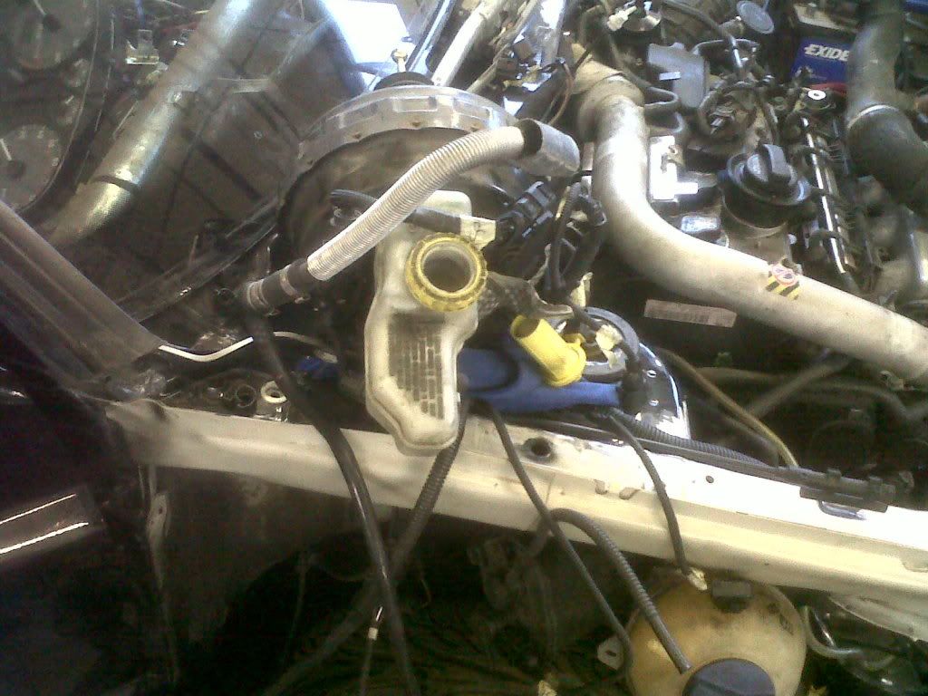

I know I will have problems using the S3 brake master cylinder & servo as there is minimum space between the engine & firewall.

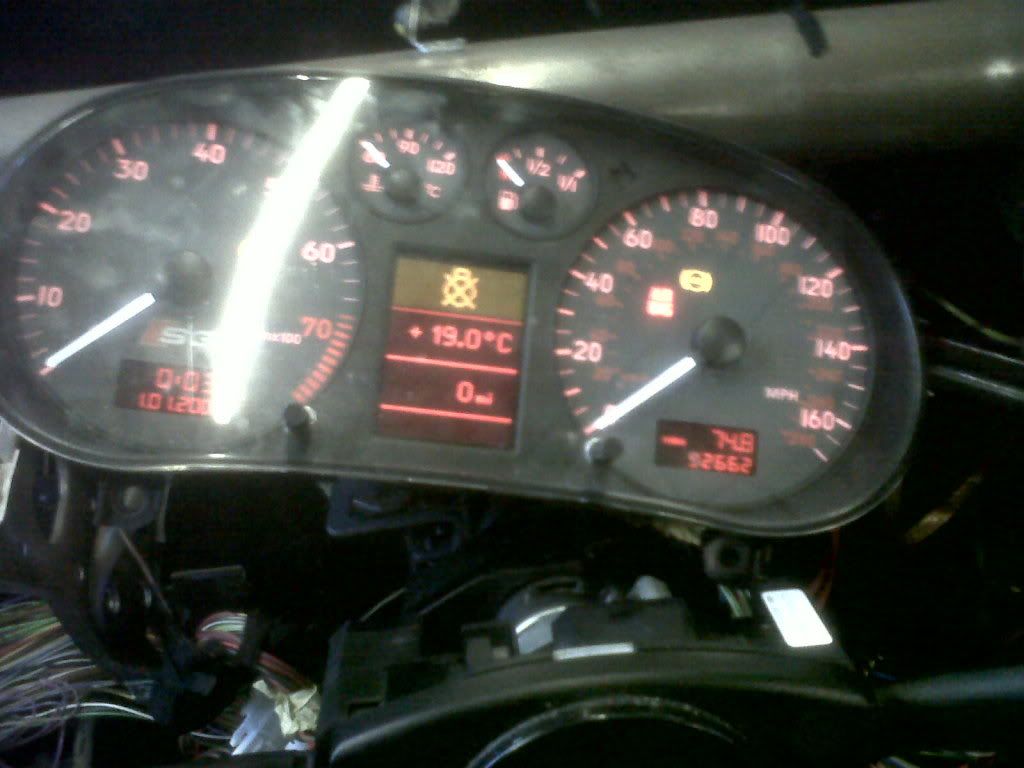

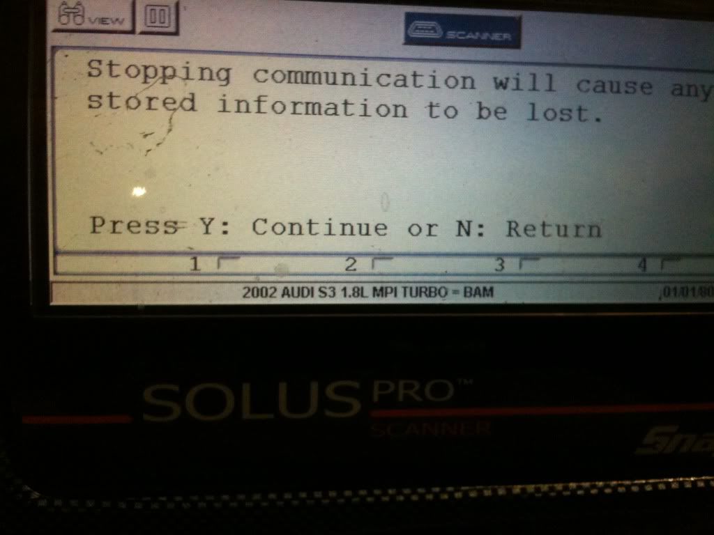

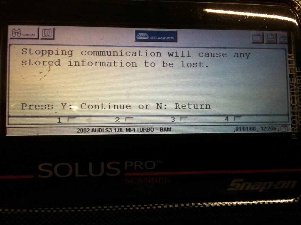

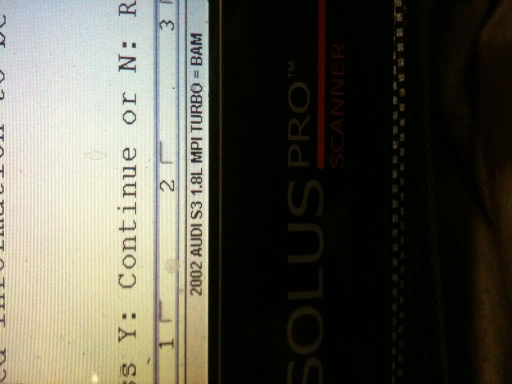

First time we connect diagnostics to the car, read the bottom of the screen

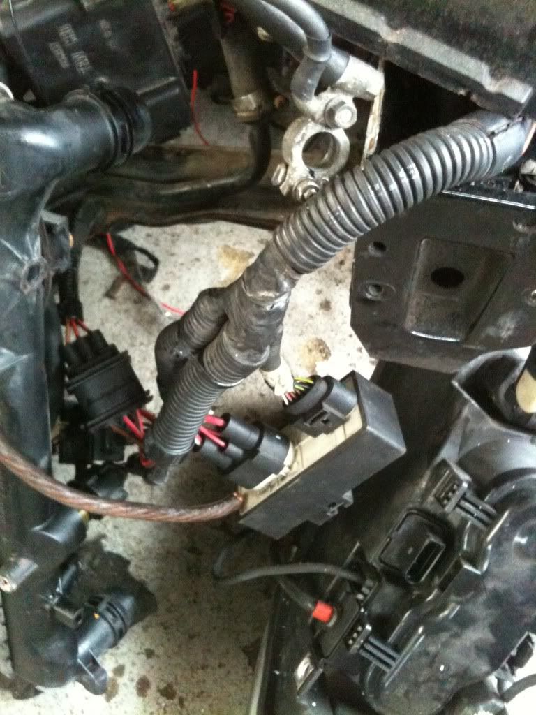

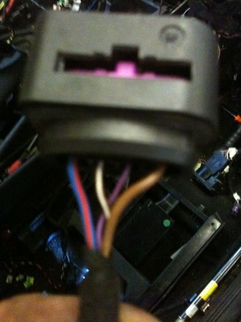

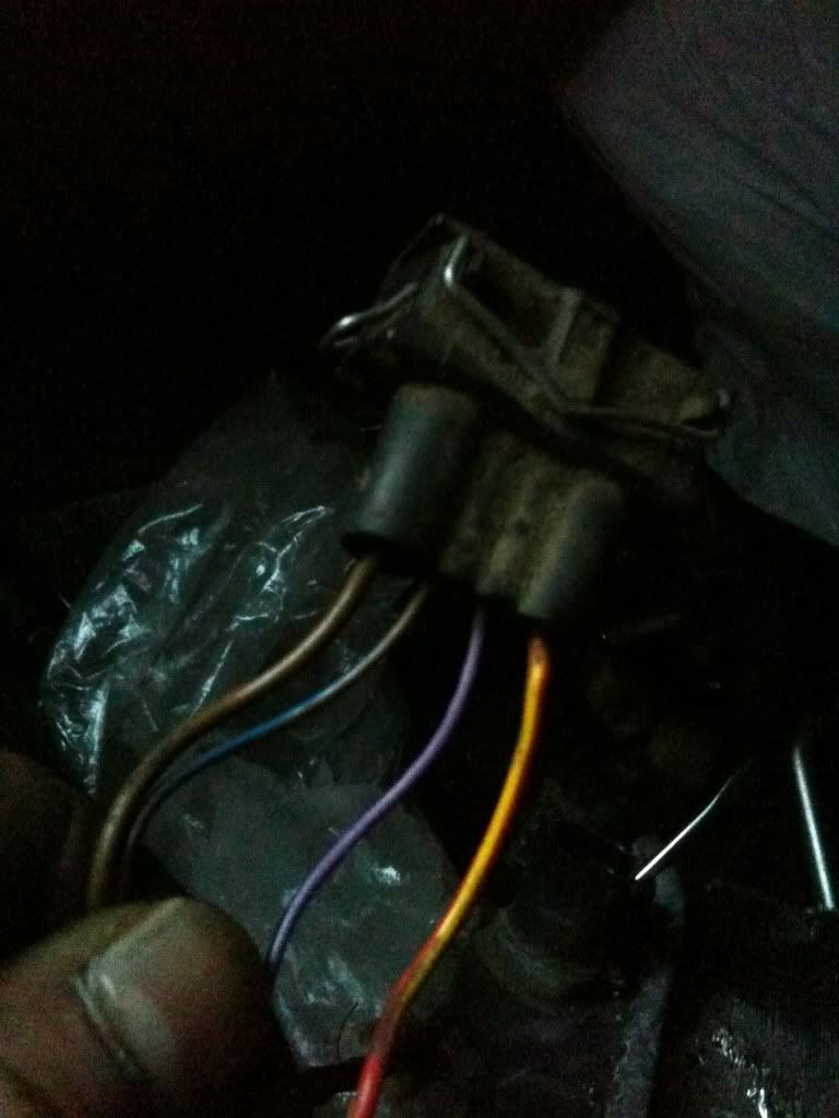

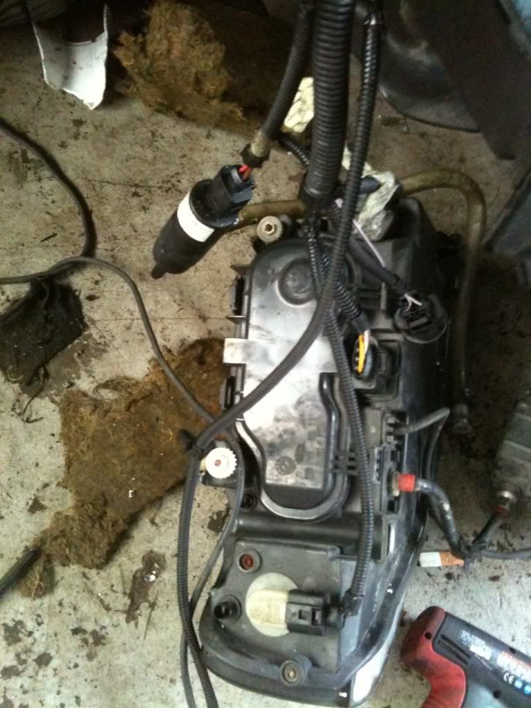

S3 fuel pump connector
Mk3 fuel pump connector

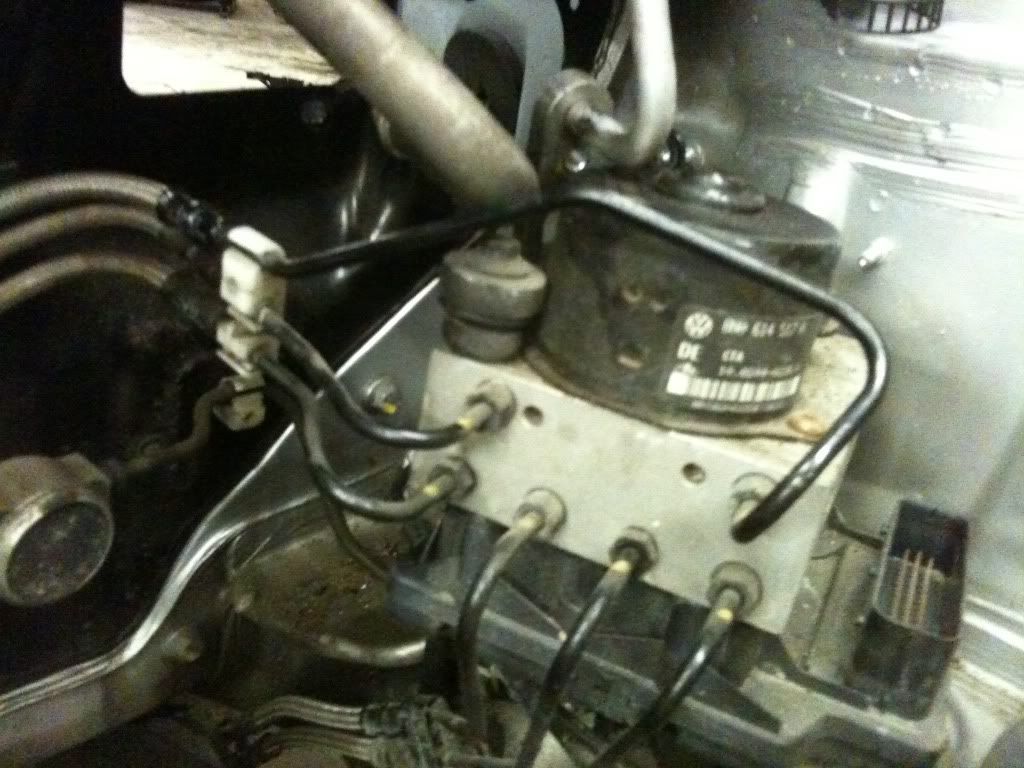

I took the S3 ABS pump off & put the in the mk3 for now it is just sitting in the engine bay connected to the loom so that we have communication through diagnostics.
