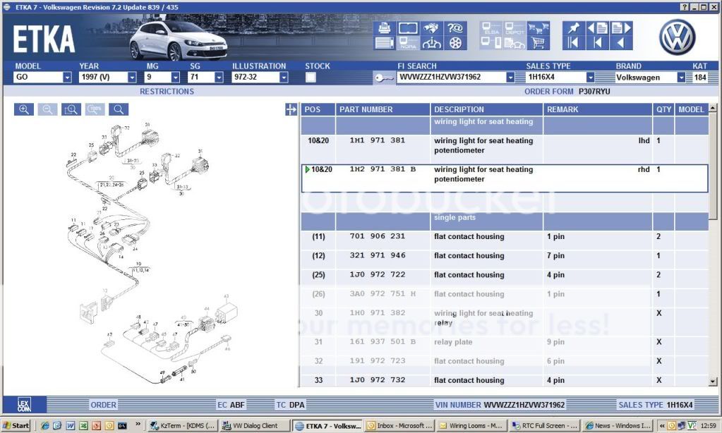

Guess who's just figured out ETKA :grin:

I believe they are handed so lhd and rhd would be needed.
Yer thats what I was kinda thinking but didnt want to tell him for certain that he needs to buy two of the same thing. I guess it depends if you can be bothered to keep your passengers arse warm  :grin:

you will need a LHD and a RHD loom.. these are not for left hand drive or right hand drive but for the seats in question..

« Reply #9 on: 11 January 2011, 13:36 »
ok, so I've been sent this from VW...
This confuses me slightly...  I can see the wires that comes from the seats and plugs into the switch, but then what is the second set of wiring just below this?
Do I just need to buy everything in this picture??
Apologies for being useless... haha
