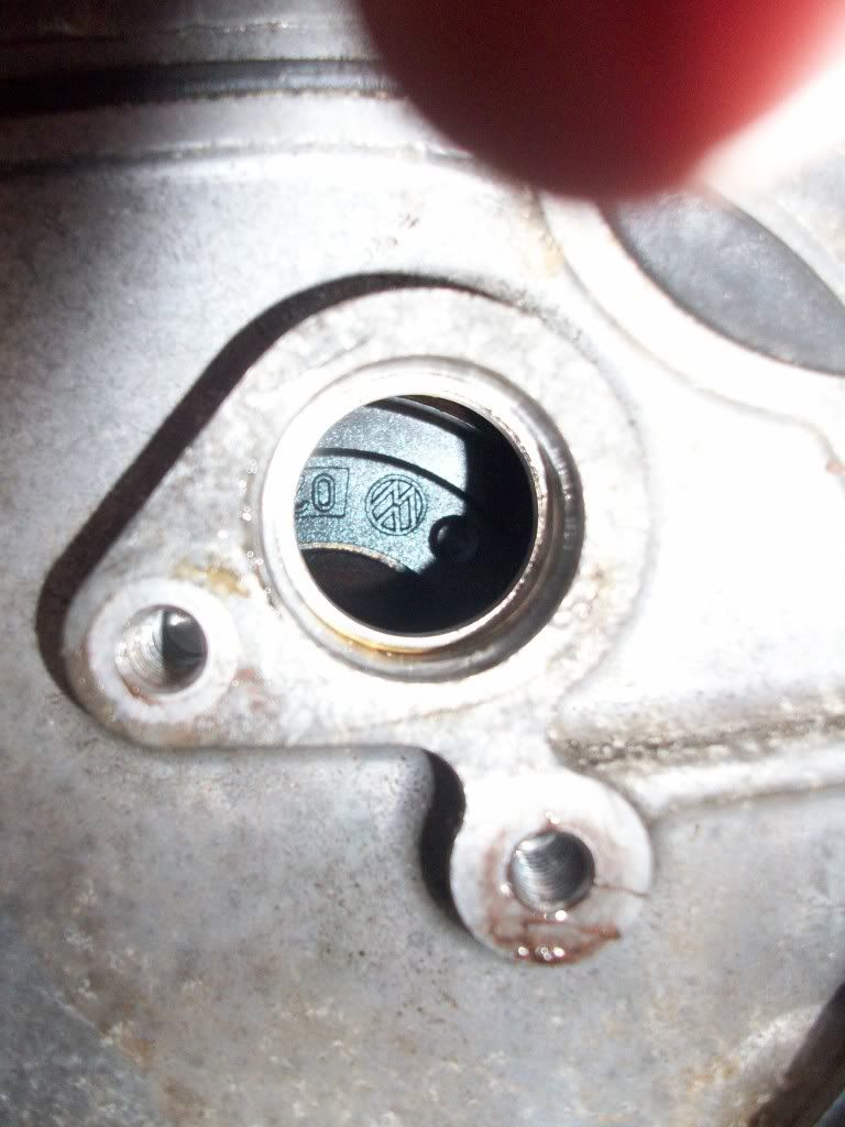

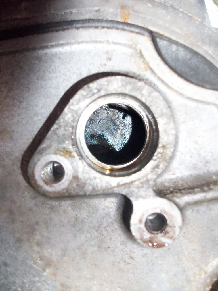

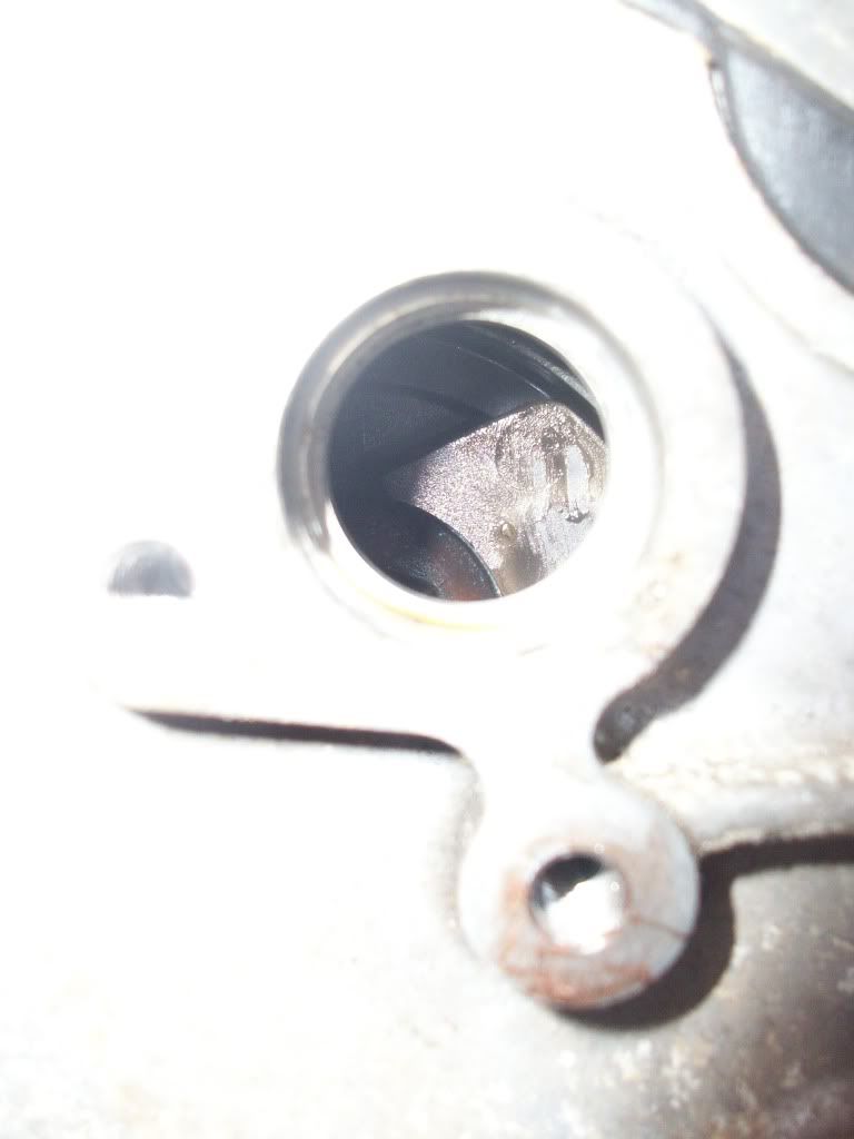

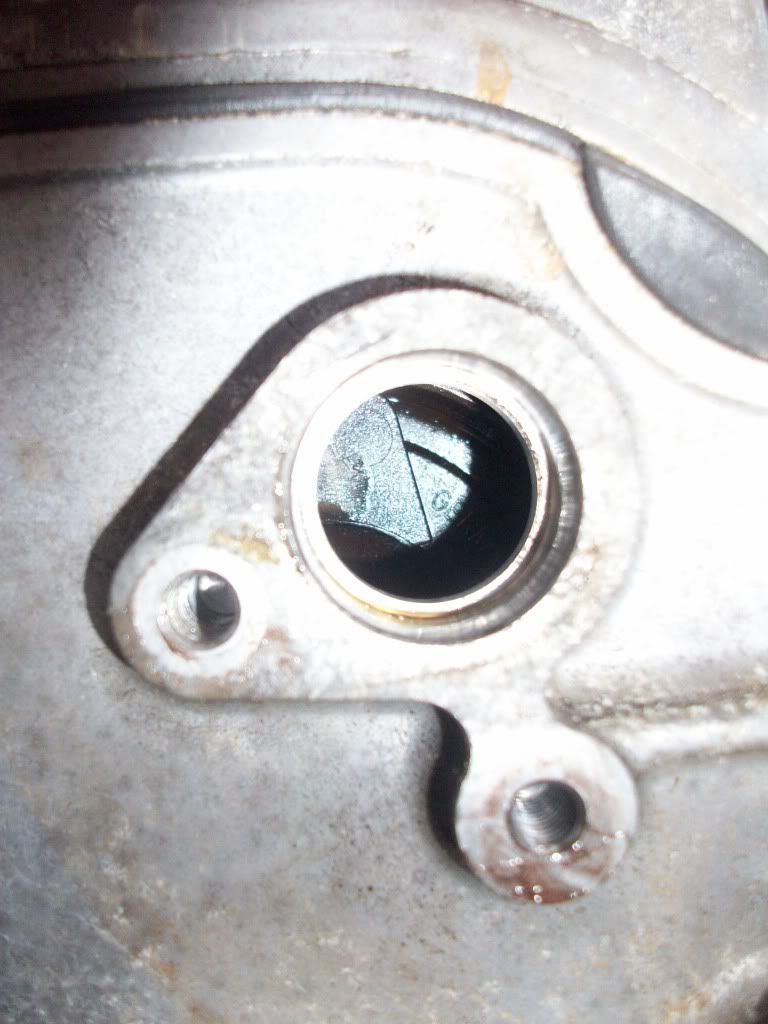

Back on subject. Having bought a sensor from someone else on ebay I proceeded to replace it. I'd read elsewhere that it was possible that the magnetic sender itself could spin on the camshaft having stripped its key-way so whilst I had the sensor out I checked to see if you can see it through the hole. You can and this could be very useful if anyone else has the problem.
Here is a photo with the sensor removed and the magnet not in view:-
These are photos of the magnet partially in view:-
And this is a photo of the magnet fully in view:-
I was able to stick my pinky into the hole and try to move the magnet. I couldn't move it so I guess that confirms that it is OK.
