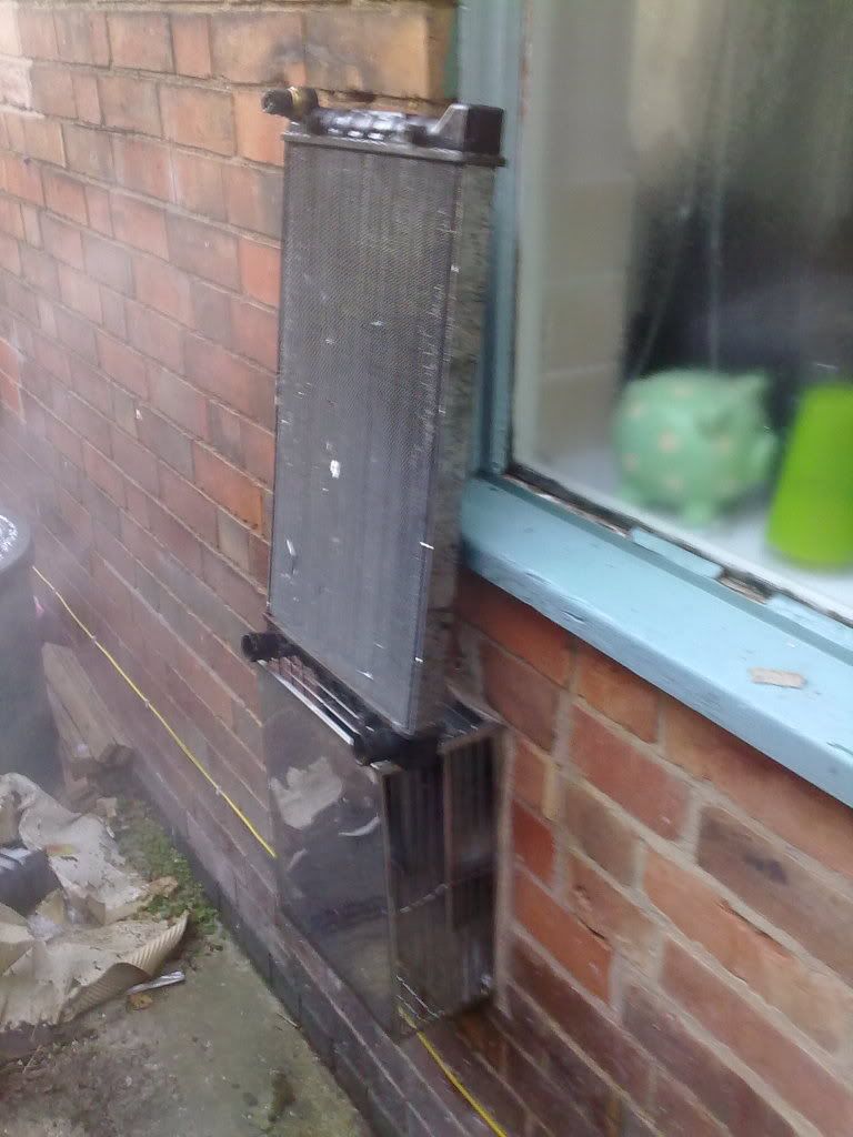

Yer i was thinking about the matrix this morning, gonna bring the rad inside to thaw and pop to a garage to see if they can pressure test it and look at trying to get to the waterpump (not exactly alot of space in my car cos of all the pipework). Although I do have confidence that the waterpump never actually froze. Will check my core plugs too.
After i have done all this is it recomended that i start my engine to let it all thaw, obv keeping an eye on it all?
P.S found a good way to de-frost my rad, central heating on, rad on top of outlet, me sat inside warm
