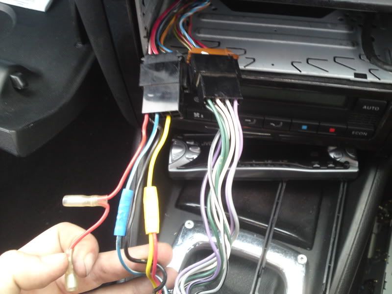

I've just purchased and fitted an alpine double din headunit into my mk4 golf but its not turning off when i turn ignition off and remove key  :undecided: any ideas?

Most likely need to swap the red and yellow wires around (I think)
I know it involves swapping wires but not 100% sure of the colour
Have a search as it has been covered before  :smiley:

i had the same problem with mine they did need swapping over is there no 2 wires with plastic covers over 2 connection that look like they can be disconnected its what i had to do.

Sorted! Rhyso you were right originally  :laugh: thanks for the pic aswell GrandMstRamRod. Thank you both :kiss:
Lol knew it was something simple but I never had to do it myself.  The Pioneer h/u i had was a straight plug and play  :shocked:
Just seen the pics of it - looks smart :afro:
