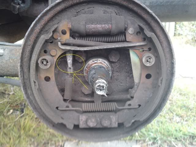

ive changed the shoes and its no different and dont remember seeing any ratchet thing of any kind wen taking them off
the only adjuster inside the drum is the one circled which self adjusts

Those self adjusters rarely seem to self adjust immediately when they're put in again... Takes a bit of trial and error getting them moved manually.

so i shud just hav a fiddle with that adjuster before spending money on hanbrake cables, only want it to get me thru the mot as im after a new car after xmas
Just make sure you slacken off the cables before you begin ;)
