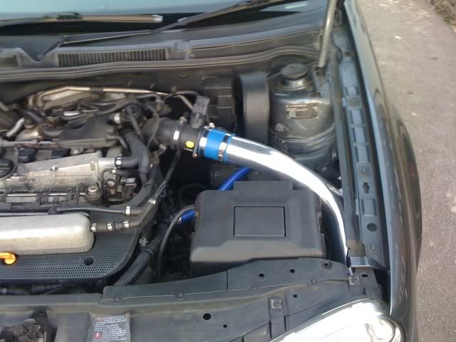

just fitted my CAI (pics to follow shortly)
love the sound of everything
but im highly upset about the power i have LOST thts Right i have ***LOST POWER***   why is this it just doesn't seam to boost the way it used to ....
ANY IDEAS PLEASE REPLY

unplug your MAF sensor if it drives better unplugged then thats your cause simple fix really. if not check the y shaped breather pipe to the right of the engine cover for splits and if there ok get the car vagcom scanned for fault codes  :smiley:

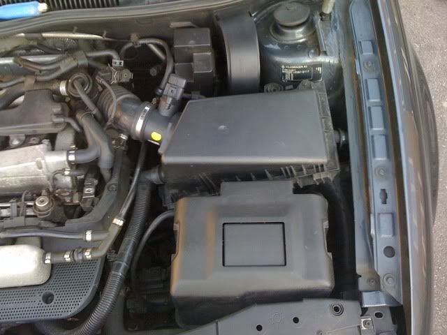

CAI BEFORE AND AFTER
