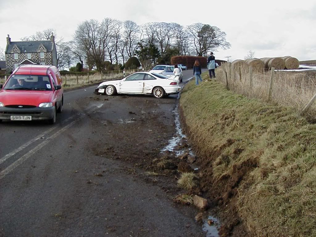

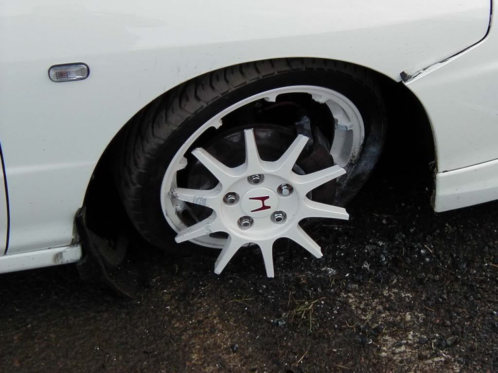

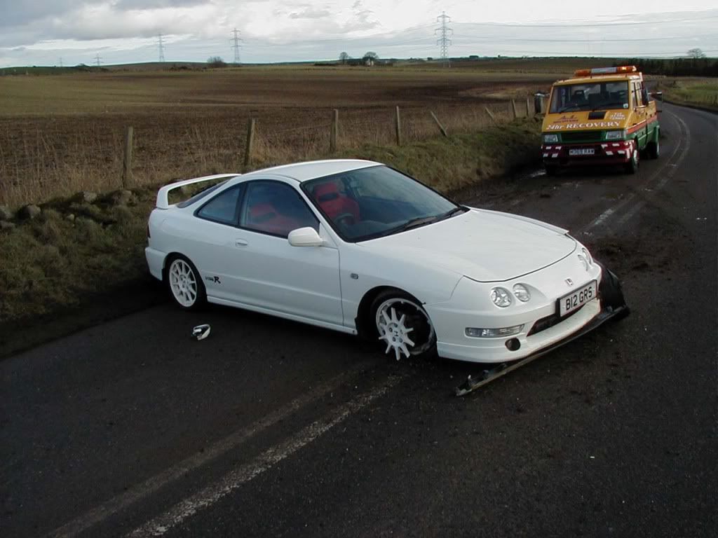

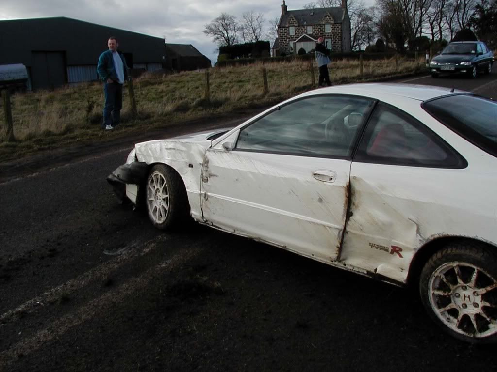

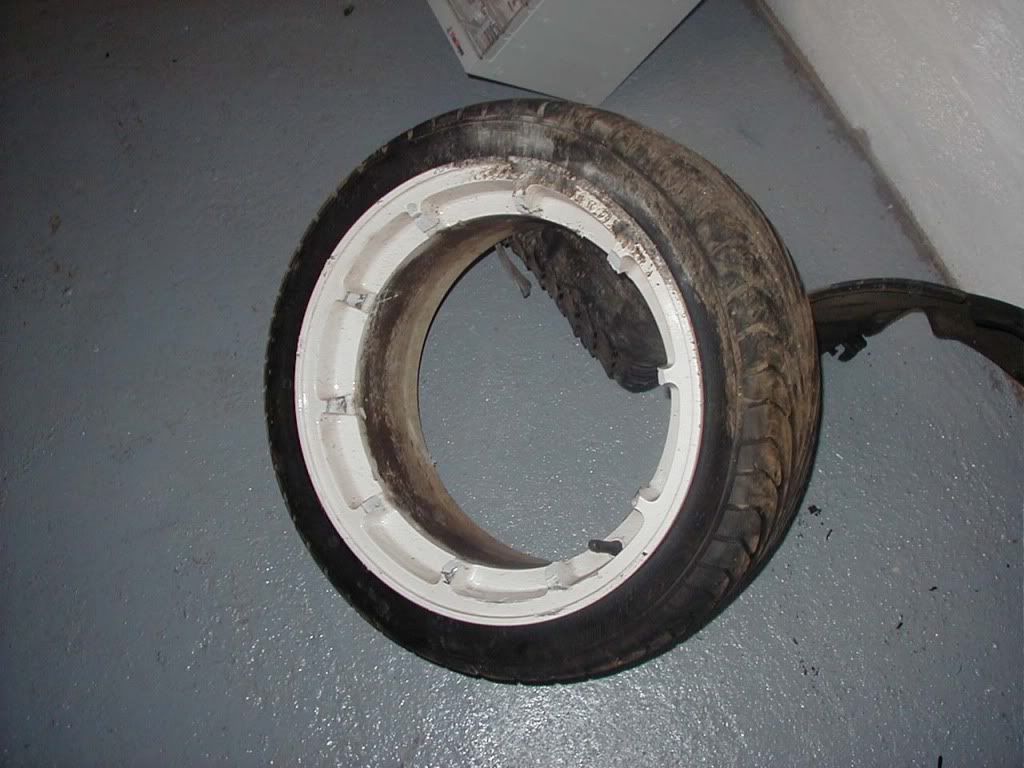

An example:
An Integra Type-R clips a verge at nearly 120 MPH, and rattles the verge hard, flipping over and breaking a wheel upon landing:
Tyre still inflated - despite a roll at over 100 MPH.
...and you think unbolting the centre of an RXII will collapse the rim?
I've been repairing and re-furbing RXIIs (and smacking ITRs into verges) for 10 years and had plenty apart with and without tyres fitted.
They don't collapse.
Just trying to pass on the facts.

Fook me, you were lucky! What did the rest of the car look like??  :shocked:
Offline Ess_Three
  • Posts: 3,123
Re: BBS RX2 question
« Reply #9 on: 13 September 2010, 05:55 »
£16,500 worth of damage...and a sore head (an even more sore wallet came later!)
Regardless, it's clear from the pics that the wheel rim will not collapse with a tyre still inflated on it, even if removed forcefully from the rim...and they were featherweight Enkai alloys, not heavier, stronger BBS alloys.
