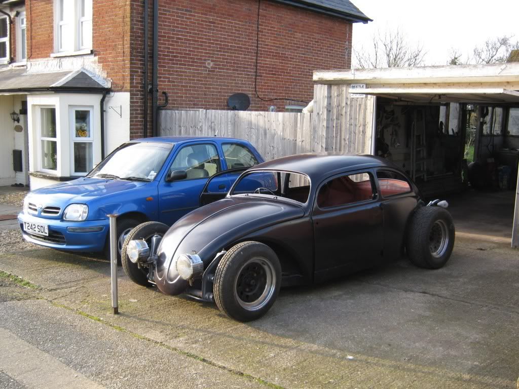

Really like this one too

That one looks awesome :)
What he said....... Won't be long until this one looks as good as or even better!  :cool:
How do you get on with no guards over the wheels? Does it pass mot?

Mine will have guards of some sort, but it's not an mot thing. It's a vosa / traffic police rule that it must have covered tread of a substantial amount.
As far as I'm aware anyway.

Some caterham style guards would look quite cool...
