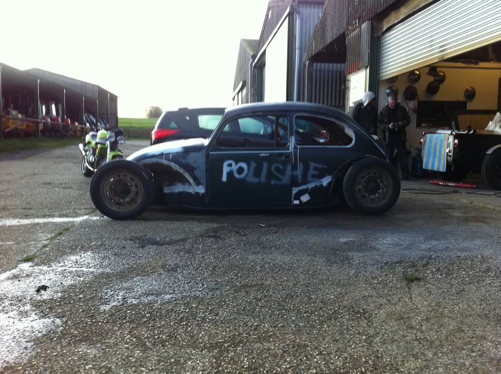

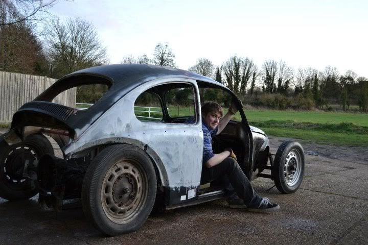

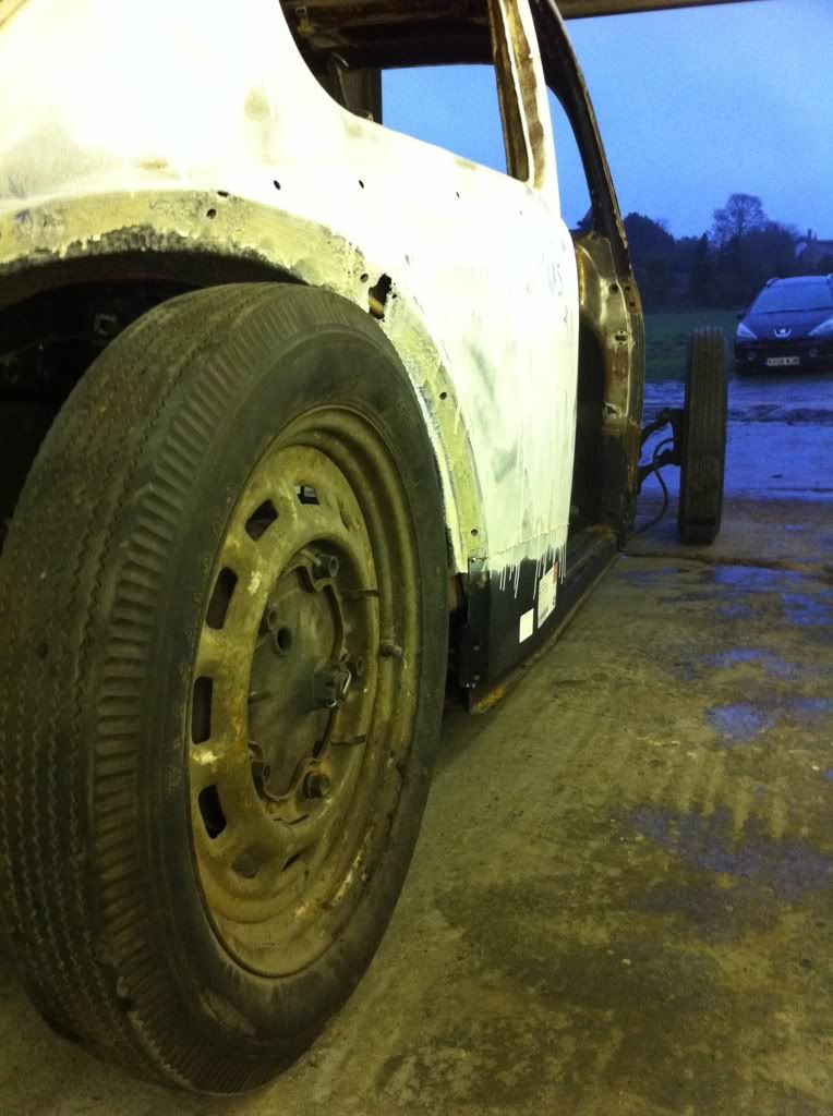

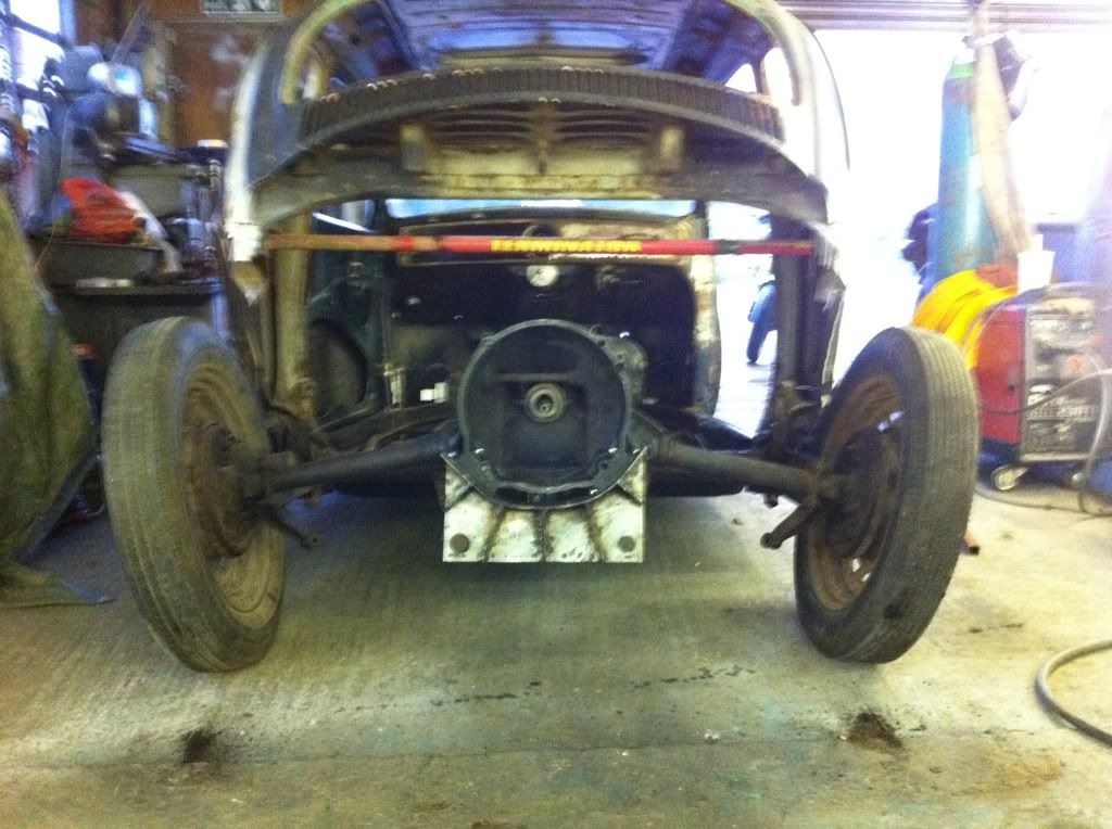

Fun day today = stance fail. Putting it back on it's wheels threw up an overlook on my part. By raising the box it didn't leave the spring plates with enough travel to move h
Which made the rear wheels have loads of posi camber.
Floating in the air!
Back on it's wheels - stance fail
Where it needs to sit ideally
Backs need spacing out a bit but sitting cool!

Should leave it, lots of positive on that almost looks like inverted VIP style.  Bet that's worth loads of scene points.  :grin:
Feck going round corners in a hurry though.

Haha! Yeah - apparently the beetles can tuck under savagely anyway with no camber on a fast bend.
It's interesting getting in and out of it lol. And will make for an interesting drive........
Need a set of front coilies if anyone has any - any fitment will do!

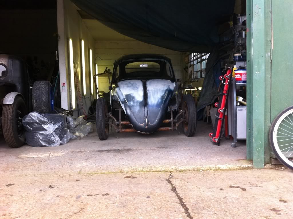

« Reply #259 on: 02 January 2012, 20:10 »
Yoooooooooo!!!  :cool: :cool: :cool: :cool:
Temporary fix, but cool to get it rolling!
