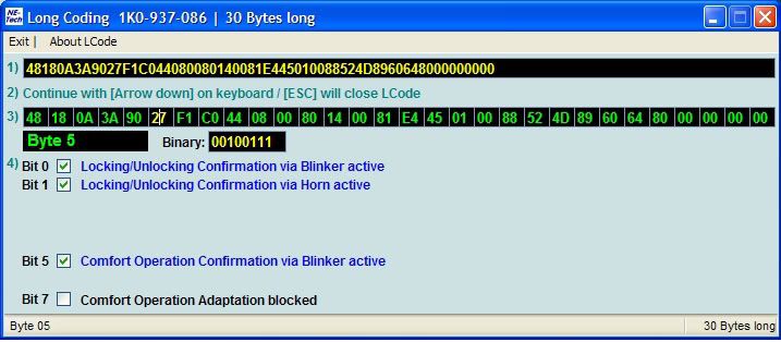

I have tried again today.  Here is a snapshot of the screen:
This image shows the tick box ticked for confirmation via the horn, but it still doesn't work!  Any ideas?

I have just checked mine and the same Byte has a couple of extra bits defined.
The important one is Bit2 Horn Confirmation Adaption Blocked.
If this is set then setting Bit0 and Bit1 will have no effect.
Check to see if this definition is in one of the other bytes as I know it was in the MK5.
If not you could manually clear the bit, as yours is set, by setting the value to 23.
The only thing is that my controller seems to be version 'C' compared to yours so not sure if it will work.

Many thanks for that. I'll go and have a look for the horn adaptation box and make sure it's not ticked.

Well I think I have pretty much tried everything. I tried to manually change the coding to 23. It accepted it but didn't work. Trawled through the net and came across people with similar issues who suggest either checking the cabling to the secondary horn (didn't know there was one), make sure all the doors are locked and bonnet shut. Even if the cable isn't in correctly seated in the radio could cause the cheep not to cheep!.
