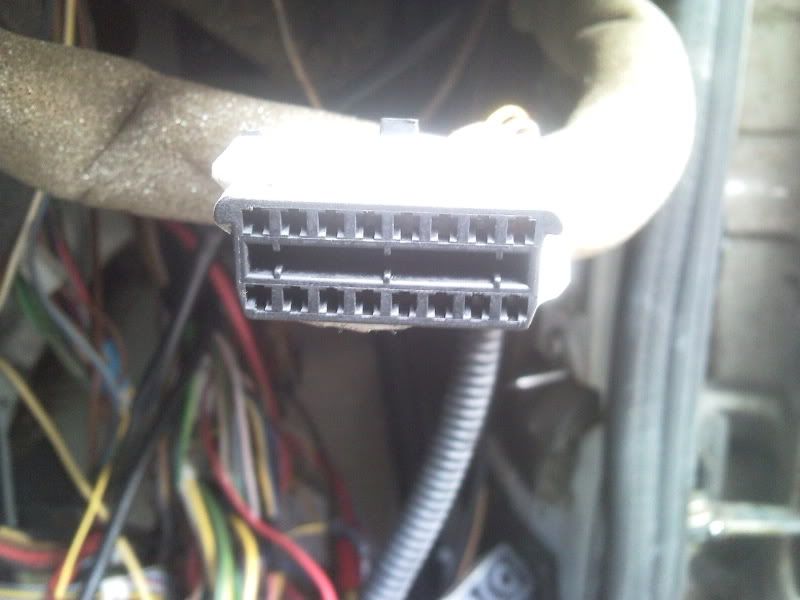

little update not sure wether to go this route or not but looks quite strange in a mk2
now were to mount the com port ?

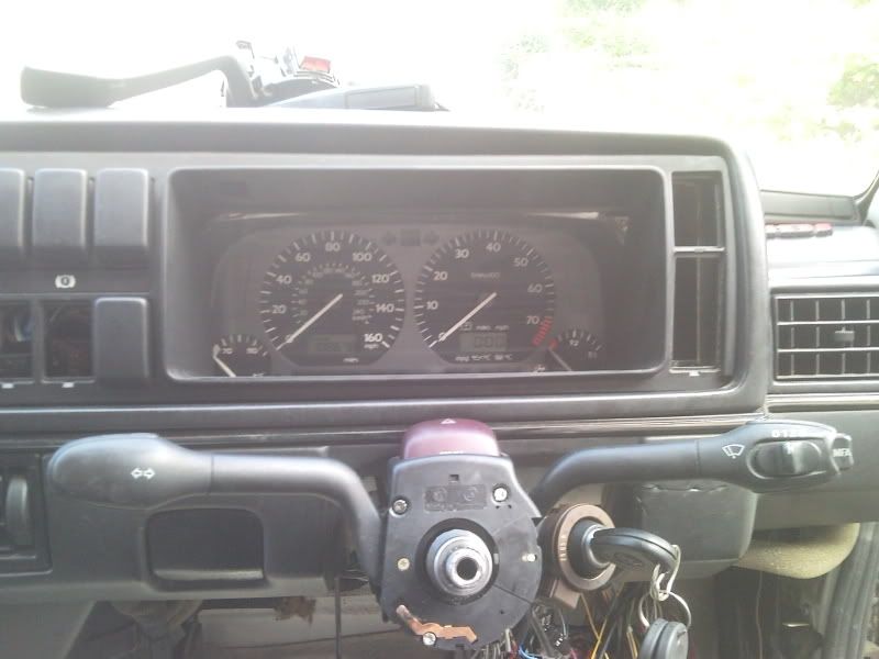

also fixed the steering column and we now have mk3 key with immobiliser ring  :)
