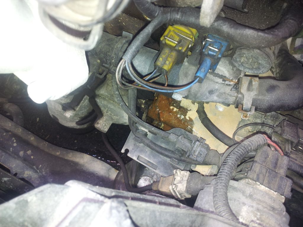

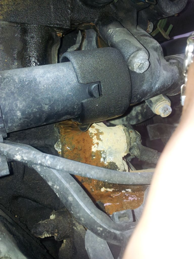

Can anyone help with my water leaking issue?

Id try taking off the thermostat housing, splitting it and re-sealing it.. and sealing the housing to the block. Other than that you may aswell get a new housing. Mines been slowly leaking since i rebuilt my vr 2month ago  :grin:

« Reply #1109 on: 05 July 2012, 12:28 »
get the alloy replacement, worth the extra buck as far as I'm aware..
