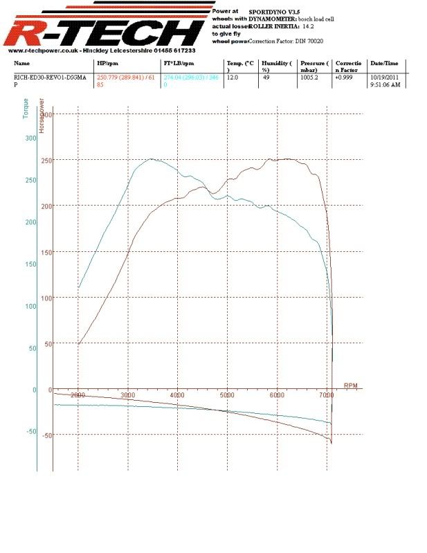

Adam,   Its the engine pulling the ignition back ready for the DSG to slip in to the next year, as far as I know the transition between gear changes is done without boost reduction, only timing reduction to reduce engine load to allow a smooth shift.....ie full throttle gear change. :smiley: I have not do much logging with shift points and how the act on the engine mapping.
Only way to get rid of the dip is to remap the DSG ecu and get rid of the auto shift point in manual mode, which then will rev to the engines rev limiter over 7000rpm.
Here is what they look like with the DSG software upgrade.
Revo Stage1 DSG code on a Stage1 ED30.

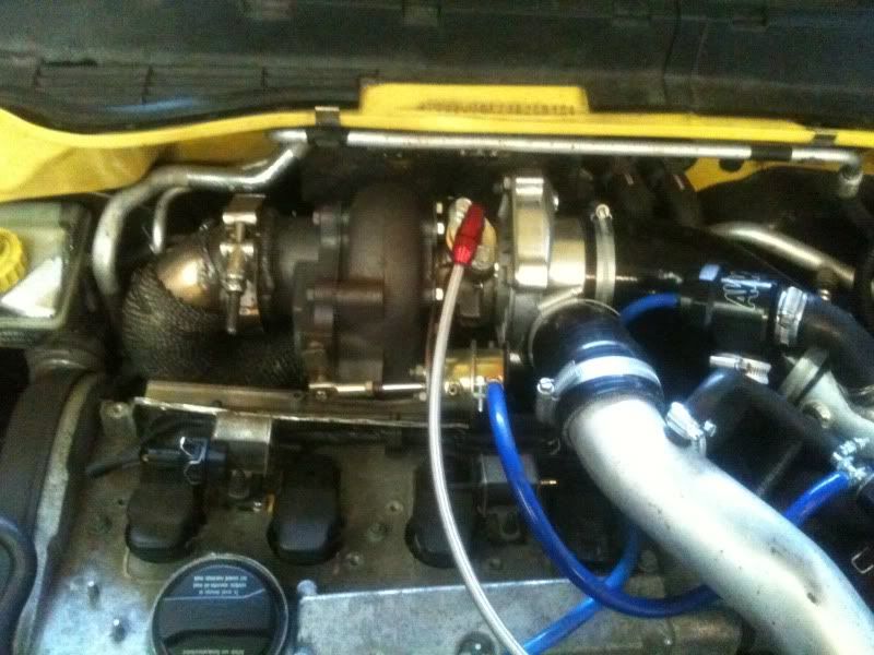

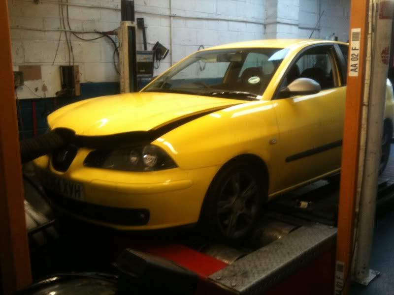

Nice project just before xmas R-Tech Custom Stage 3 remap session.
Seat Ibiza AYP 1.8T 20v
Turbo Back exhaust
FMIC
3" TIP
440cc green Bosch injectors
S3 210 MAF
4 branch manifold
T304E stage1 .48 Turbo
Stock rods and Pistons

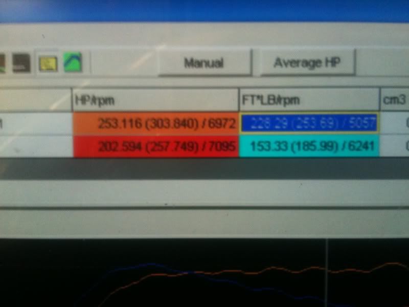

Final Numbers limited by stock rods made 303bhp @1bar boost set up on the stock N75 valve.
The car feels awesom to drive, relentless power which is very strong and linar and not too laggy, off boost it feels like a very healthy 2.0 16v engine, but on boost its grin grin grin... :grin:    I think this is the way some of you guys should be going.  The turbo only cost the guy £370 with manifold.. :wink:
