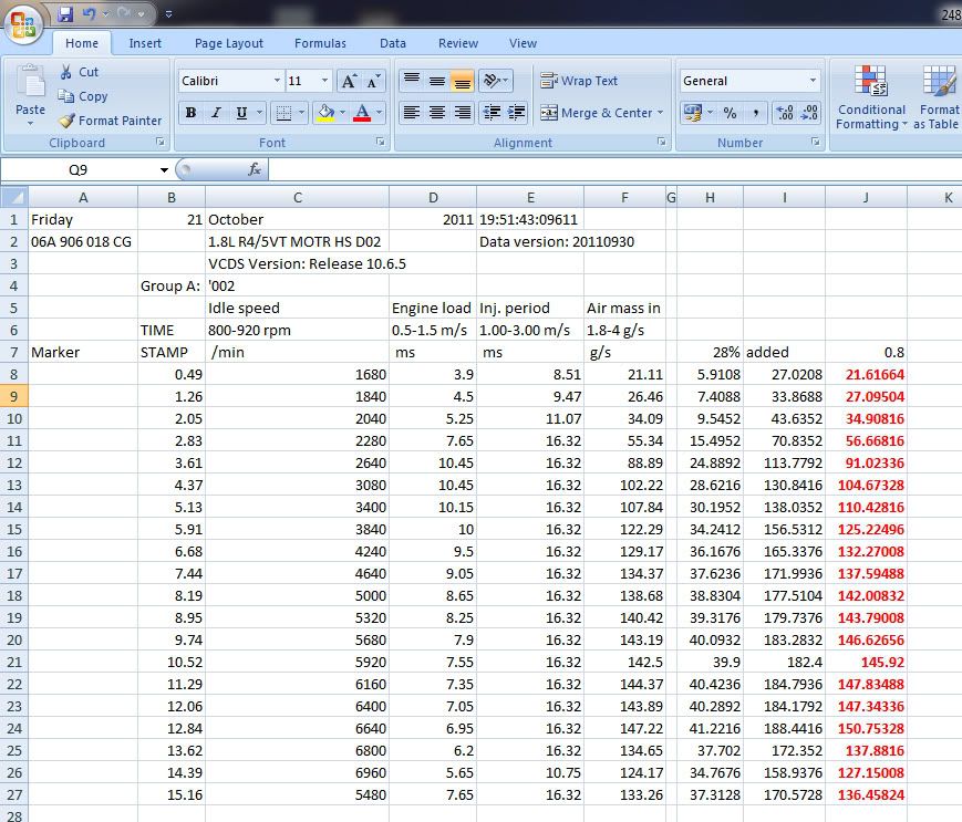

its actually 70mm,  I was measuring the square filter end which goes into airbox.  (that side is slightly bigger.
so the VR6 MAF is 28% larger. :)
I think when I worked it out it came to 28%.

I just worked it out using 62mm and 70mm and I got 28%  :nerd:

Well working on a 28% increase we get
Suprised suprise....near enough exactly what the dyno says!

In the map software the peak stock maf flow 0-5v scale works out at 673kghr which works out at 186.9444gs or around 240bhp on a dyno reading.
 The bigger maf is used to rescale the whole map to allow for a greater scope for performance, at the same time is the correct sized injectors are used to match the maf % gain then global constant for injection on tiime vs air flow will be correct, which makes the mapping easy by just rescaling the the load axis on the timing maps.  It only on the AGU we need to work this way.
