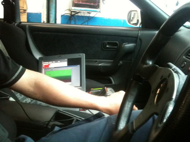

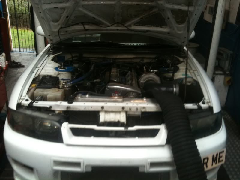

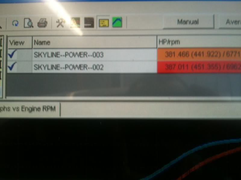

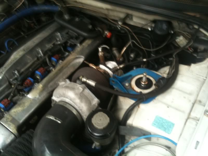

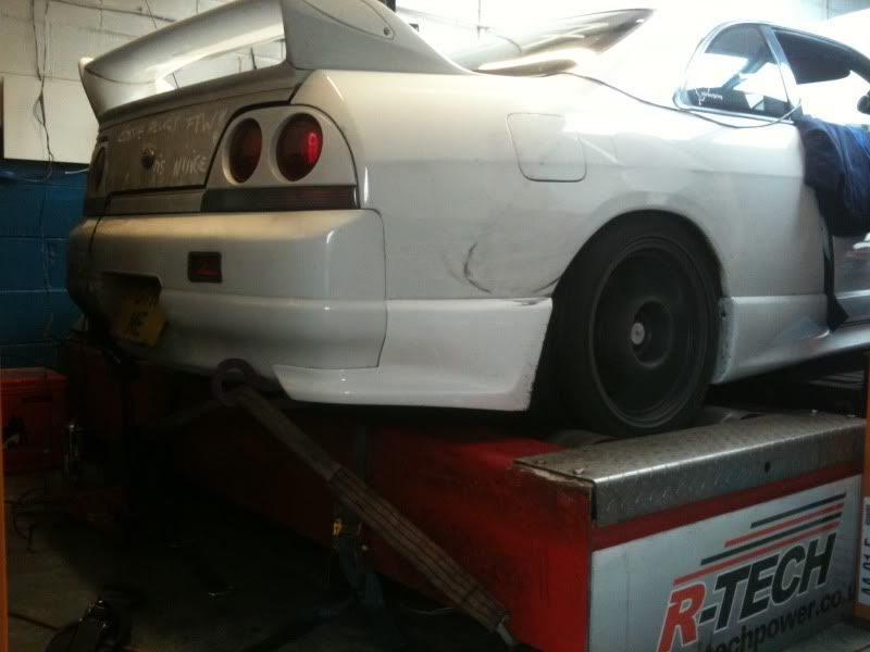

When we first had this car in 2 years back it was kicking out around 300bhp limited by hardware issues, related to fuel flow and ignition coils.  A few live dyno/road mapping session ealry on this year gained around 340bhp, then over the last few weeks tuned to 440bhp limited again by fuel flow (crap complex nissan design)  So the 044 motorsport fuel pump was fitted.
Todays live mapping session (after spark plug issues) managed a peak power of 440bhp @1.3bar as a starting block, After many steady state live mapping sessions we worked our way upto 577bhp timing around 21deg and 1.6bar boost.. :wink:
 But not the right day to do the road test... had enough of watching my 6 year old son drifting/spining his Bambino race kart this morning and planted it in the tyre wall at 30mph, so dont fancy seeing 577bhp leave the road.
This is one of the 10 cars we are taking santa pod next week weekend.. :wink:  Along with a 520bhp Astra Gte, Kadet 490bhp 11.4s 134mph, mk4 1.8T 410bhp, Mk1 1.8T 320bhp, my golf 370+bhp :smug:
First runs 440bhp
Runs between live mapping sessions
Videos
Close up of a tyre on a dyno at around 506bhp on this run.
Final power run 577bhp 1.6bar boost with 8000rpm
(to be uploaded off another phone)

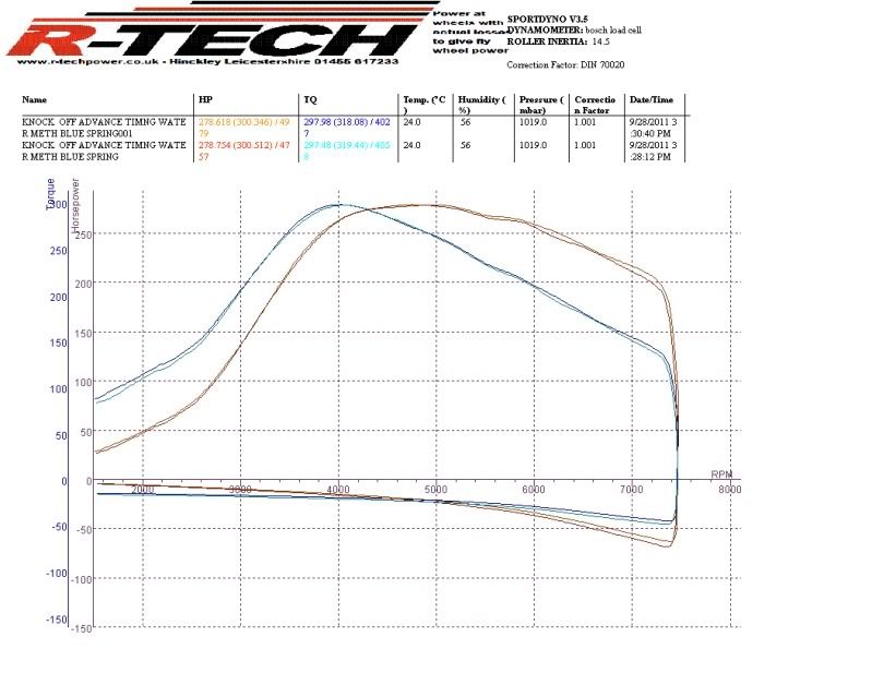

No wonder I thought my car was off its tits when I removed the Bosch IKC knock control strategy from my map and wrote the timing maps from scratch using det cat to listen for audiable pinking......... The results speak for themselfs.
