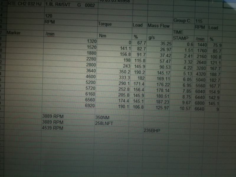

Now on a yellow spring.. :wink:
Mangaed to get the other comapanies remap removed from the ecu and back to stock, as started the mapping today 1.45bar dropping to 1.15bar boosting fine very very smooth curve..  Just finished the timing mapping then on the road for a test drive and logging..
Already at 187gs 235bhp/258lbft
Launch control mapping loaded... and tested. :laugh:
Brake and boost mapping loaded and tested.
Linear throttle maps loaded and setup.
WOT Gear shift mapping loaded just needs testing.
Going home in it to night to do some logs and have a play.

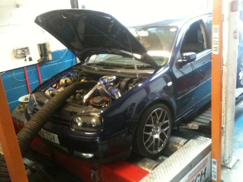

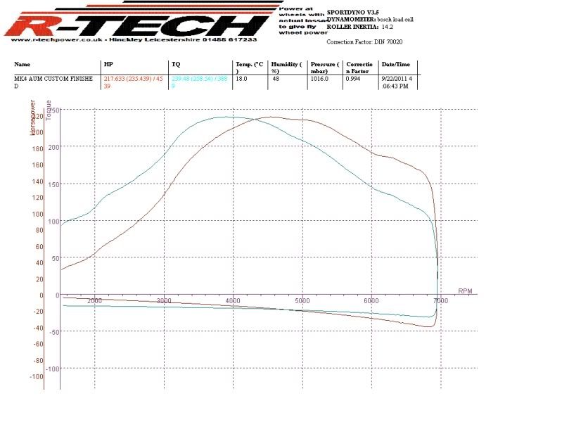

AUM 1.8T K03s - Turbo back - FMIC - TIP - 007P - Forge Actuator with yellow spring -
R-Tech stage 2custom remap with Launch control - Linear throttle DBW map - Left foot brake map - WOT gear shift map
Final session today 235bhp 258bhp.

Bloody hell....that IS smooth!
Thats what the me7.5 ecu is like with the Forge actuators, using the mapping to its best to get the load smooth...  Just shame the AGU ecu aint as dynamic.
Its amazing.  Probably one of the best graphs ive seen!
