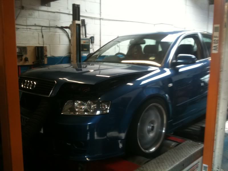

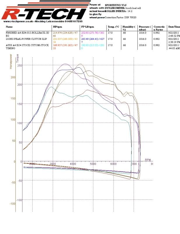

R-Tech Custom Remap SessionAudi2001 A4 1.8T 150bhp with K04-015 -  FMIC - BAM 380cc injectors - decat & turbo back, cheap DV stock air box and filter
First step
To spend 1hour getting the BAM 380cc injectors to run spot on to get the fuel trims are with in range, this involves a lot of trial an error testing with data logs vs fuel constants and correction maps.
Once the fuel was correct on a stock map I knew what ever I asked from the injectors when tuning they would respond in the correct manner (as long as fuel pump and oem maf stayed within range) and be safe
Next step:
knowing the 015 turbo (same as the K04-001 which I had been using for the past year) I know what the safe starting point load and boost request would be 190% around 1.3bar request, so I dialed the load maps to request to make around 1.45bar peak and 1.2 bar at the top end, plus at the same time set the lambda maps to provide 13.2:1 in the midrange and 12.1:1 at the top end (a little extra fuel to be safe)
 The first few logging power runs with the custom map came back with 191bhp 213bhp... which from 1.45bar peak and 1.2 held is very low..due to stock timing advance but was only to check the fuel and boost control
The next step was to setup the timing advance for full load conditions.. This is the bit which will amaze everyone, with the same boost and fuel the ignition advance managed to produce another 57bhp 58lbft 248bhp 264lbft.   I was still at the point of adding ignition advance until the clutch started to slip.. :angry:    We set the timing back to stop the slip and carried out more logs to find the max timing pull as only 2s & 3s CF (on 95 fuel) :shocked:
End result for the day was 234bhp 271lbft without clutch slip and 1.45bar peak boost, tomorrow we need to spend  2 hour on the road and dyno setting up the boost pids  to smooth the graph out, maybe try and induction kit to help the power after 6000rpm.

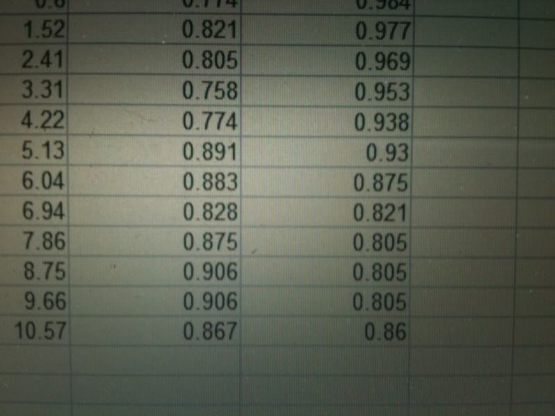

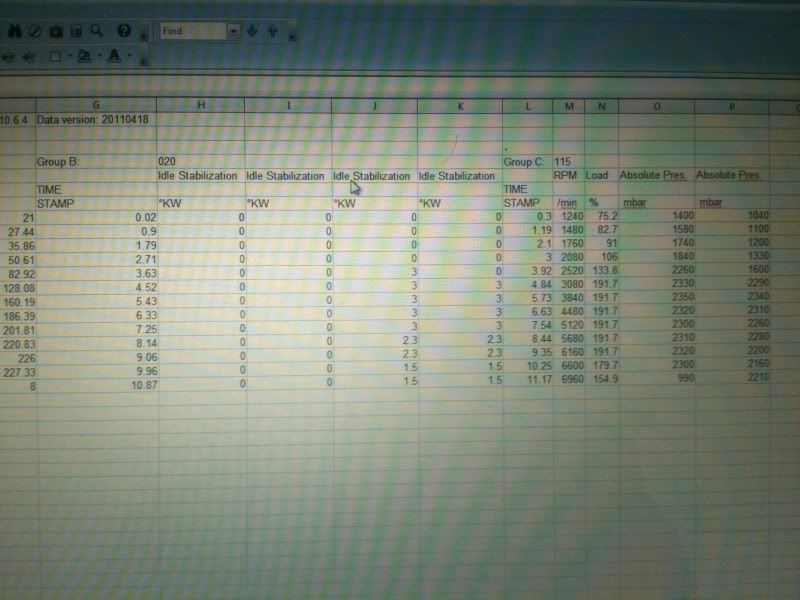

Bora Haldex S3 AMK engine K04 1.8T stage2 custom update..
After putting a few minor issues right after the engine conversion and sorting a major ignition pull at the top end on the stock map / stage1 base map.  We get down to the intense logging only to fine two more issues.... during steady state testing, which on a ramp test would not have been seen.
At this stage we are only at 270bhp 250lbft
Can anyone see whats going on?
more of a clue.   (with more load the pull will go to 7-9)
       13.3:1        v        11.8:1    linked with rail presure drop and
We found the car to be running the stock V6 fuel pump (which should be upto the job, but running it with 160,000 miles on the clock and at 4bar has taken its toll) John has managed to get a walbro inline performance fuel pump today, just need to find time and a place to fit it in the engine bay.
Problem 2 found:  Wastegate flapper not sitting shut/flush due to a slightly bent actuator mount,  The flapper was making a chattering shound idel which also makes the same sound as the clutch chatter,  but after holding the clutch in and pressing on the wastegate arm the chatter went and the idle air flow changed.  So a few turbo pipes to be taken off to get to the actuator so we can set it correct.
