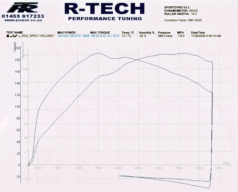

Quick update on my 1.8T with Rtech remap.....
I took my 128k mile AGU to R-Tech at the end of November 2009 for their standard Stage 1 remap. My car is stock apart from a Forge 007p DV.
Pre-remap, the car made 160hp/160ftlb on the dyno. It showed no fault codes. When the map was put on, the higher level of boost highlighted a leaking intercooler connection pipe which Chris and Ben quickly fixed. They ran the car again and it made 189/209. This was with the standard green spring in the DV, Chris changed this for a yellow spring, ran the car again and it made 190/210. Thats an increase of 30hp/50ftlb !
I'm really pleased with the change the remap has have made. The car is far more responsive and pulls harder and from lower revs. I was after more torque, and that's primarily what i got.
The car has now done 146k miles and (touch wood!) has never missed a beat. There's no oil leaks and no issues, its just like it was when i left Rtech almost 2 years ago. I'm currently looking for an early Mk5 GTi and based on how impressed i am with Rtech, i'll be taking the car for a remap with them with no hesitation. I wouldn't even consider going anywhere else, even though there are places much closer to where i live.
All in all a real bargain for the quality of service and product they offer.
Cheers fellas, keep up the cracking work!

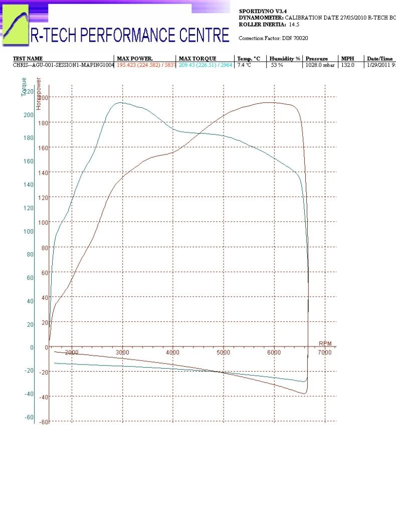

Engine Code: AGU
k03s
stock 710n dump valve
THS FMIC
3" decat downpipe
Forge Silicone TIP
Pipercross Panel Filter
De-silenced mid section
remus backbox
Recently rebuilt 20v lump
Made 225bhp and 225lbft torque.  Torque was limited with dump valve cracking open and maybe actuator too.
Those were sorted out and following put on
Forge 007p with yellow spring
forge actuator with yellow spring
3" cold air feed
new N75
and sorted a few niggles out.
Went back to r-tech and custom mapped again on the dyno, got a lot more torque, now 265lbft at about 3k rpm and the same power due to the AGU injectors running flat out and becomming lean at 238bhp on the rollers - hence the pull back in power.  Amazingly quick car in the mid range and feels like a rocket.
Now to get the injectors in and 2.75" ID MAF housing stuck in and get booked back in and see what power we can get from AGU k03s.  Hopefully into the 240s should be pretty easily obtainable.
