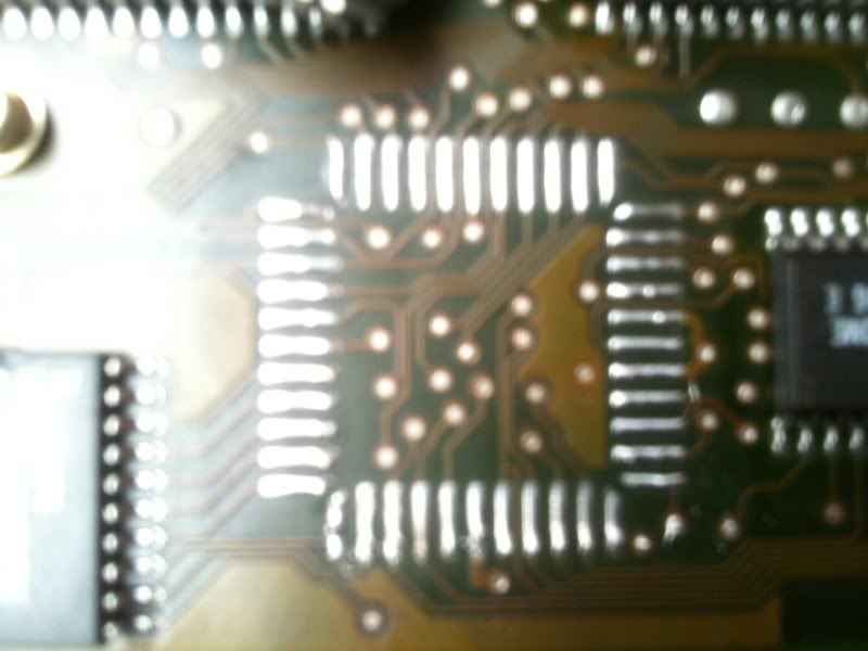

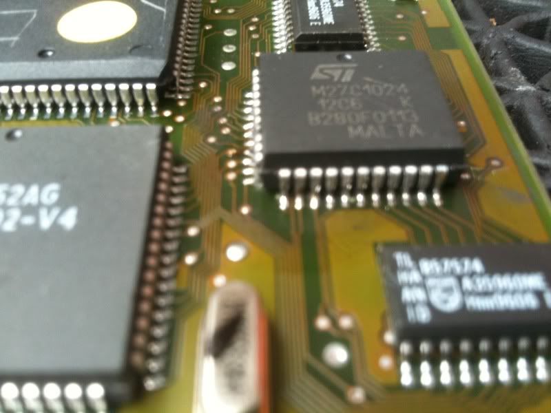

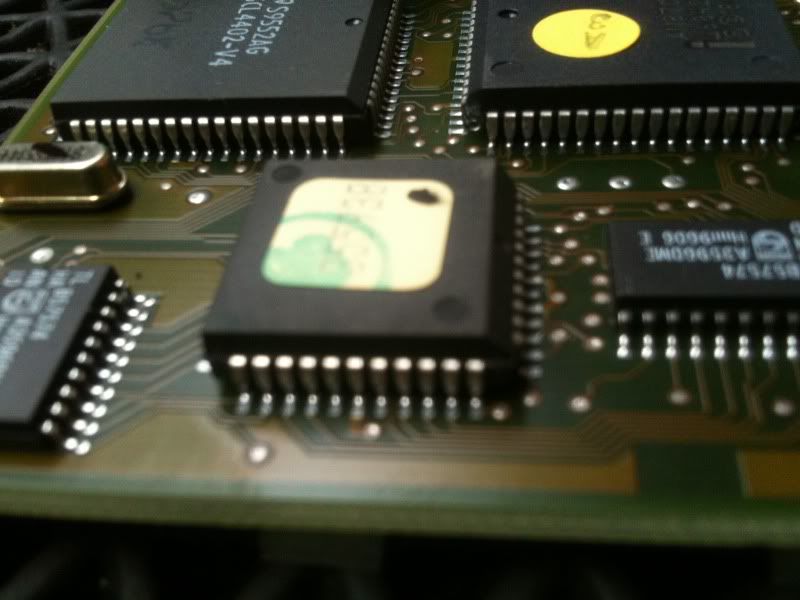

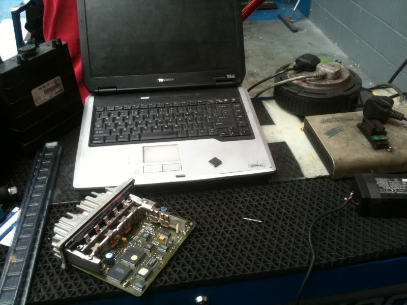

ECU Chiptuning Remap method on a 1996 Mk3 VR6.
ECU out Stock PlCC44 Bosch chip still in place
Chip removed
Edit stock map code and write to a blacl PLCC44 chip
Fitted chip with R-Tech map code.
 01455 617233
