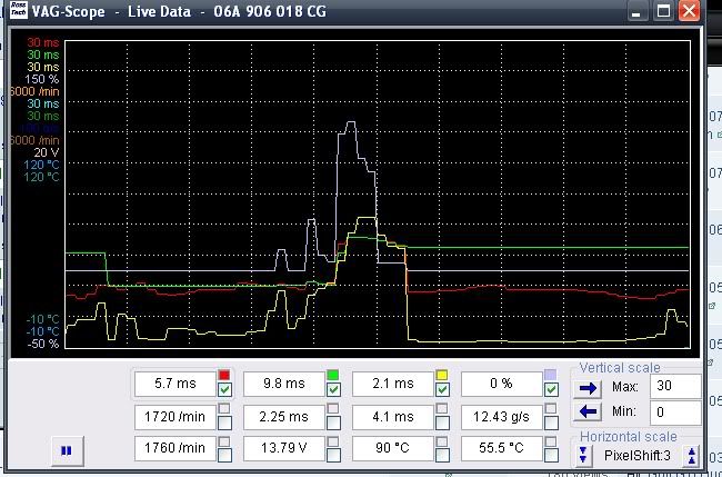

Here is the log from said run too
Anyone see anything untoward?

need the csv dude you can't learn much from a vscope plot without labels
Which variation of 00575 are you getting as there are 3? exceeded/not reached/control difference. Sorry to say it's the agu equivalent of 17705 and all the over/underboost codes all rolled in to one :grin: the logs might help pinpoint it a bit

nice one mate I'll have a good look around it later
Toph I thought I had saved the logs at the same time as the graph but it seems not (serves me right for trying to operate the laptop while driving up the road  :grin:)
I'll have a good poke around later, just what I need though lol
