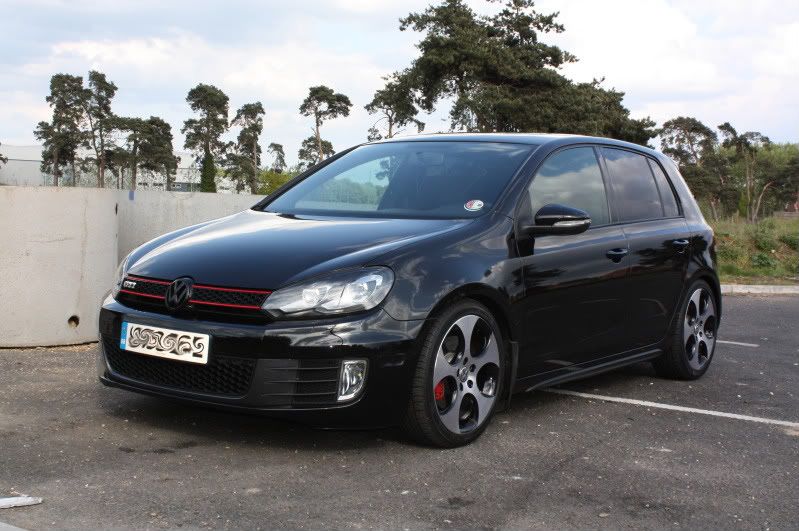

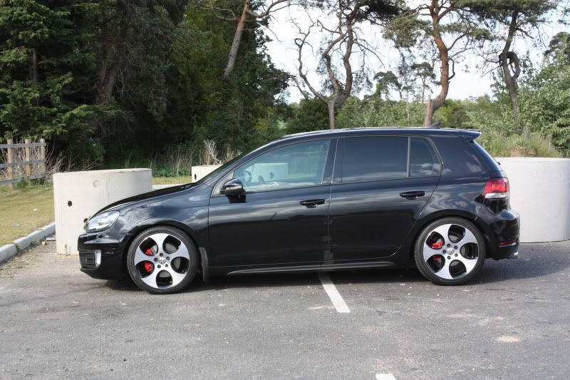

What did you replace the springs with?
How does it ride?
And most importantly.......pictures.....it'z da rulez!  :smiley:

H&R Sports
