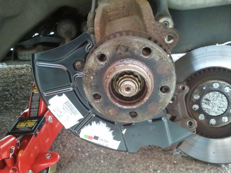

yeah they were new not long ago mate. It looks like it's the design of the TT arms/ball joints as they have longer studs and were never meant to be fitted with the 288mm splash guards.
I'll try and get a pic of how close they are  :smiley:

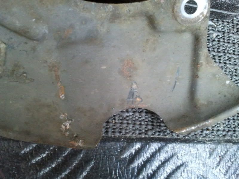

Been out today fitting the splash guards, I really hate roadside engineering  :undecided:
Anyways here is the evidence of the ball joint studs touching on the 288mm guards
you can see the witness marks either side of the cut outs, not massive but I can't tell you how annoying it was

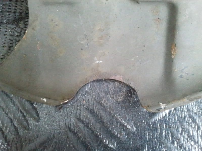

and the 312mm guards fitted
Took it out for a quick blast giving it full lock in both directions with no noise or rattling so a complete success  :smiley:

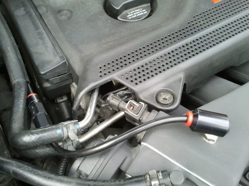

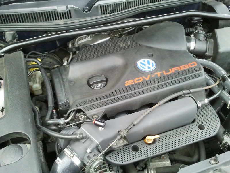

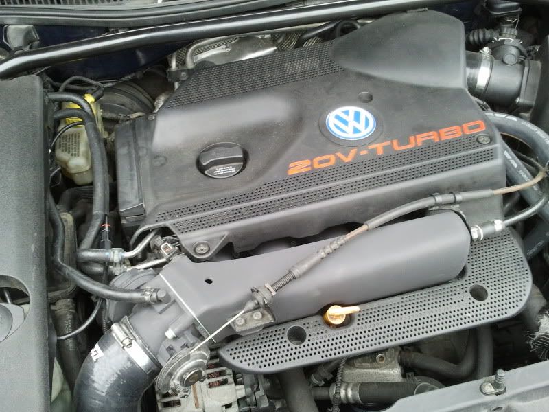

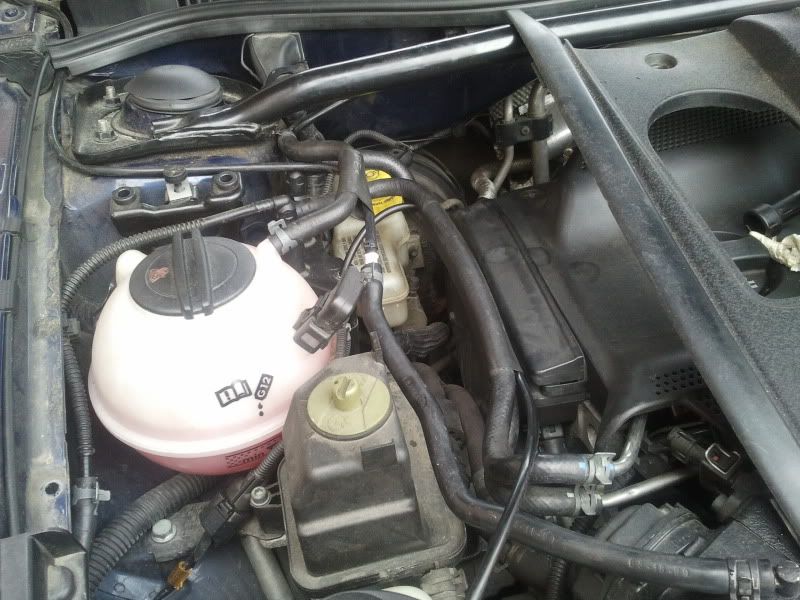

The meth injection is in  :evil:
Not had a chance to test it yet but I'm sure I can do that on the way to Inters tomorrow  :wink:
Some pics of the fitting

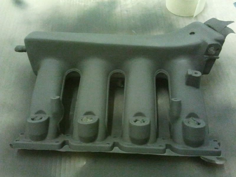

Decided to spray the inlet manifold and throttle housing matt black as opposed to satin this time
Pump and level sensor wires routed under the carpet from the controller

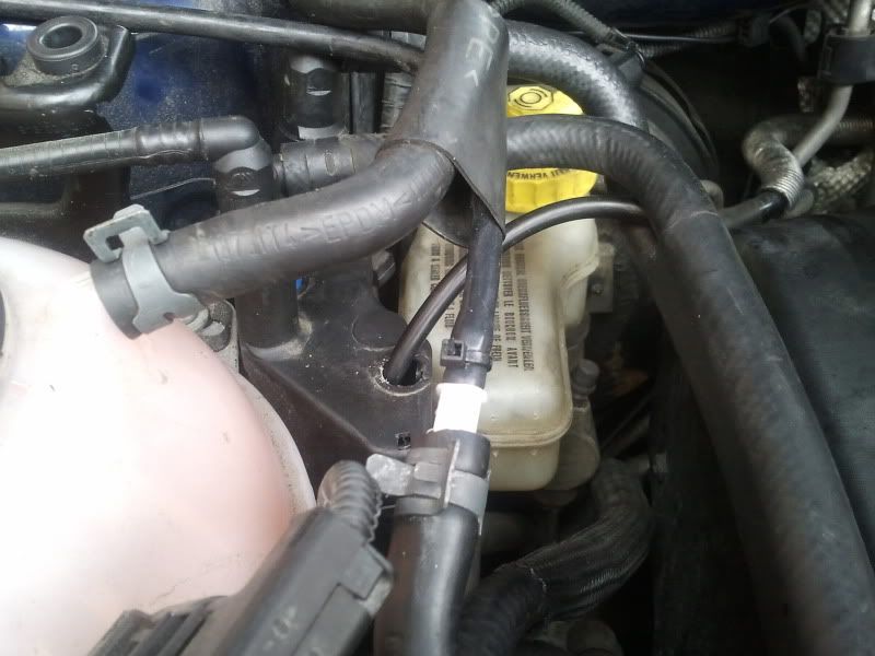

The feed pipe from the tank routed with the fuel pipes
The pump living its new home

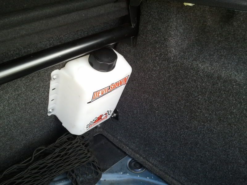

Tank mounted on the back of the rear seats

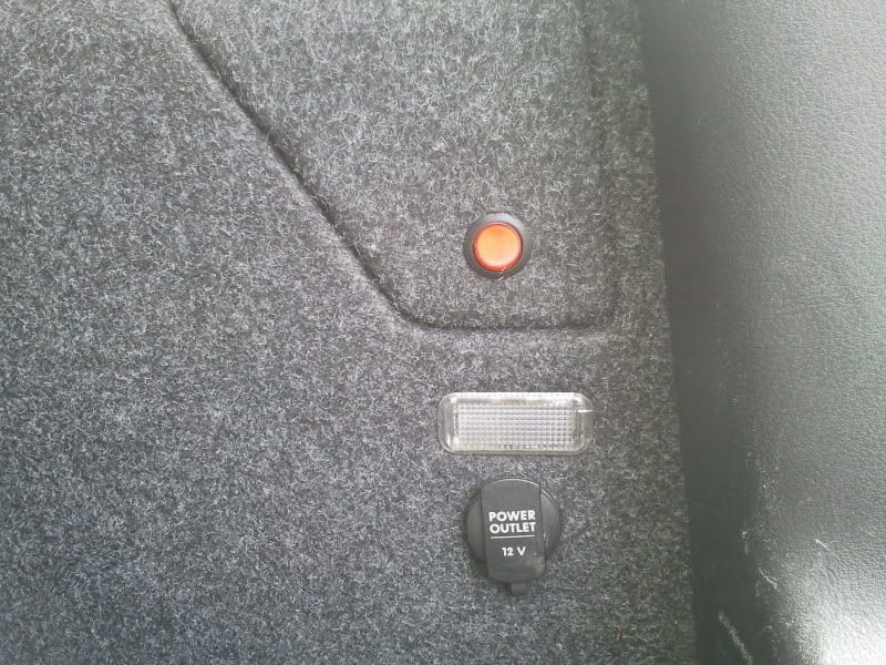

I've rigged up a rocker switch so the pump can be isolated if needs be. All feeds are also fused with a 20amp blade fuse

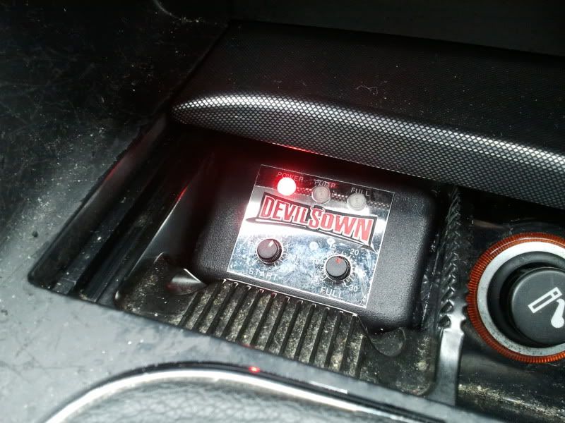

The controller is alive...
Inlet manifold fitted
And the nozzle installed
Just got to fill the tank up this evening and prime the pipes. I'll also be getting a level sensor to install in the tank at some point.

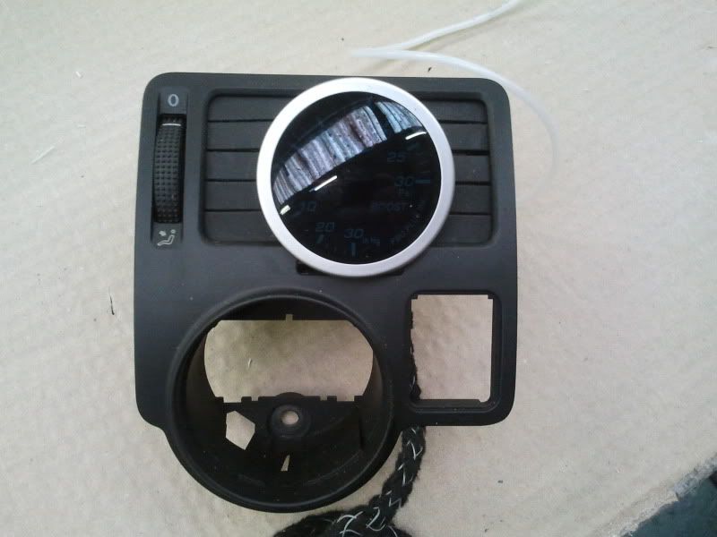

Another little thingI've been working on is fitting a boost gaue to my Bora vent and this is the result
Not too bad if I do say so myself  :smiley:

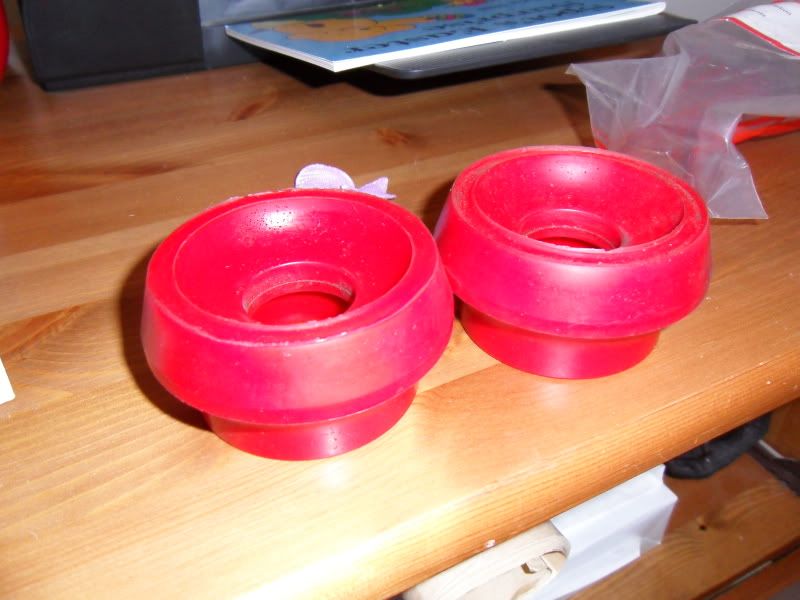

I've also bought these PSI Tuning poly top mounts which will be fitted soon
