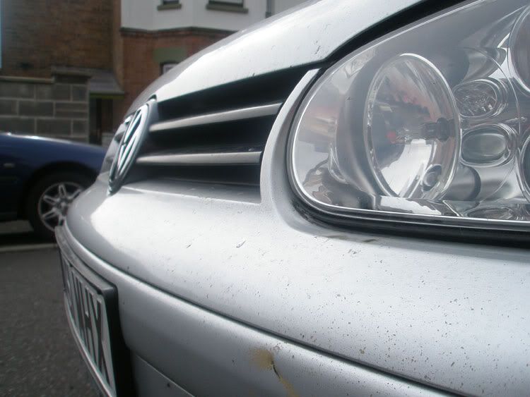

So after reading bits and pieces on here I decided on these products to hopefully bring my paintwork alive again. The main problem with my paintwork is little black spots all over it which I'm guessing are spots of tar that have built up over the 150k miles that my car has done. I started off giving the car a good rinse off as I think it had some of that volcanic ash on it from when it rained saturday morning. I then washed it with the Born To Be Mild and dried it off.
At this point I was quite excited as I was going to us the magical claying kit that I had read so much about. I was hoping it was going to remove all the tar spots. Now I don't know if I was doing something wrong but the clay was a slight disappointment for me. Don't get me wrong, the bits of the car with out tar spots came up lovely and smooth but it just didn't seem tough enough to remove the tar spots. I found my mircofibre towel removed them better with a bit of elbow grease. Was I under the wrong impression of the clay? Does it not remove tar spots or does the kit I have come with a soft clay that ain't tough enough for the spots?

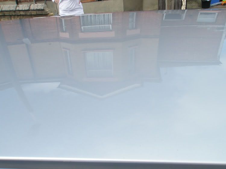

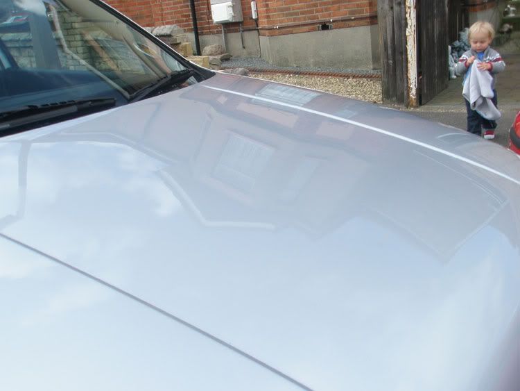

As I said tho the rest of the car was looking and feeling lovely. I then gave her another wash and dried her thoroughly. Then was the turn of the Light Fantastic wax and soft foam applicators. Loved using both of these! The applicators applied a nice even layer of the wax. The wax itself smelt amazing  :grin: and went on really easy. Was also a joy to buff of, compared to the Mer polish I had only used up until today.

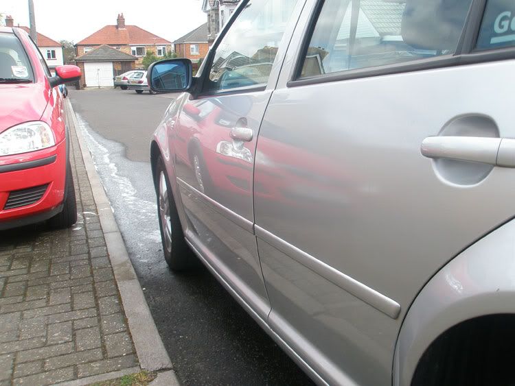

Can you notice the dodgy finish of my rear passenger door in the photo above? I think it's been resprayed before I got it and not to a very good standard.

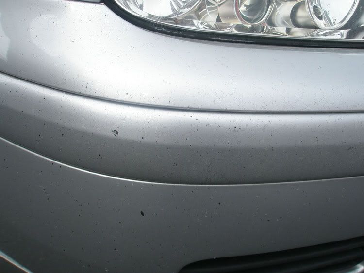

And now examples of the tar on the bumper:

yeah... your door needs a machine polish, with any luck this will improve the finish
the tar spots you need to treat with tar remover.. can highly recommend autosmart tardis. spray on, let soak and then remove with minimal/no elbow grease  :cool:
