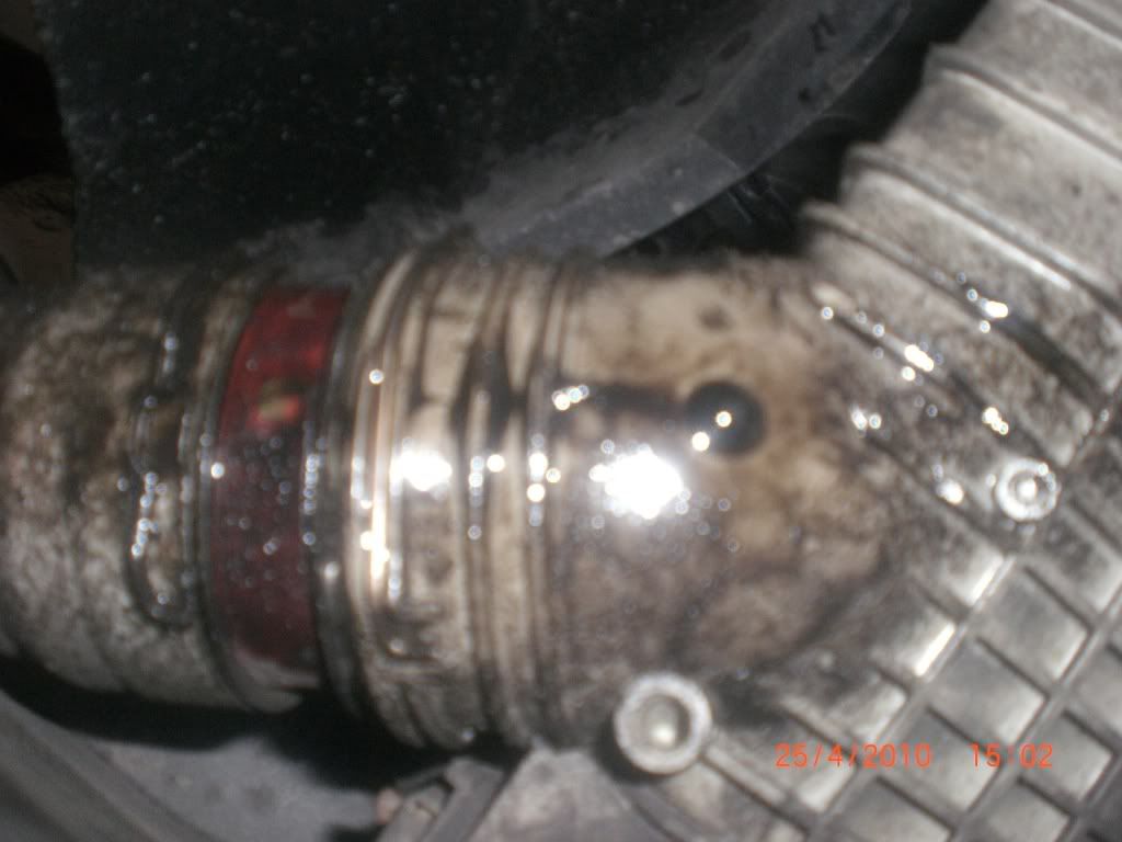

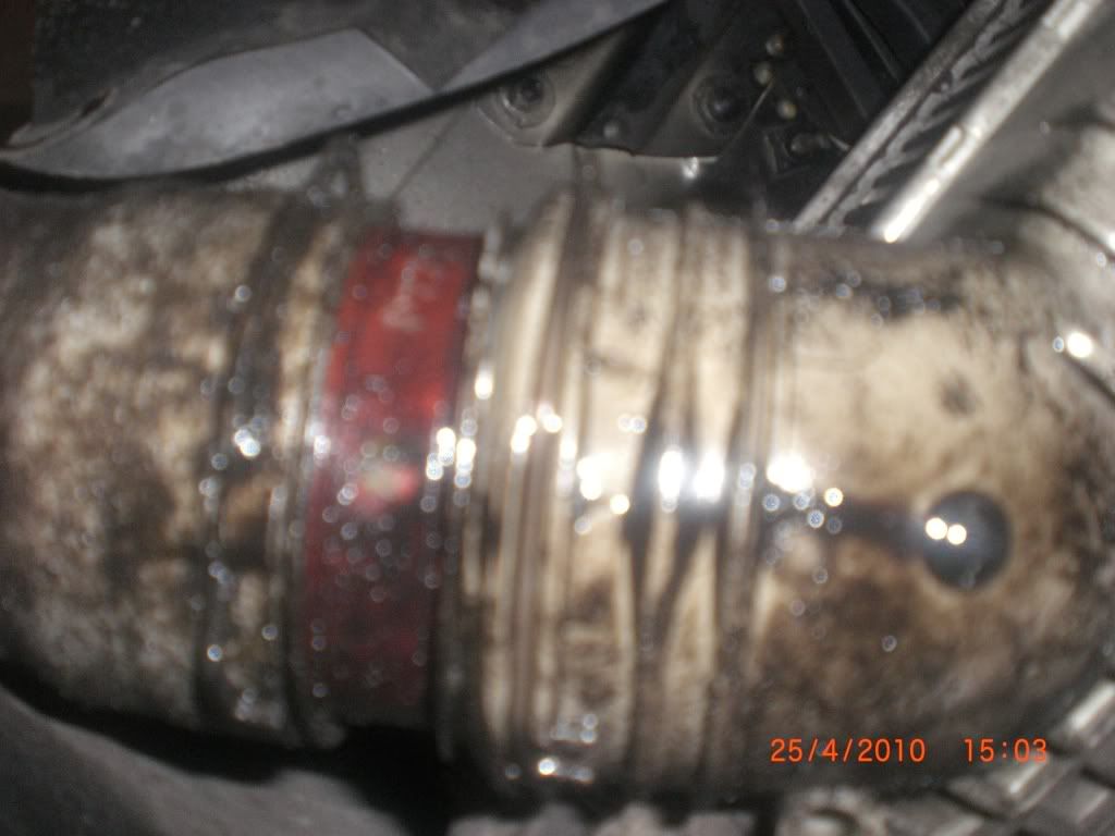

Right so I was under the car today, trying to sort out the plastic undertray and I thought i'd have a look at the red turbo pipe behind the front bumper on the drivers side.
It's looks a right mess with what looks like oil on it, tried to see if it was loose and coming away but seems pretty firm in place, anyhow you guys will know more than me looking at the folling pic, let me know if it looks ok or is there something to be worries about?

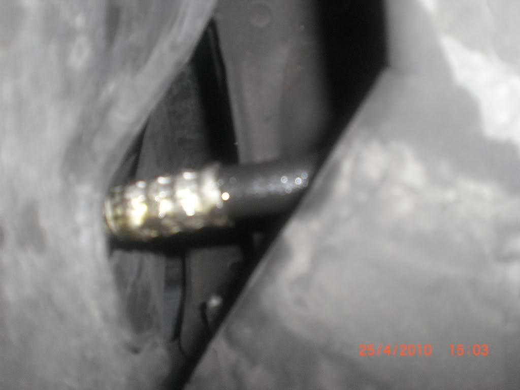

Also whilst looking at this pipe I noticed this other metal pipe that also had oil on it.

it could be at some point that the pipe has come off and blown oil over it or it could be a leak from the intercooler side of the pancake pipe
I'd wash off as much as you can and monitor it over the next couple of weeks
If the oil returns then its possible you have a small boost leak in that area - might be as simple as a perished o-ring

It's feeling like i'm getting closer to my MPG problem fingers crossed.
I've cleaned it up and will check again after work today and over the next week or so, see what happens as when i looked at the pipe the oil looked quite fresh and in some places it was built up ready to drop off like rain on a window sill.

Yep - most common problem is the lugs were away and or the o-ring inside persishes.  Also the clips stretch allowing for movement
Might be worth renewing the clips and o-rings whilst you got it apart - save doing the job twice  :smiley:  Should be nor more than a few quid from the dealers for them  :smiley:
