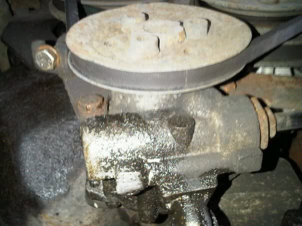

Had a day off today so thought id try and tackle my bloody power steering!
First things first had to go to Halfords to buy a trolley jack and some axle stands as i haven't got any which kind of prevents me from doing any kind of work on the car! Lucky I found my Halfords trade card  :cool: so saved some money on that and while i was there picked up some new PAS Fluid
Drained the fluid out and well it didn't look to healthy!
topped it all up and bled the system, now when on full lock the car still squeaks to hell so had a look and see what i could see,
So had a little go at the bolts holding the pas pump in place but they we seized solid! the tension on the actual belt seem a bit slack so tightened the tension bolt a bit got the car down and took it for a spin, needless to say didn't make feck all difference! Jacked the car back up and then realized there was a small bolt behind the the tension arm so loosened this a bit then tightened the tension bolt then re tightened the bolt
Take 2, although it still squeaks at least i have made some improvement i don't have to fight the steering wheel so much when stationary!
still need to fit the spare pump i have but will leave that for another day

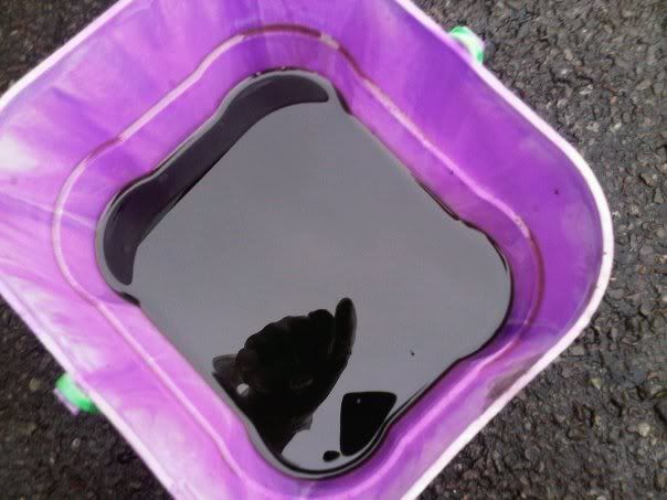

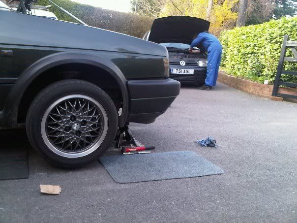

So today finally got round to doing the long awaited oil change!!!
nice black oil!!
Drained all the nasty oil out and after some advice from Danny P we flushed the engine with some 20/50 mineral oil which did the trick really helped get the crap out and eventually it ran clear. replaced the sump plug and oil filter as well
then filler her up with the good stuff

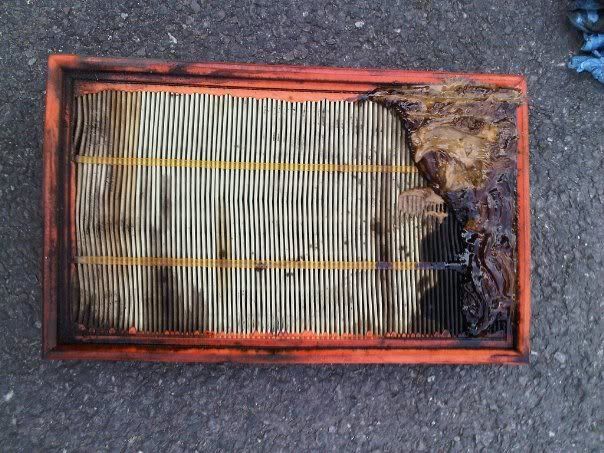

now as we were doing this my mate was checking his air filter on his golf and I thought might be a good idea to check mine, and well glad i did when I opened the airbox was presented with this!!!
I felt sick seeing this! Guess thats what happens when the last service was in 2007!! although it was garaged for 2 years, or so i was told, anyway my mate drove me up to the local autoparts shop and got a replacement filter.
The biggest ball ache was  I tried to start the car and it didnt! but a quick call to Chuff and discovered I had Knocked off one of the vacuum hoses! bit of a school boy error but all running and all good!
