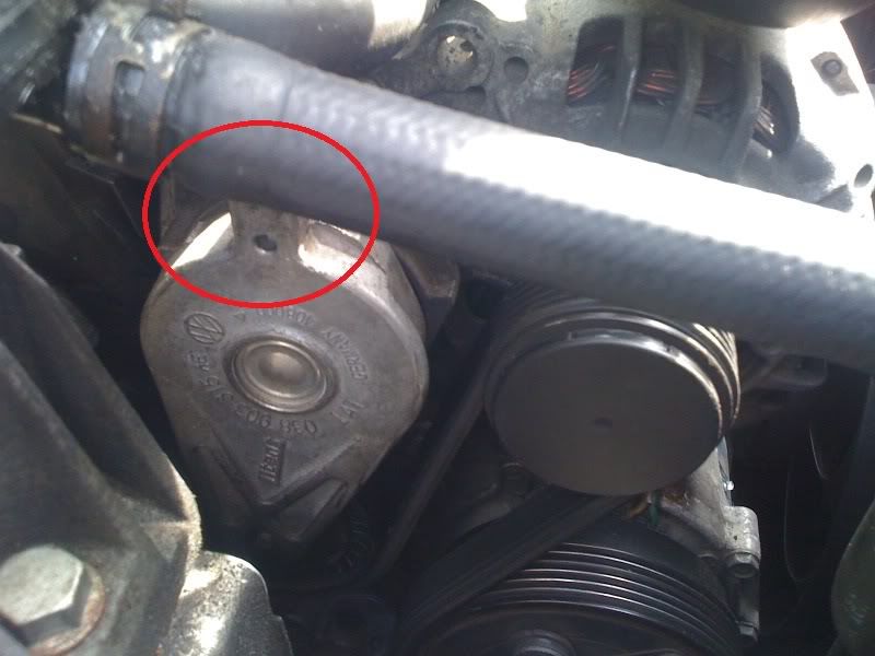

Right had a crack at this today, left the car looking like this as cant for the life of me work out how to get the tension off the tensioner. Any ideas people, there is mention of screwing a bolt in but my tensioner does not appears to have an option to do this ??

use a adjustable spanner and put it on the section Ive circled, then pull it forward and put a 4/5mm bolt through the hole. be careful and dont let the spanner slip!! its a bit more awkward getting the bolt out as it will bend

Hmmmm I did try that but it seemed like it needed a hell of a lot of pressure to pull it back. Will have another go, thanks matey ;).

it is a tensioner :wink: use a bigger spanner. also its easier if you have someone help you

Right managed to get the belt off by using a large screwdriver. Pushed it passed the belt at the further point of the tensioner I could and pushed forward. Managed the push it enough to get the belt off yay. Just for your ref Steve there is absolutely no chance from what I can see of using that bit circled and pulling back.

It can be done as I have had the belt off a few times and have done it the way I said :wink:
