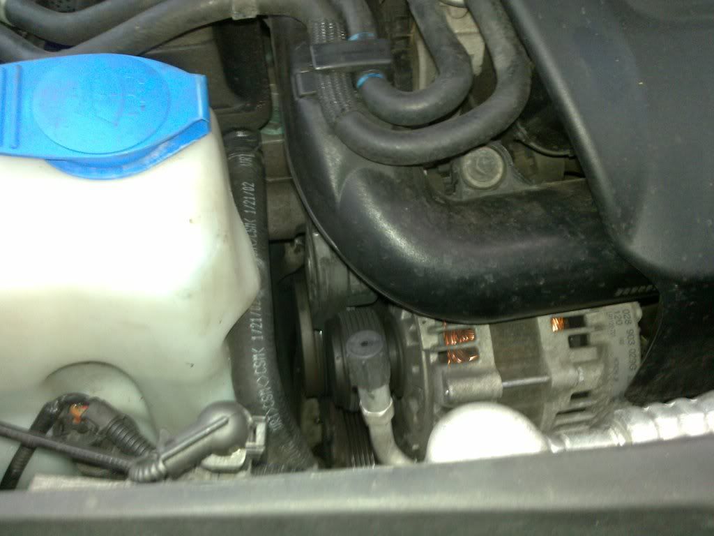

It's defo common.
Yes, that's just a cap on the alt pulley, you get a new one with the new pulley.
Taken from another forum http://www.fordgalaxy.org.uk/ford/index.php?showtopic=19519
Quote
You take the tension off the belt with a lot of difficulty! If you look on the visable side of the tensioner you'll see a square hole - the official way is to use a special tool to locate in there and then lift up - if you dont have that tool then it can be done with a large allen key - when I did it I used a socket to wedge in underneath to keep the tension off but give it respect as it'll take your finger off if the socket slips out.
The actual process is very easy but the tension its under makes it difficult!
Quote
There is a square shaped lug on the tensioner, onto which you can put an adjustable spanner. Pull the lug to release the tension on the belt. You will then see that a small hole in the tensioner (near the lug) allows you to put a piece of welding rod through to keep the tension off the belt while you remove it.

Did you get round to doing this today ? Looks fairly simple I think, although I would say the washer bottle needs to come out of the tool wont fit in.

Didn't get a chance yesterday  :sad:
I won't need to remove my washer bottle :tongue: It's on the otherside.... But I'll have to move the intake sh!z  :sad:

might be on your car  :rolleyes: alternator is next to the washer bottle on mk4's :tongue:

I'd rather remove the washer bottle than all the intake stuff  :sad:
Makes me look forward to the guide even more  :laugh:
