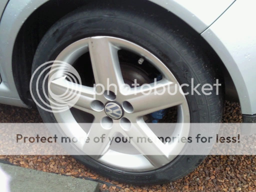

fitted my hubcentric spacers earlyer and now theres a grinding noice comning from the rear,  bolts to long? or what?

found out what the probblem was, wasnt bolts grinding, the screw that holds the disc in place had snapped and made the wheel have play so everytime it moved round it was knocking. anyone had this problem using spacers as both sides had snapped?
