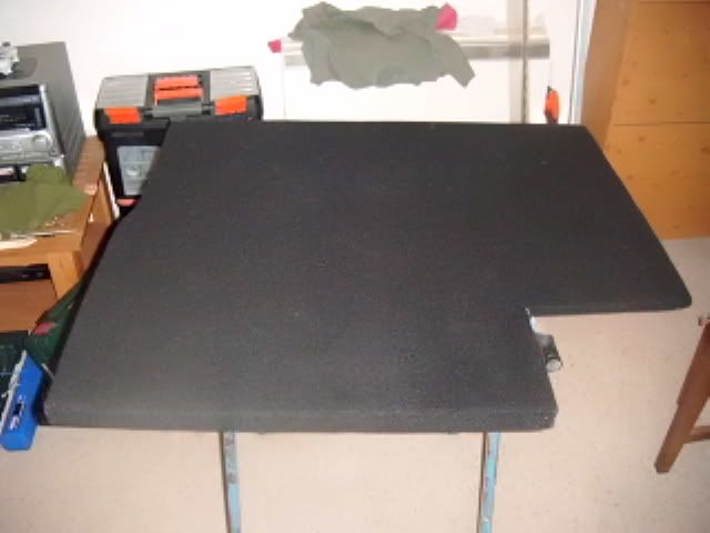

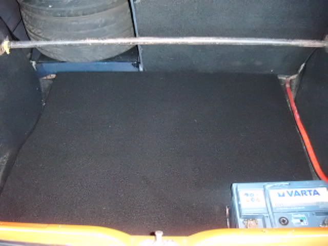

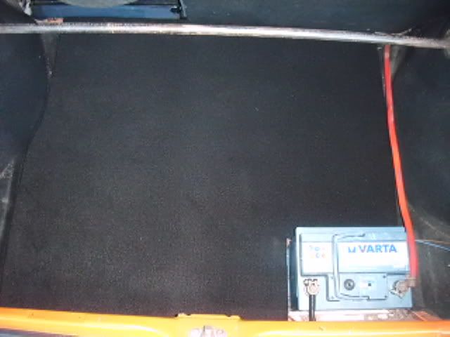

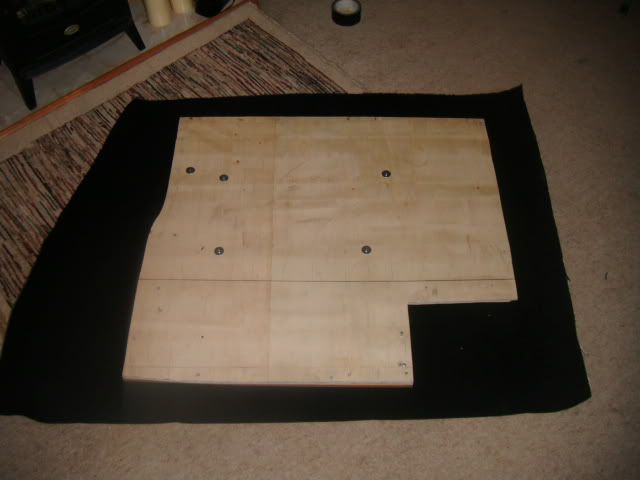

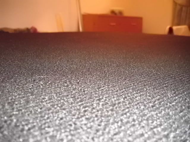

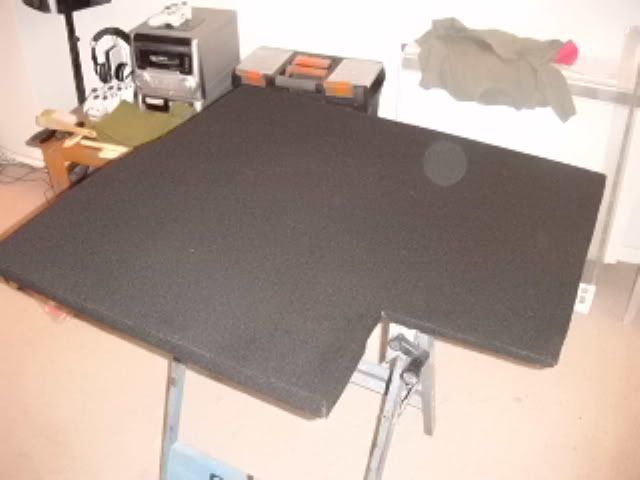

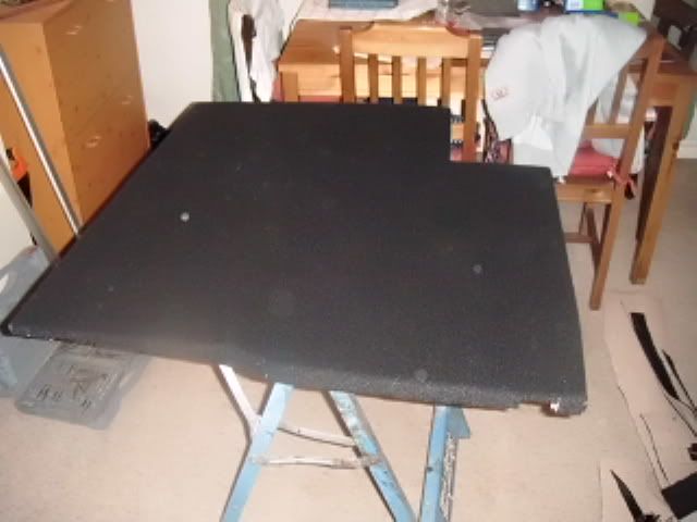

I finally finished a false boot floor, made from plywood (strengthened across the centre and batons of various lengths around the edge to level it out - the G2 boot floors are not level, theres a bulge on the O/S). Its been carpeted with some nice black foam backed stuff, which i found in the garage.  :smiley: Its nice and light, but strong, and should help reduce the noise in the cabin especially if i whack some dynamat on the underside (which I have a spare half roll of), although it wont be quite so light then  :grin:
The rectangular cut-out fits around the battery, and the front edge which fits against the rear seat is deliberately not tapered back around the arches as then I can remove the floor easily when necessary.
The inner arch carpets need a hoover but you get the idea. I'm on the lookout for a cheap black battery cover/lid, just to tidy that up. I could also do with hiding the main +ve cable too  :undecided:

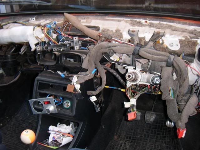

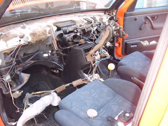

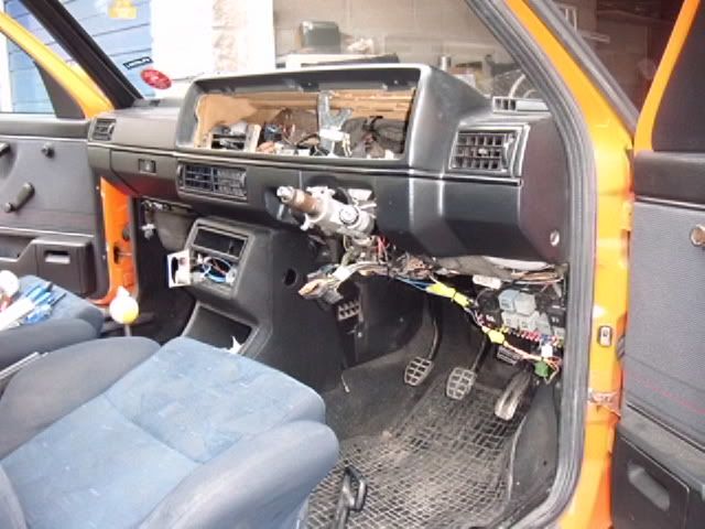

In other news, today I took the dash out, took just over 2 hours (which for my first time i didnt think was too bad)
In the process I found an old micro SD card under the dashboard, left behind by Ben; sorry guys no juicey pics, just lots of photos of the car being painted  :cool:
Plans are to tidy the wiring especially fusebox end, replace the heater matrix, move the start button/fuel pump switch and replace the centre console. If funds allow maybe have the dashboard flocked but I'm undecided...
PICCIES!

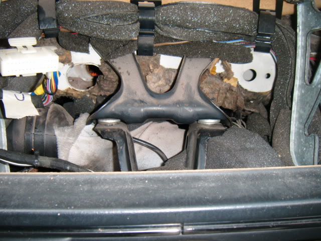

What horrors await?!?!?

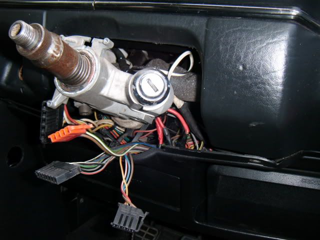

No wonder the steering wheel sits low, i thought it was spacer'd. This might be returned to stock height:

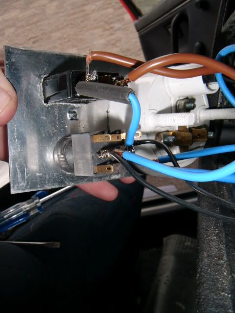

Start button and fuel pump switch to be relocated:
