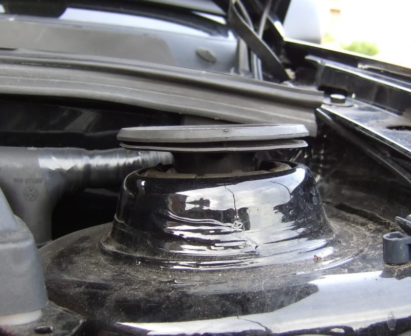

ok changed the top mount today.
managed to change it without removing the bottom from the hub bit.
i was right the bloke that fitted the coilovers put the bearing in upside down and didnt use a nut to compress the coil as nut was missing.
bearing had ripped itself to bits.
so now its all good and feels alot better.
have noticed the other side seems to be ok with the bearing in right but it just has the coil compression nut missing.
so in theory i should be able to just remove the top nut and metal plate under bonnet and put the coil compression nut on from there and just do up tight.
does that sound like it will work?

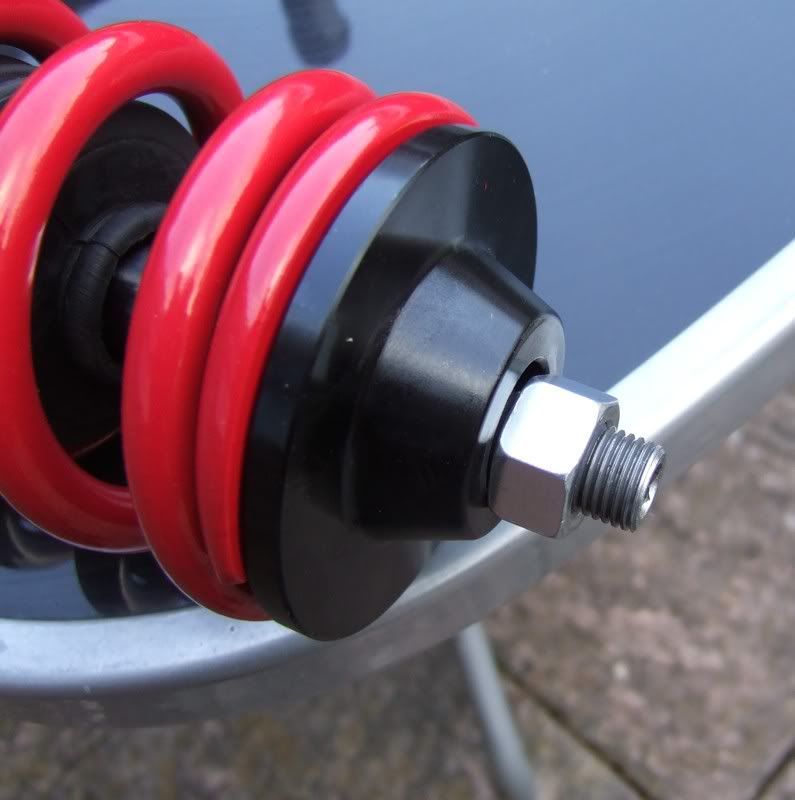

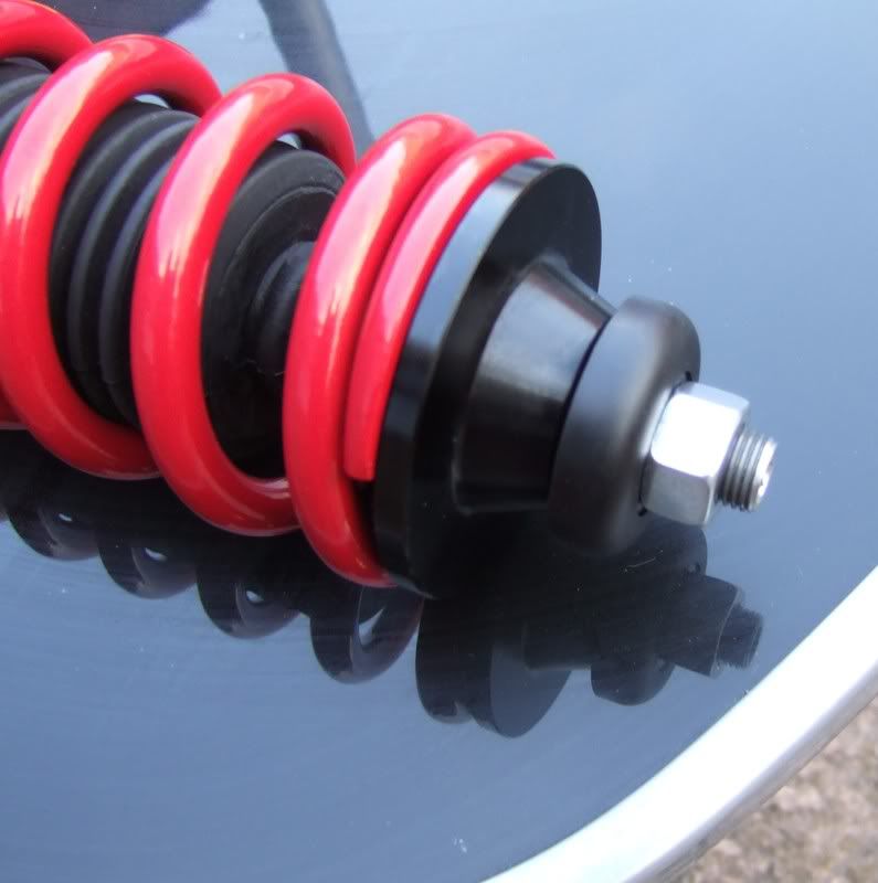

Seems to be 2 different ways of putting them together.
When I did mine I found the the nut was nearly the same size as the hole in the spring plate, as below.
So I then fitted the bearing underneath the nut as below.
Only issue then is that the top plate would not sit down flush but I never had any problems.

i thought the bearing went under the coil compression nut anyway?
« Last Edit: 17 January 2010, 00:15 by stainesy »
Re: top mount fitment (mk3 golf)
« Reply #24 on: 17 January 2010, 00:10 »
To me yes it should, I was told after that it should go on top the nut.
on top of the nut? that dont make sence?

the nut i got from vw parts witch is the right nut for it is alot thinner than that nut and it has a slite dome on the bottom to sit on the bearing properly
