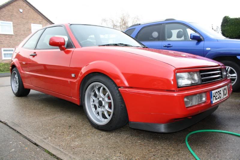

yes i was thinking this but fuel pressure on tick over is good but dont know under load ?
does any one know if the intank pump is the same as a mk2 8v or would it have to be a 16v
also sorry m8 i didnt see ur request for a picy so here it is
still got the mk2s tho lol
