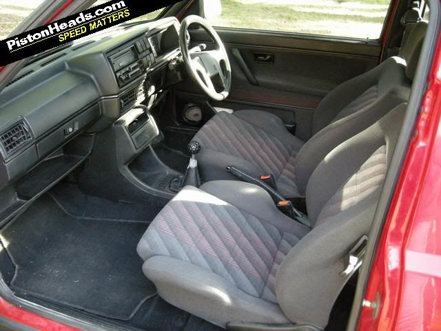

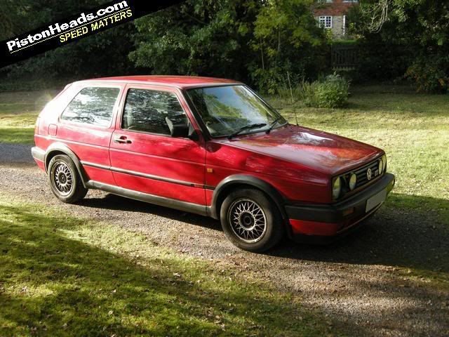

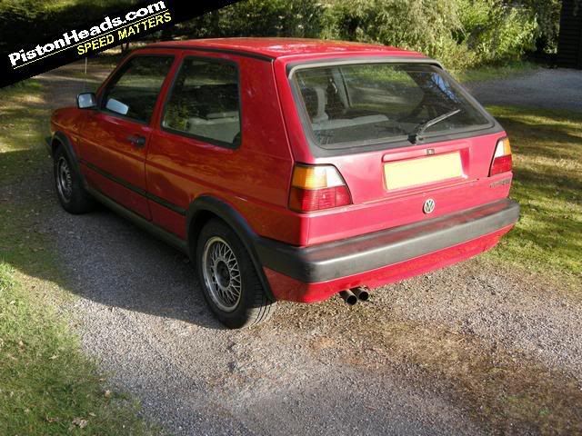

Picked up my new car yesterday - so far i'm really enjoying it. it's very different from what i'm use to having only driven Honda's mainly.
It's a 1991 GTi 8v in Tornado Red. Pretty good condition for its age and almost everything is working as it should.
Here's a few pics from the sale ad:
